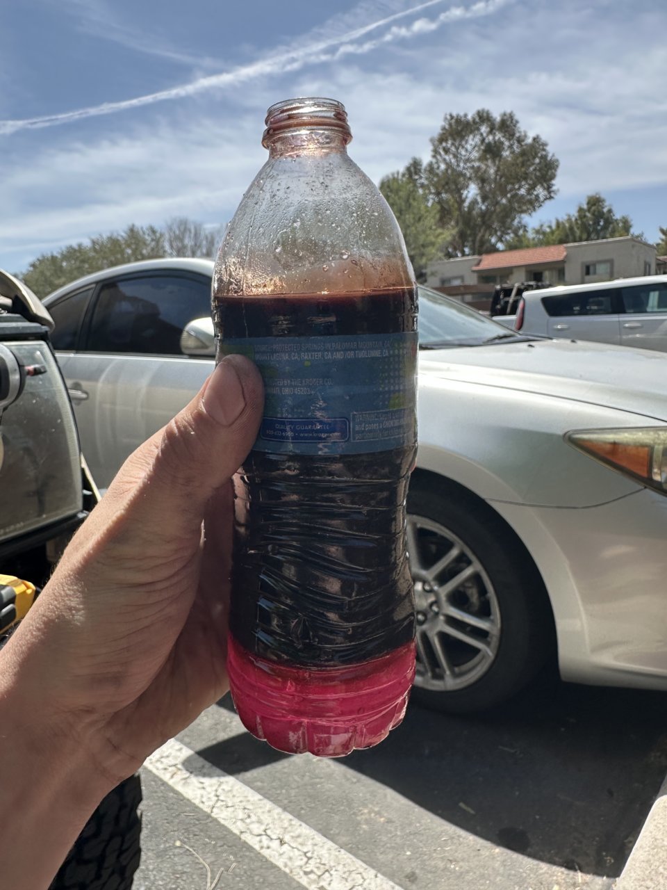

    Should I top off the trans? Thais came out Of the trans line… ignore the coolant, it was excess out of another line44927FF5-9589-4A80-899C-7D2F20854CB4.jpg

    Drain and fill.
    Easy enough.

    You think I can make it till the weekend with how much I lost?
    It does need to be replaced from the looks of the color

    Well my suggestion to drain and fill was because of the condition of the fluid.
    When you asked if you should just top it off, I assumed you meant if you should simply top it off and leave it as is.
    Top it off as needed, and drain and fill when you can.

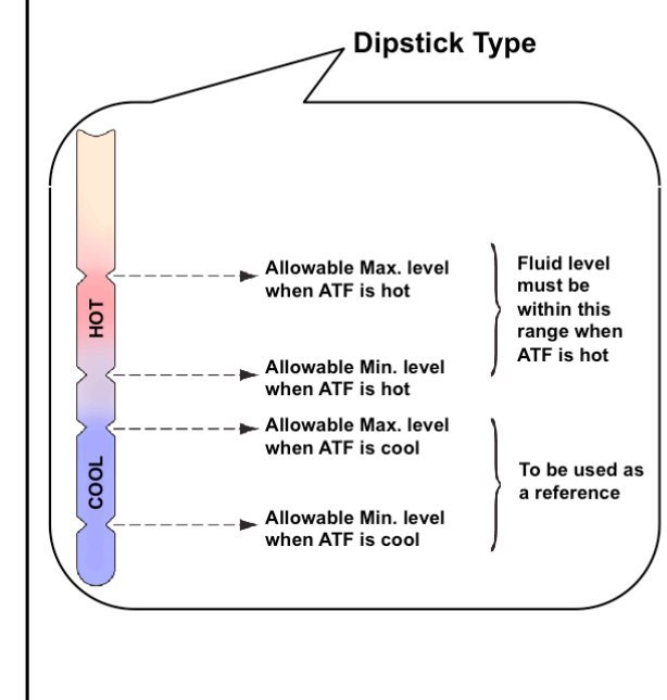

    Just top it off until you can drain/fill.
    Get it up to operating temp and with the engine running pull the dipstick. If it's not within the hot range, add a little at a time - do not over fill.
