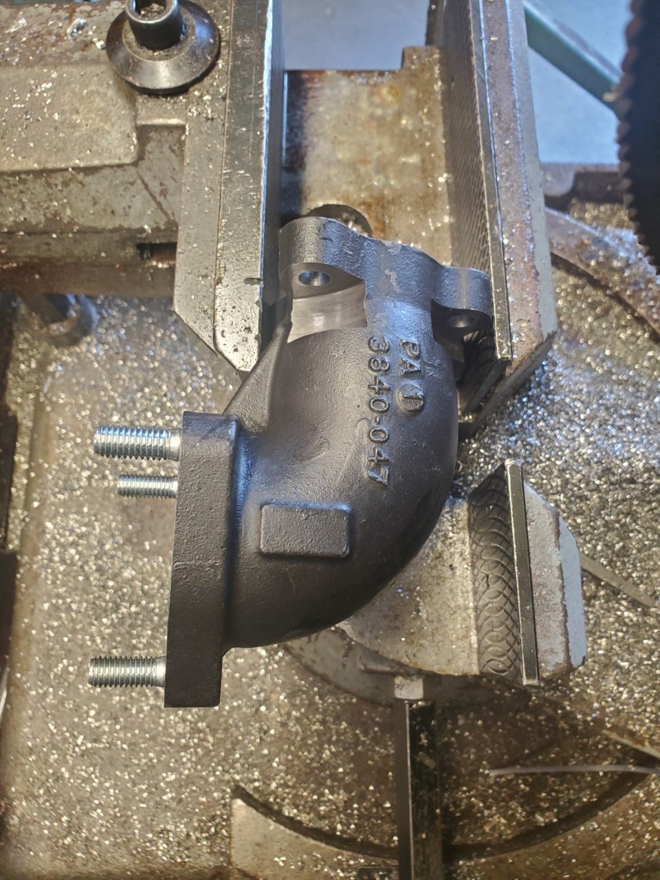

    @Kwikvette here's some horrendous welding for you
    This is how the exhaust manifold (exit port?) Came stock on the engineScreenshot_20230420-092200_Gallery.jpg

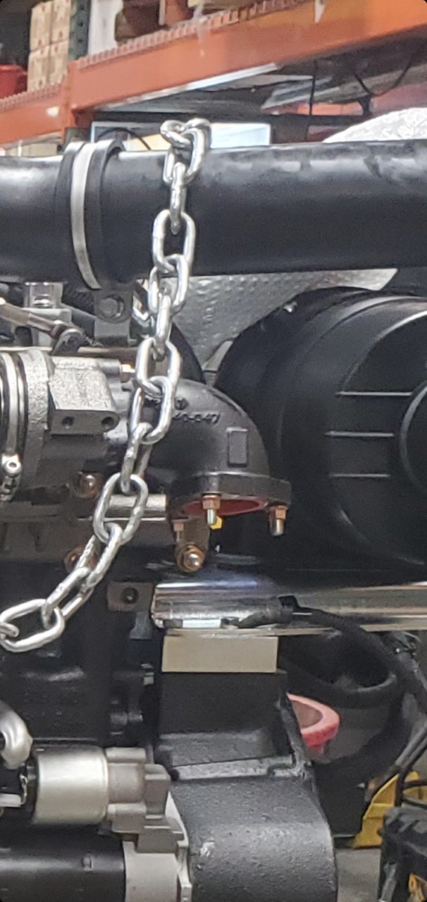

    Well there's not enough room in the shroudwork for the muffler to hang down, so I had to cut it up and resend it.

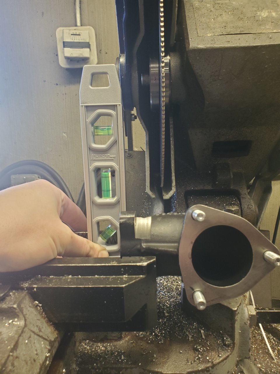

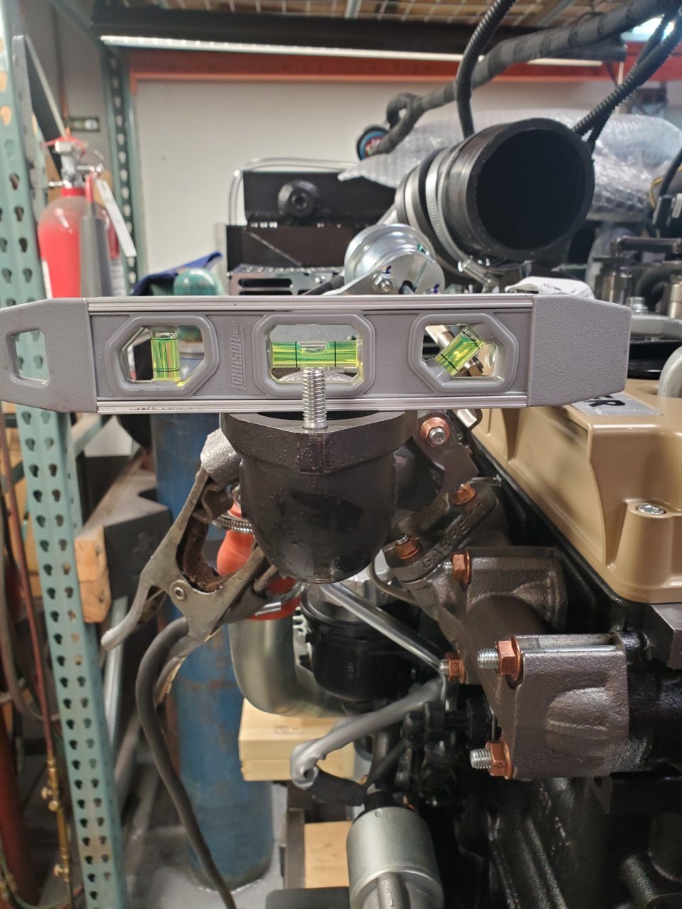

    Flipping it 180 and checking to make sure it's level with the engine20230420_073551.jpg

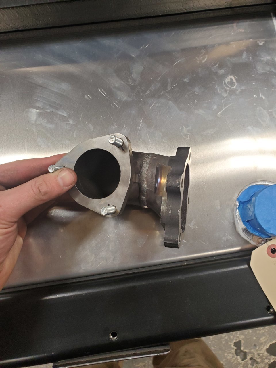

    Welding cast iron is fucking rough :( preheated the shit out of both sides and the bead still came out stupid cold:bananadead:20230420_091929.jpg
    But bossman is happy with it and said he couldn't do better so :notsure:

    Last one I did just came in for a filter change. It's got 672hrs on it and isn't broken yet... although I was positive it would given the porosity :anonymous:

    That's a good looking weld honestly, especially for cast.
    I fucking hated cast and would do what I can to get a good preheat using oxyfuel.
    I miss oxyfuel...
