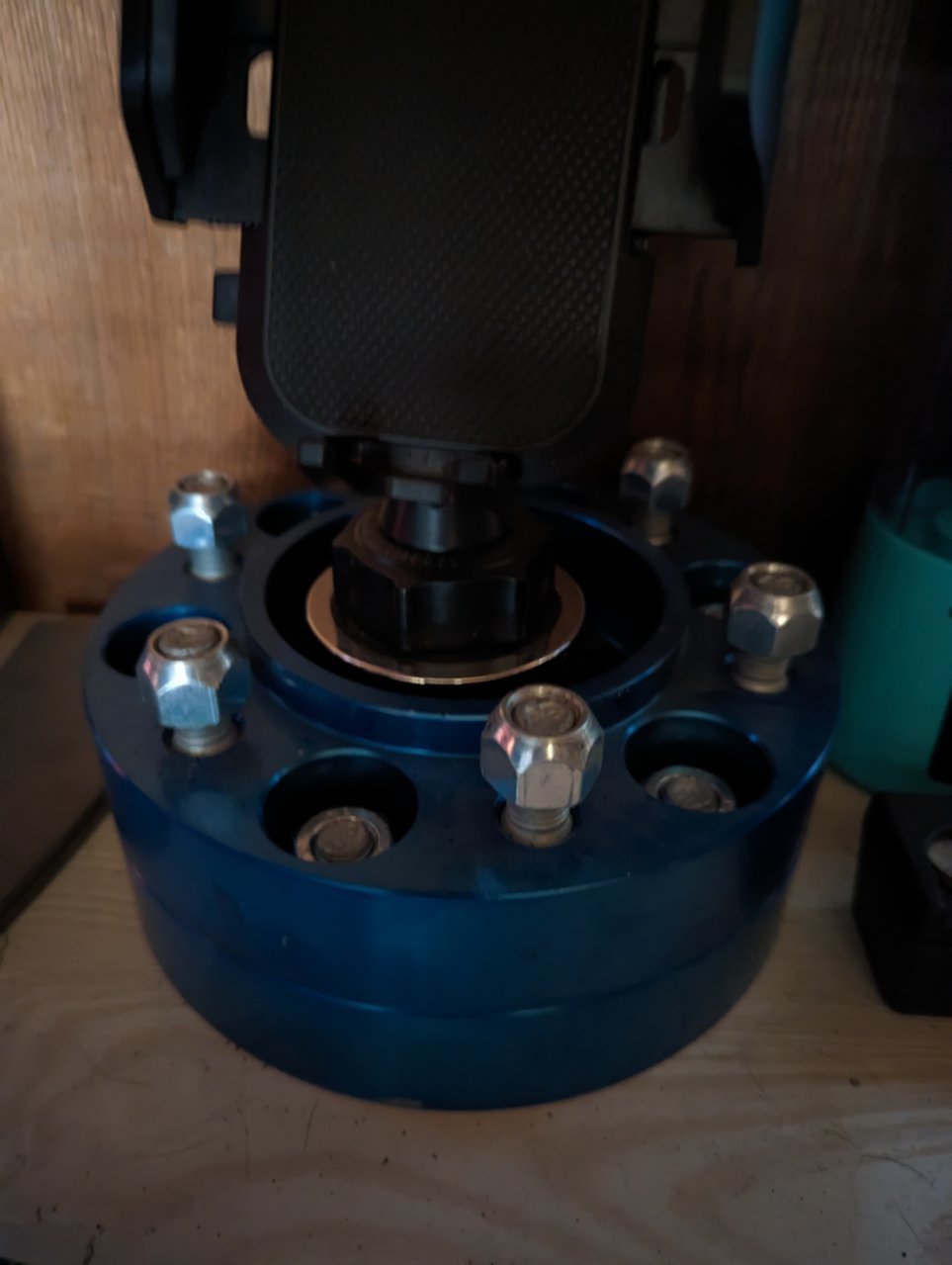

    I'm running a set on my 2nd gen with FJ trail team wheels and have had no issues. Even have a set for the 1st gen (thanks @Kwikvette ) when I do the outboard shock relocation.
    Just don't cheep out on them get good spacers.

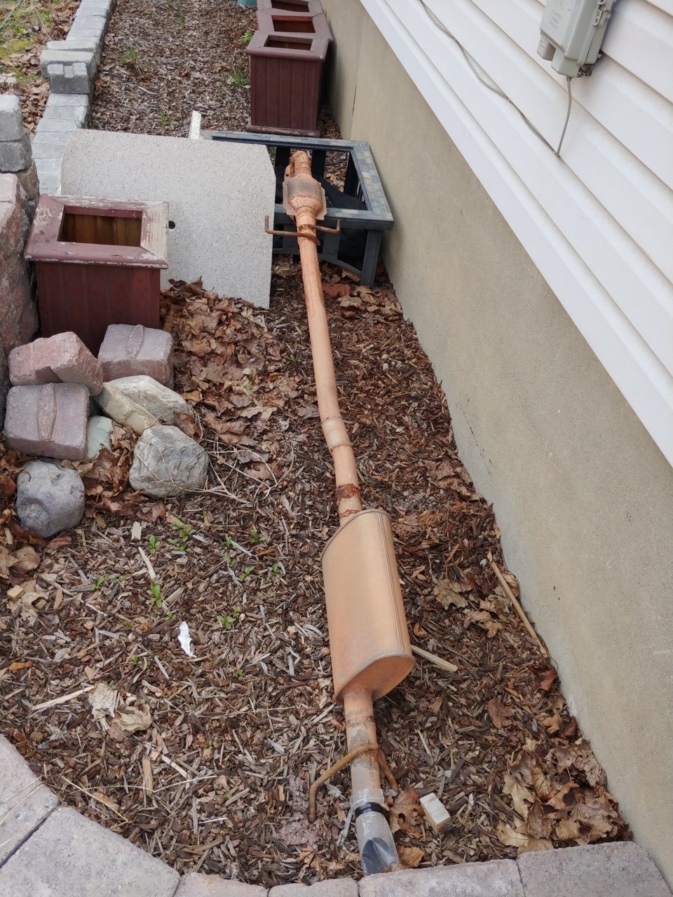

    @Speedytech7 @Kwikvette what are the chances I unwelded a baffle inside my turbo muffler? I still occasionally have a nasty exhaust rattle when I downshift at high rpms and y'all probably most likely to have done it on a car lol

    It's less Tacoma and more mod
    Those things are always tack welded internally so even if you flex the truck too much or the exhaust got caught on something at one point it could snap one of the baffles off internally. It's probably pretty likely

    I guess for $30-40 bucks it wouldn't hurt to slap a new one one and see. I know it's more common on chambered mufflers but given all the cheap aftermarket shit and abuse it's been through the last several years it wouldn't be a huge surprise it broke lol

    Cut it off, but like Zane said it's most likely just tacked.
    Nothing ever really gets fully welded and that's for a ton of shit IE fixtures, brackets, etc on all sorts of stuff

    I might just cut off the muffler and see if the rattle goes away. If not I suppose it was time to try a different exhaust setup anyways. Not sure my neighbors will love me in the short term tho :p
