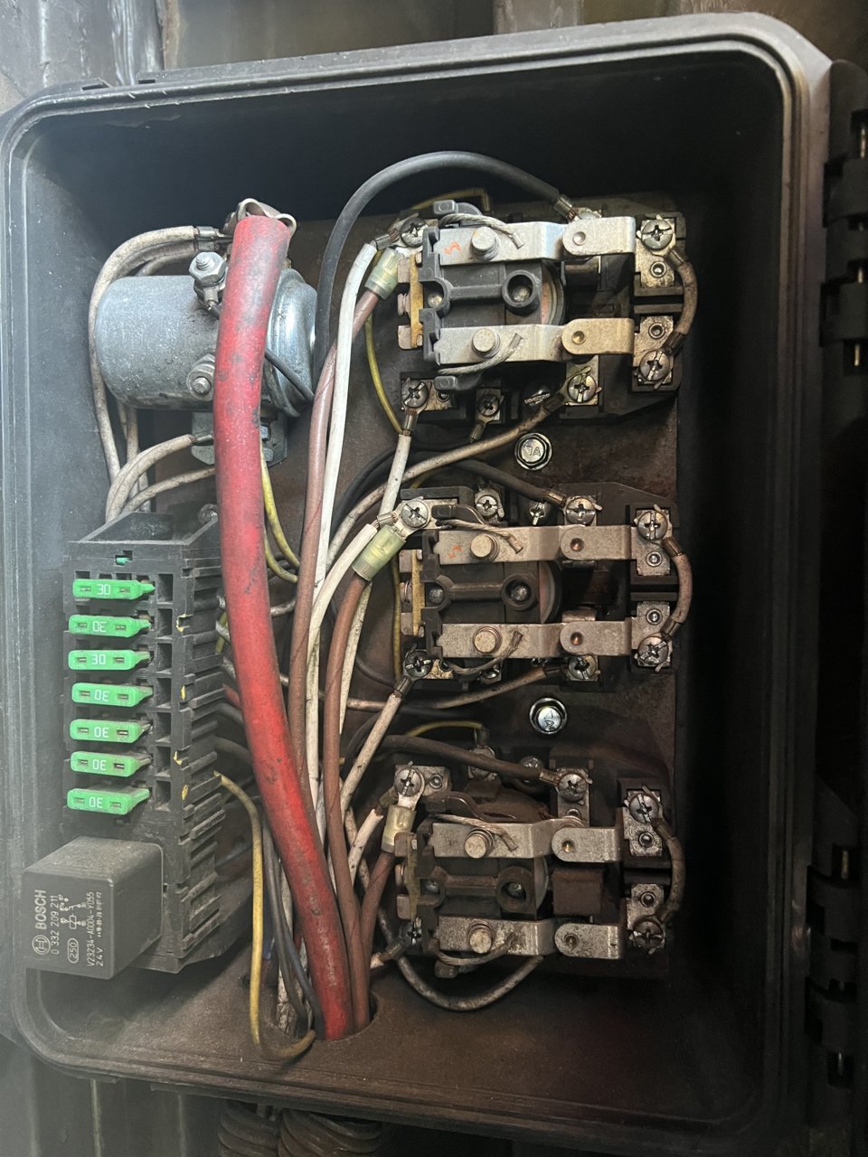

    We use the 12v version of that on 2 pieces of our equipment. They don't like being left on. When I first started years ago, we had the fan turn on when the keyswitch was on, run em non stop. They'd get warrantied like mad, only lasting an avg of 500hrs before the fan burned up. Ive used the 24v version on my 480V unit but ive never had to warranty one of those fans. All Those SPALs have a huge inrush current. An easy 3x amp draw, so contactors would be a better solution if you're sticking with electrical.
    Honestly, I'd drive to fab up a hydraulic solution. You mention the pumps were discontinued, but is the anyway to sub the pump out? Or change location and have it belt driven? I've experienced way better cooling and fewer faults with hydraulic setups

    IGBT based PWM controller?
    https://electronics.stackexchange.c...osfet-type-to-drive-a-100a-dc-motor-using-pwm

    I’m in 100% agreement that the hydraulic setup was better. They never failed and the Cummins ISX could push it with room to spare. Unfortunately the tour company we bought these buses from scrapped all the hydraulic stuff so we have nothing left.
    We’re basically stuck with the e-fans basically.

    @treyus30 This is a specific bus that uses what I believe to be contactors and hasn’t failed yet. I still think the fans run 100% at all times though.

    The other way you could go is a solid state controller - no contacts to burn up. No idea if this one is any good but it shows the concept:
    https://usradiator.com/product/ss-2-solid-state-fan-controller
    You might even be able to find some that have a soft start circuit.
    Edit: or perhaps just a solid state relay with a diode.
    actually - do the contractors have any kind of fly back diode? If not that might be killing them when the bus shuts off
