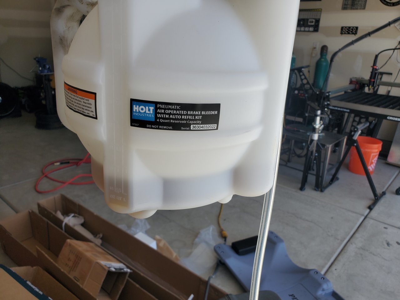

    As suspected, ECT good at 80-81.
    It's been idling awhile now, AC on too idling between 650 to 820 (when the compressor kicks on and off).
    Looks like new bleeder screws are in order.
    The Land Cruiser must've just hated sitting around for 3+ weeks.

    Tell you what though, I'll still recommend that HF bleeder.

    One rear leaked out fluid when undoing it (hence pulling old fluid, including the LSPV) but the other rear doesn't. I can just pull it off and clean it out but yeah I'll just replace them instead.
    We'll see if they're in stock at O'Reillys.
