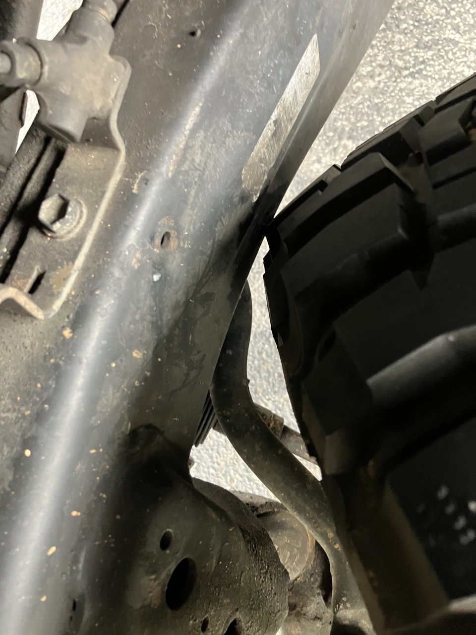

  1. May 12, 2023 at 11:41 AM
    Ozark_RegCab
    Ozark_RegCab Well-Known Member
    Jan 31, 2021
    #354648
    6,166
    Nick
    Northwest Arkansas
    1996 Tacoma SR5 4x4 5 speed
    Sliders, lift, 275/70/17
    I guess I’m gonna get to order those 0.75” spacers after all..
  2. May 12, 2023 at 11:43 AM
    eon_blue
    Mar 4, 2016
    #180213
    69,784
    Azusa, CA
    spacers might make the tire rub the pinch weld...but it's better to trim/beat back the pinch weld than it is to trim the frame I suppose
    the 255s I have on my Tacoma rub the frame too like that, but really only at full lock when flexing a bit, so I just let it happen. Once in awhile will spray some paint over the rubbed off section
    Ozark_RegCab[QUOTED] likes this.
  3. May 12, 2023 at 11:44 AM
    Wulf
    Wulf no brain just damage
    Jan 30, 2015
    #147523
    61,861
    rock raisin
    I'd rather rub on the frame then cut down the wheel studs to run .75" spacers lol
  4. May 12, 2023 at 11:45 AM
    eon_blue
    Mar 4, 2016
    #180213
    69,784
    Azusa, CA
    Yeah I bought a couple of those .25" spacers awhile back to try and space them away from the frame, but they took too much off the studs where the lugs were only grabbing like 4 threads. Felt a little risky lol
  5. May 12, 2023 at 11:46 AM
    Wulf
    Jan 30, 2015
    #147523
    61,861
    rock raisin
    they can't help but reveal themselves
  6. May 12, 2023 at 11:46 AM
    Ozark_RegCab
    Jan 31, 2021
    #354648
    6,166
    Nick
    Northwest Arkansas
    Ugh yea that sounds like a PITA!
  7. May 12, 2023 at 11:46 AM
    Ozark_RegCab
    Jan 31, 2021
    #354648
    6,166
    Nick
    Northwest Arkansas
    Maybe I should start a thread asking i I should cut the frame like on the 3rd gen section
  8. May 12, 2023 at 11:47 AM
    Ozark_RegCab
    Jan 31, 2021
    #354648
    6,166
    Nick
    Northwest Arkansas
    And yea it’s only at full lock turning left. It’d be easier to get some other wheels with better off set probably.
  9. May 12, 2023 at 11:47 AM
    eon_blue
    Mar 4, 2016
    #180213
    69,784
    Azusa, CA
    she doesn't mean literally cutting the studs, she means those types of spacers will make it so your studs are .75" shorter than they are now and you might only have a few threads left to thread the lugs onto. Not safe
    If you want to do spacers get the 1.25" ones or whatever the smallest kind is that have studs on them.
    or you can run those .75" ones if you replace your studs with longer ones
  10. May 12, 2023 at 11:49 AM
    Ozark_RegCab
    Jan 31, 2021
    #354648
    6,166
    Nick
    Northwest Arkansas
    Oh ok so that’s only a concern with the 0.75” spacers. I might as well go 1.25” or 1.5” anyway I guess

    Yea it’s only at full lock turning left
