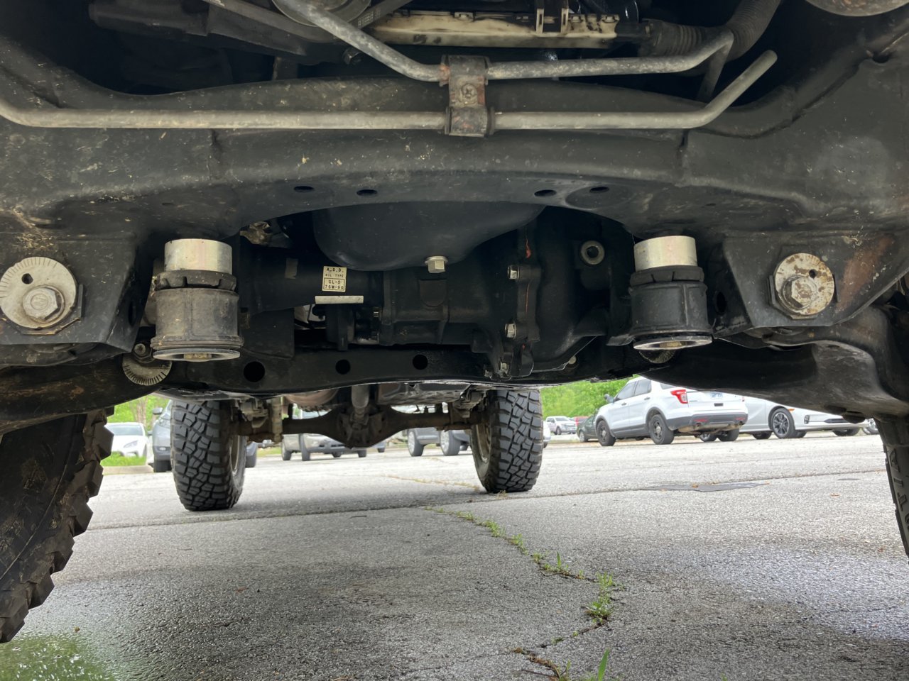

    Btw does anyone know what lift kit this is? Looks like a diff drop kit..

    that's just a diff drop, not a lift kit. Well it probably has a lift kit but can't tell what kind from that pic. Those spacers are diff drop spacers though....pretty much useless imo

    Oh yea it has Toyotec coils also which are supposed to give a 3” lift. Why do you say the diff drop is useless, does it do more harm than good? I thought they helped with the CV angles.

    I have the same diff drop spacers on my truck and it didn't change the angles at all for me, at least not noticeably. Definitely not enough to make a difference with my 3" lift at the time, which kept blowing my CV boots. I adjusted my Kings to about 2 - 2.5" which got rid of the boot rub
    and there is some thought that by pushing the diff down like that you wear out the bushings faster in the front diff mount

    all they really do is tilt the diff forward a bit, they don't actually "drop" it

    Interesting, I haven’t noticed any issues with my CV boots, but yea I’d be happier with a 1.5-2” lift tbh. I’m not sure if mine are adjustable though.

    It only rotates the diff, can help if you have vibrations. It doesn't drop the whole diff.

    They've always been useless.
