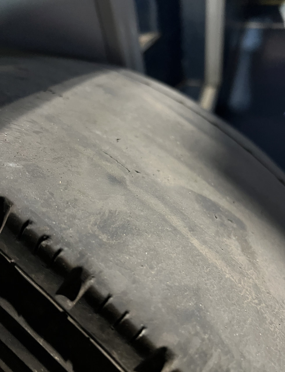

  18. May 15, 2023 at 12:38 PM
    BartMaster1234
    Aug 21, 2016
    #195197
    45,856
    Tyler
    Pittsburgh, Pennsylvania
    Flux Capacitor
    Saw this at the tire shop where we were dropping off some bus tires.
    Thems racing slicks!
