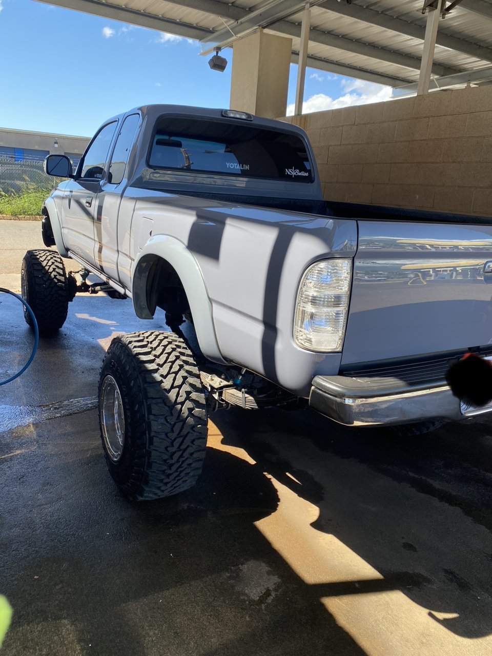

  3. May 25, 2023 at 7:48 AM

    I’m gearing up to sell my 5 lug soon then the goal is a 4 door 4wd 1st Gen as my daily. Just need to paint my truck and get it in sellable condition.

  18. May 25, 2023 at 8:32 AM

  19. May 25, 2023 at 8:35 AM

  20. May 25, 2023 at 8:38 AM

    it’s actually a Honda color. I forgot the name though
