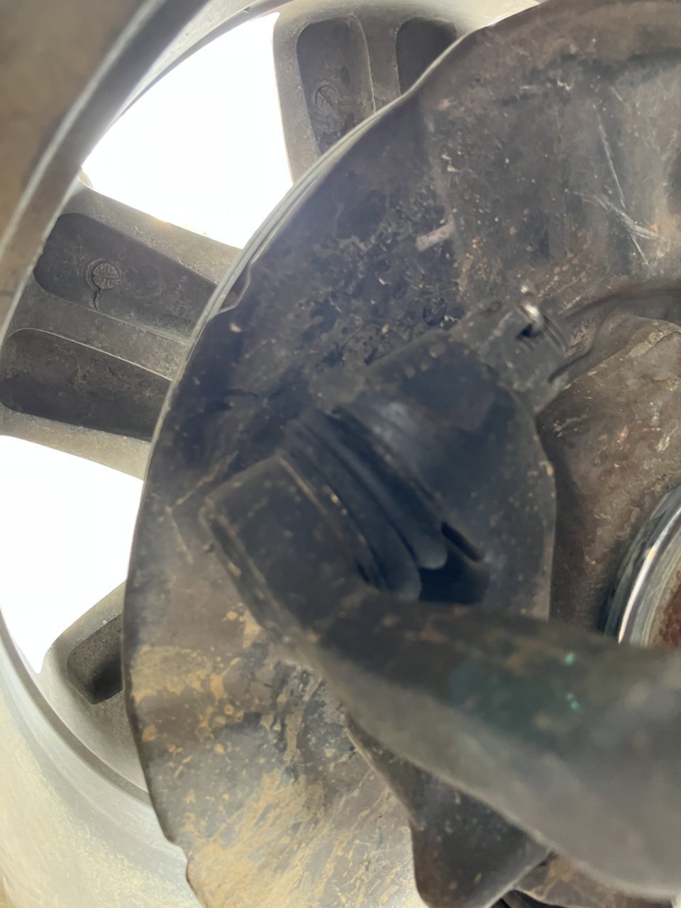

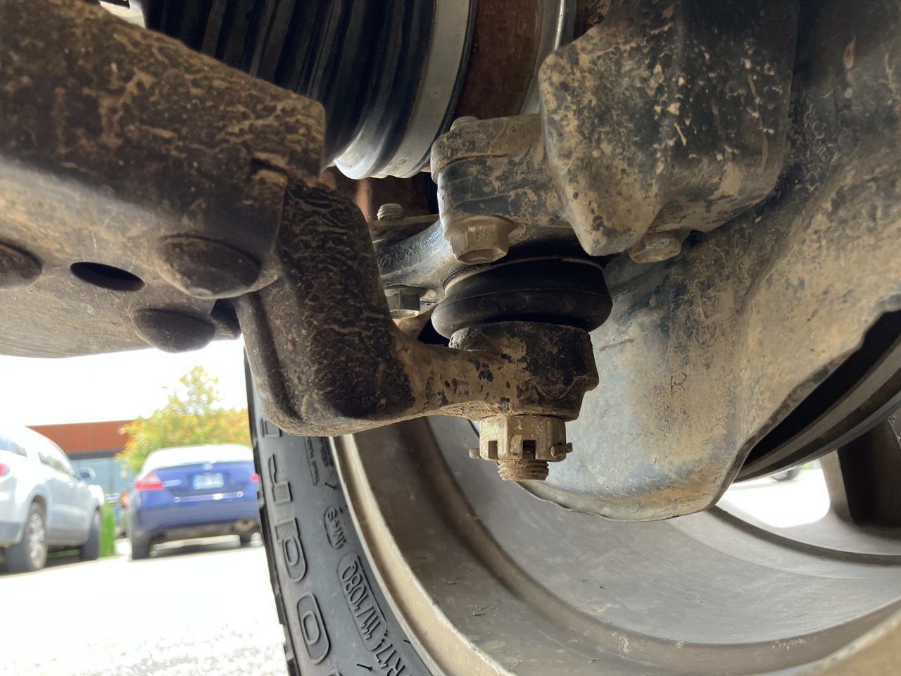

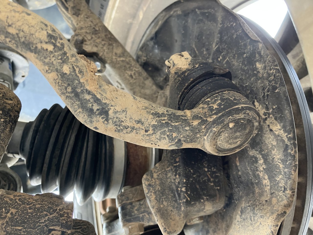

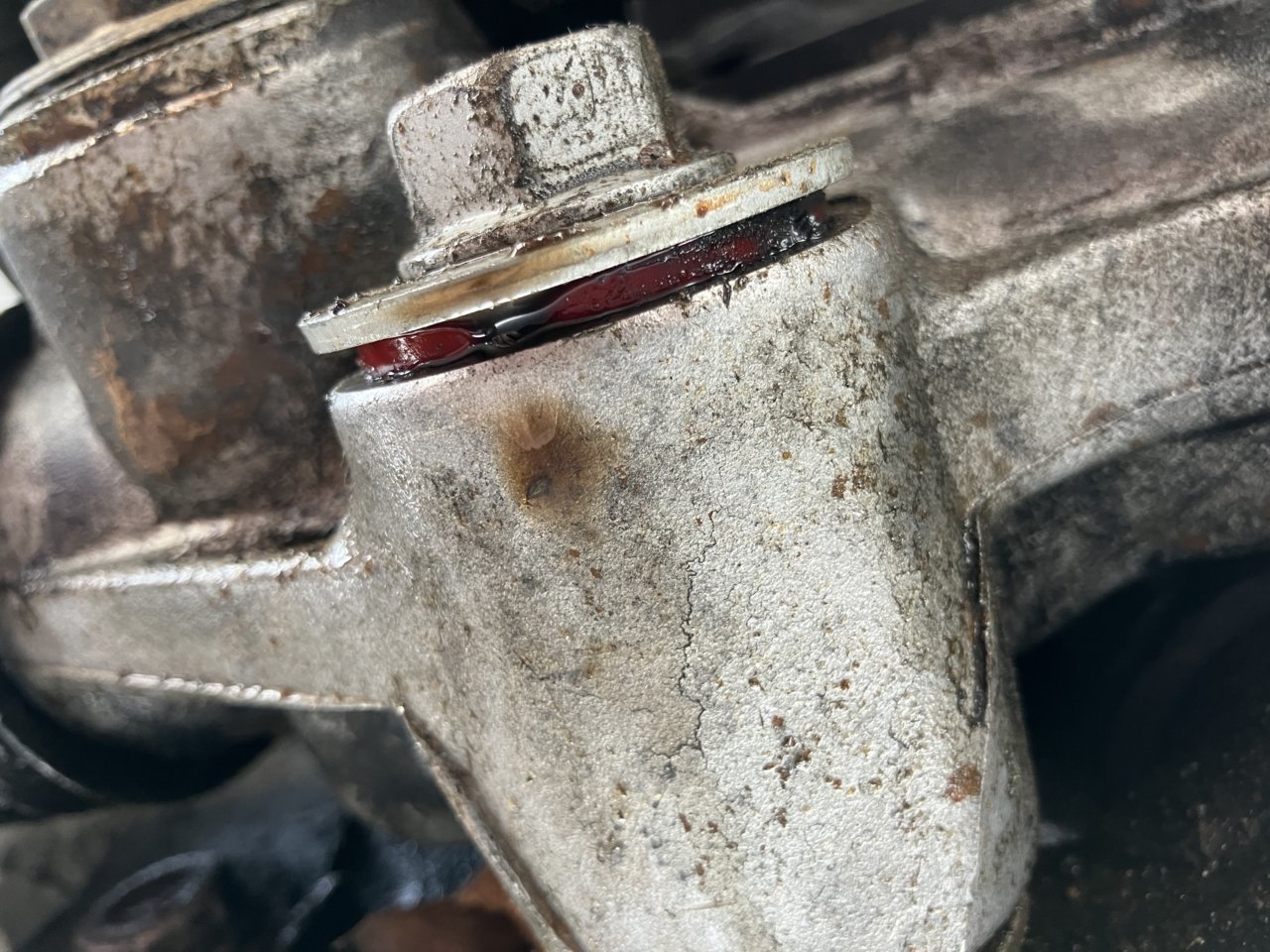

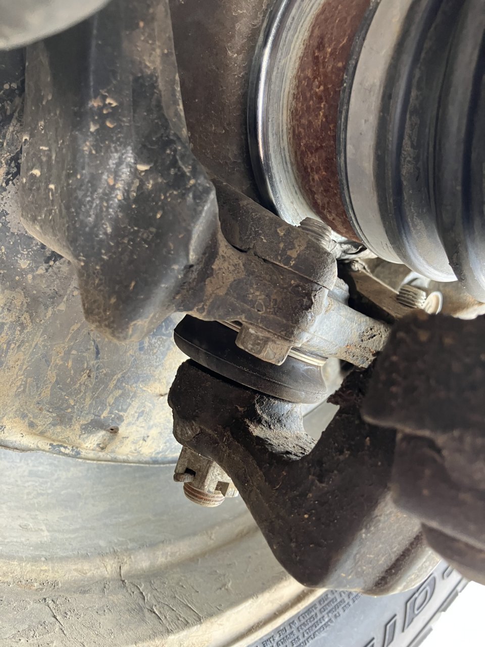

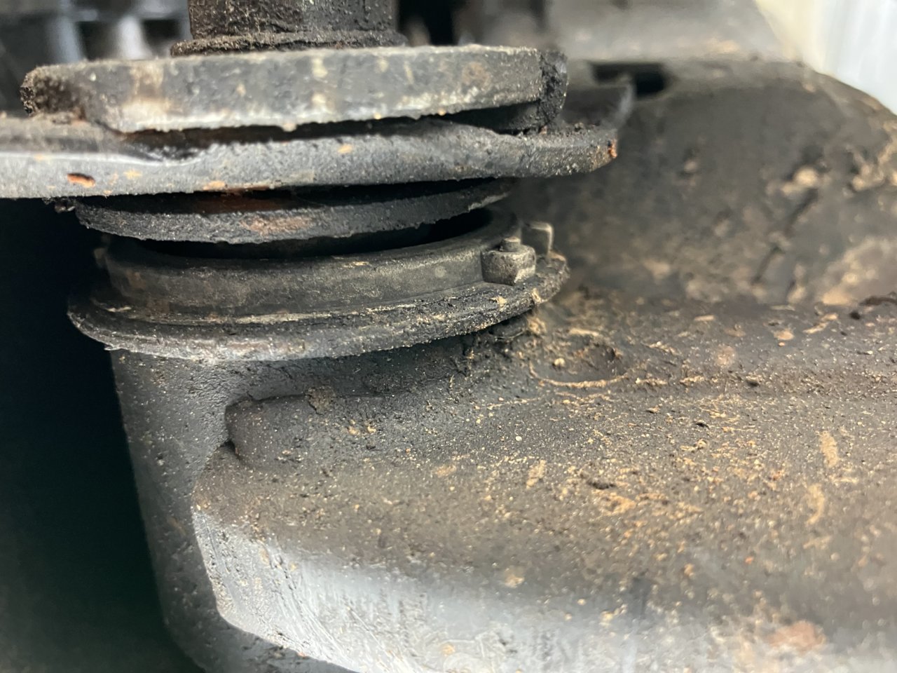

    @CS_AR @Abeyancer these are the pics i could get. Idk much about steering and suspension but if you see anything FUBAR let me know.
    IMG_0739.jpg IMG_0738.jpg IMG_0737.jpg IMG_0736.jpg IMG_0735.jpg IMG_0734.jpg

    Can you get someone to turn the wheel a little bit while you watch for any rack movement or loose joints?

    Looks good to me

    I can try that later. I think it’s just leaky, and the lift with stock UCAs is causing the sloppy steering like Zane said

    Wandering steering would have me looking at the LCA bushings as someone already mentioned.
    Don't start telling yourself your steering rack is going bad if you haven't diagnosed the simplest things yet.
    Your steering rack bushing looks good.

    I had wandering steering when I first got my Tacoma.
    Lifting it only made it more noticeable.
    Replaced my LCA bushings and it was nice and tight afterward; could drive on the highway with no hands on the wheel and it'd track nice and straight. Couldn't do that before with the bad bushings.

    I’d think the PO wouldve replaced them with the LBJs but I can ask

    Never make assumptions about work done; it's how you end up with bigger issues in the long run cause you neglected stuff you thought was replaced.
    LCA's to many are a pain in the ass, especially those that deal with rust.
    LBJ's are easily 10 times way easier and faster to do compared to LCA's.
