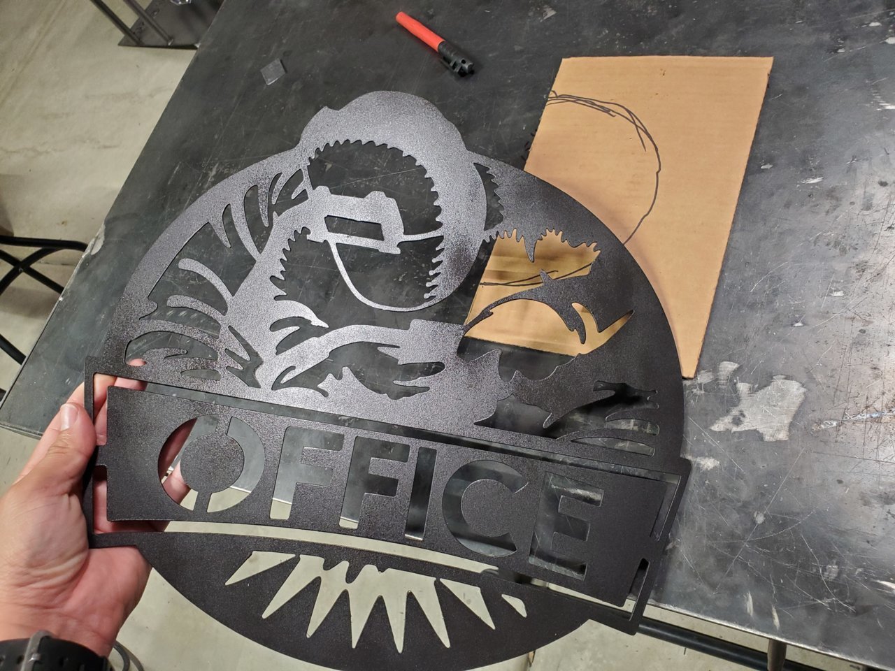

    Your cutter must do a lot better with smaller cuts then what I had access to in high school. Something like that wouldve warped up real bad. Even with telling the torch to skip around

    Not an issue at all, then again I don't cut thinner than 16 gauge.
    This sign is out of 16 gauge and had a lot of cutting close to each other (due to non-stop heat in close proximity)
    But as you can see, no issue at all
    The one thing I do have an issue with is beveling that's readily apparent in thicker metals; this is mostly because I need to loosen up the gantry tube and square everything up again

    Is your stuff submerged under water while cutting?

    That's a big reason why, shit I forgot :rofl:
    It's not but there's barely half an inch between the back of the work piece and the water level
    I do have a water table with plasma table fluid diluted with water for a 5:1 ratio; the air blasting through (even between cuts) ensures water is constantly hitting the work piece being cut

    Yeah ours wasnt cutting over water.
