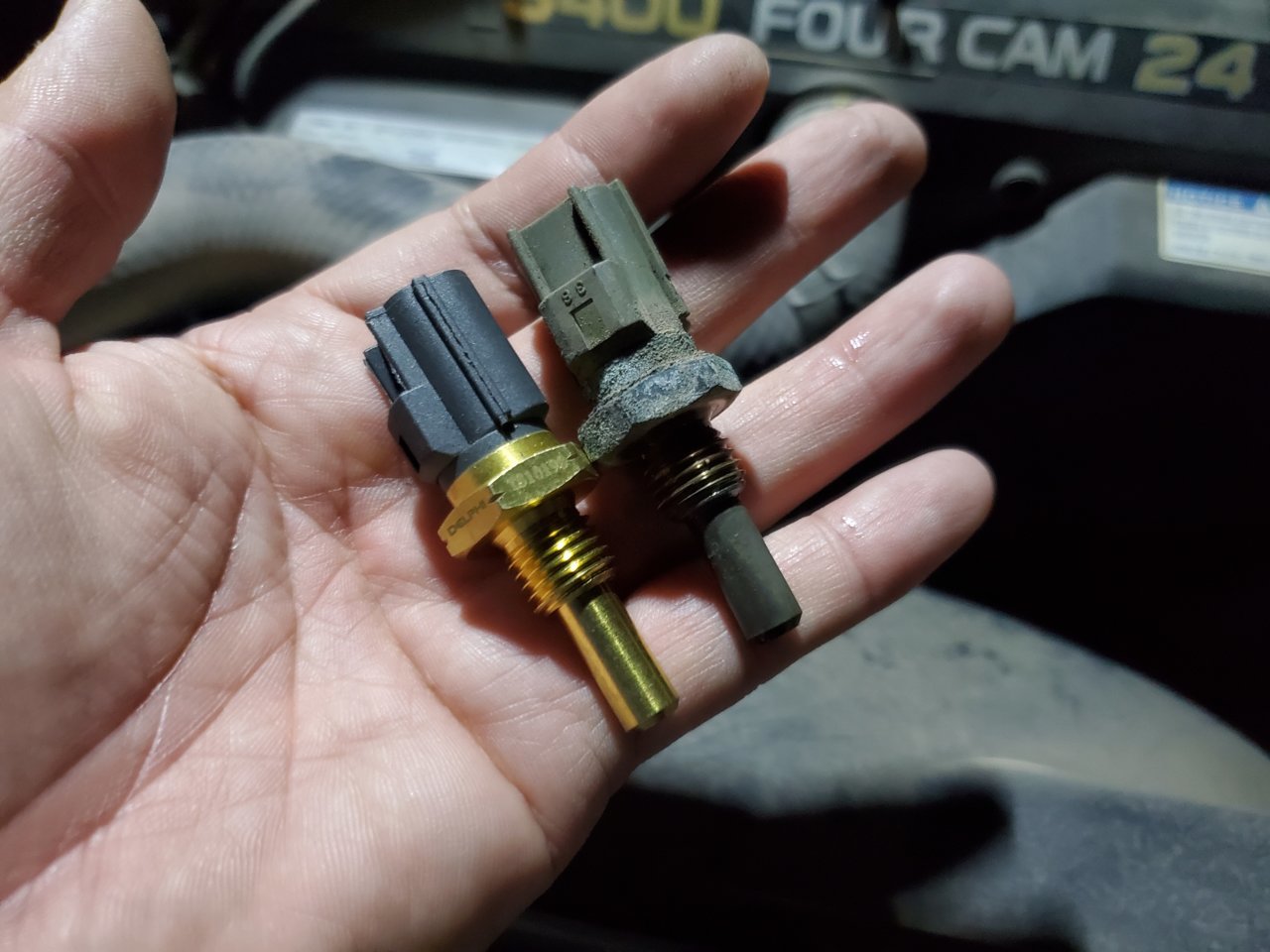

    High temps would cause both the gauge and OBD reading to rise; being in CA and having that code I'd just buy a sensor and replace it since you're gonna smog it for a sale anyway
    You'll want a small towel or several rags for that banjo bolt at the fuel rail cause you'll need to pull it off to get to the sensor
    Can't remember if it's a 17mm deep socket, or something similar to that size

    Scroll up to the pic I posted.
    It's a bolt in front of that fuel rail section that you unbolt to allow access to the ECT sensor.
    ECT sensor sits in front on top of the engine (it's the one that's unplugged).
