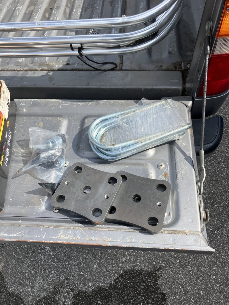

    Those round ubolts and plate look like they're for a u bolt elimination set flip kit. It deletes the factory ubolt plate and square ubolts. The round ubolts face up and that plate holds the center pin and bolts down the u bolts. You'd need to weld on shock tabs to use the kit
    Edit: that's not the right term but it's in the ballpark. U bolt flip

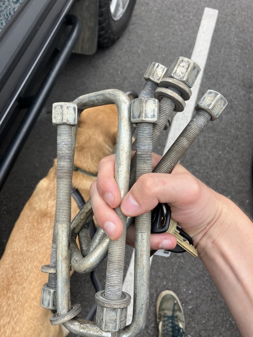

    Hm ok I guess that’s just to gain a bit more clearance? I don’t think I’ll be needing that really.
    @eon_blue i also have these square looking ones so hopefully they’re the right length.

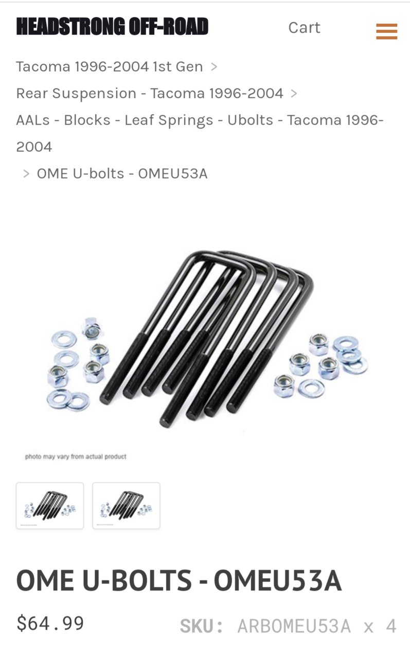

    Never reuse u bolts
