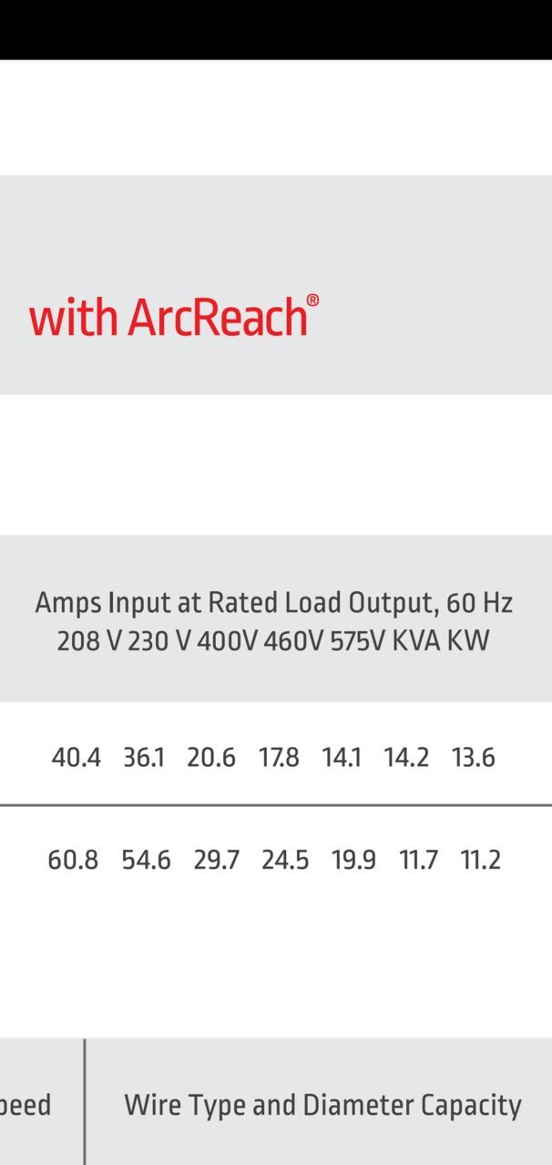

    I'm wrong, I instantly saw the outside turned tangs and thought of what I see everyday, that L14-50. But what you have is only 3 prongs lol
    Lemme look a lil deeper. What's that amp draw on the welder?

    What ever a red d arc ex360 fieldpro does. Idk the voltage thats gunna be user till i get on sight. But probably gunna be some kind of 3phase

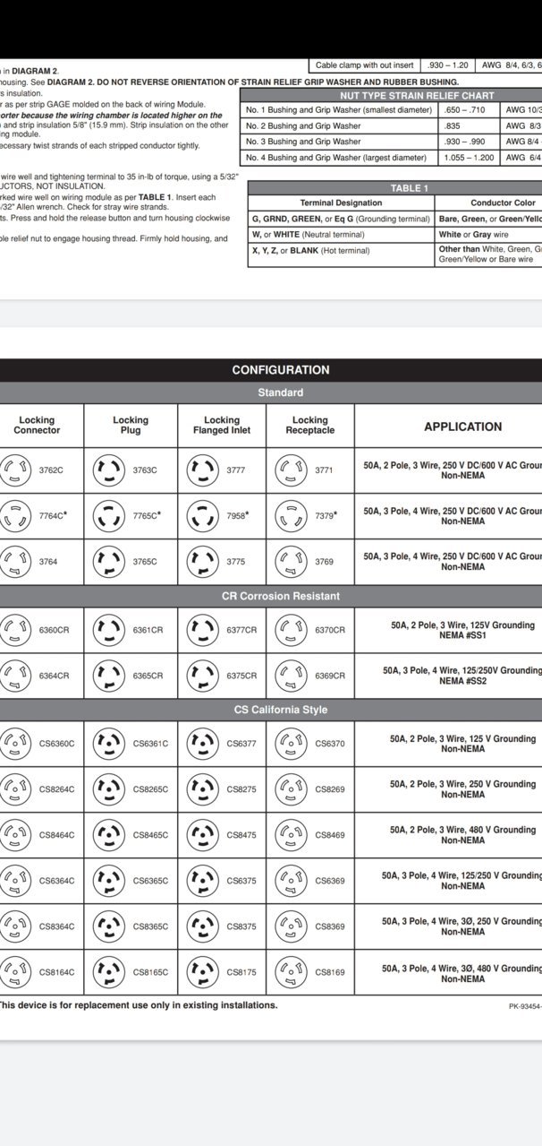

    Maybe this?

    If it's going to be 3ph. That welder can run on single phase
    Top row is your 3ph amp draw depending on voltage. The plug in that original picture is a CS8165 which is for 3ph.Screenshot_20230615-211400_Drive.jpg
    So the bottom row is what you're looking at. If it's dependent on what voltage is available on site, the bottom 3 rows are the part numbers you're after

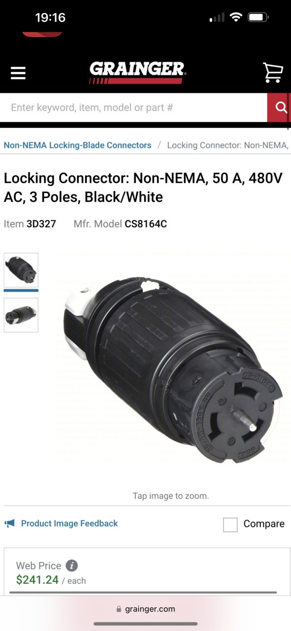

    Ok cool so what i found on grainger is the CS8164 which is its female equivalent
