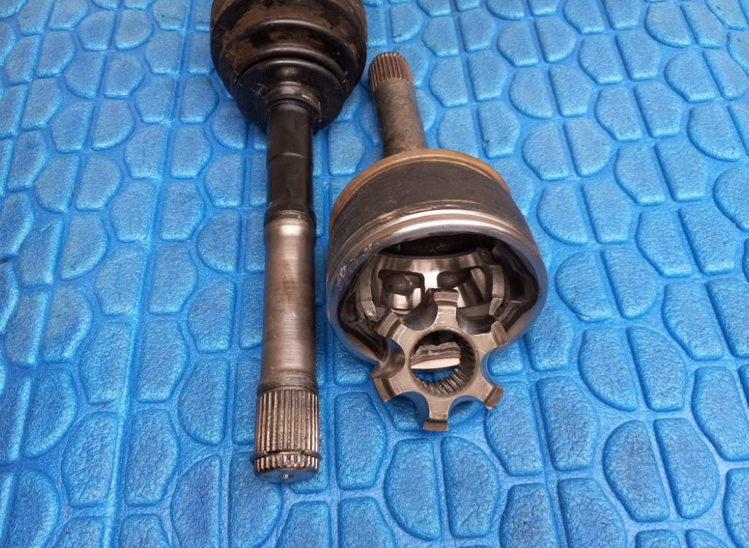

    @Ozark_RegCab When I was showing out at Jambo last year and got into a death bounce, it was the CV axle that blew and not the front diff. I carry a spare axle, so an hour later I was back on the trails. I would much rather blow a CV than a front diff.

    It’s weird how you don’t hear about 2-pinion front diffs breaking on an 80 series unless someone’s crawling on 37s, but some people would make you think the 100 series front end is made of glass. I’m sure it gets overblown on Mud like most things.
