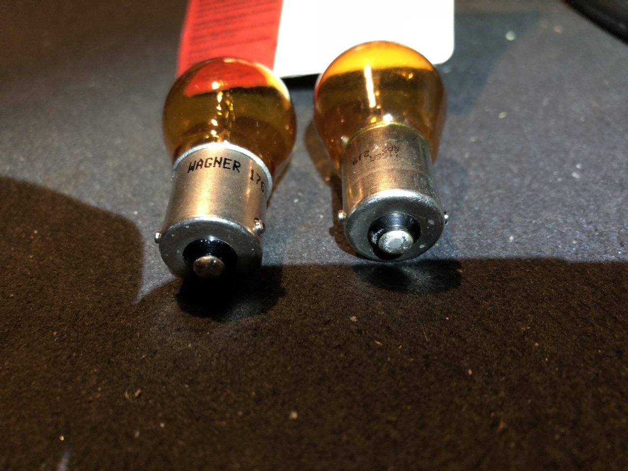

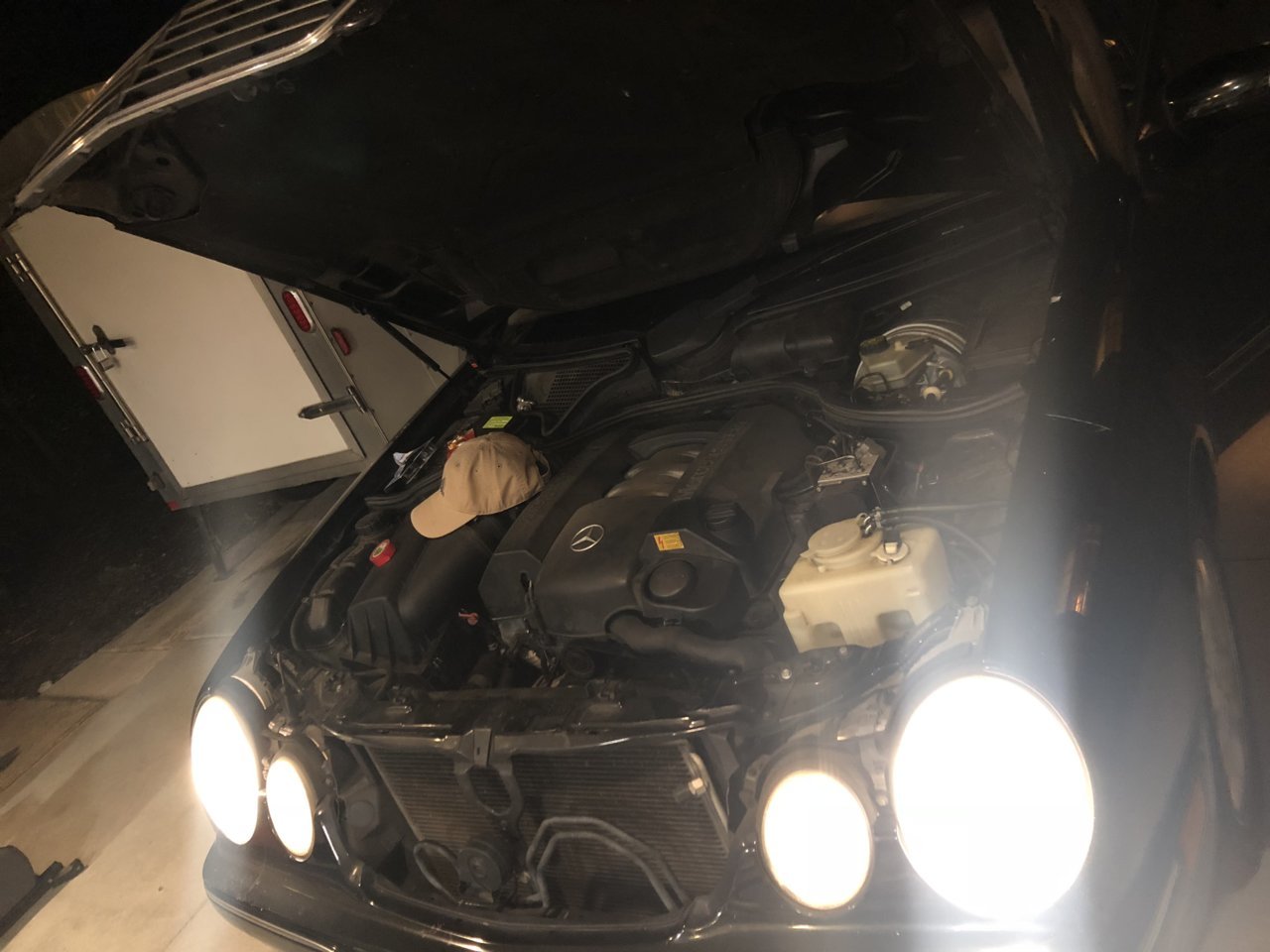

    Really, Mercedes?
    The two pins on the base are slightly offset on the aftermarket bulb.

    I think they bulb socket on was just corroded or loose or something. I re-seated the old one back and it’s flashing bright again.

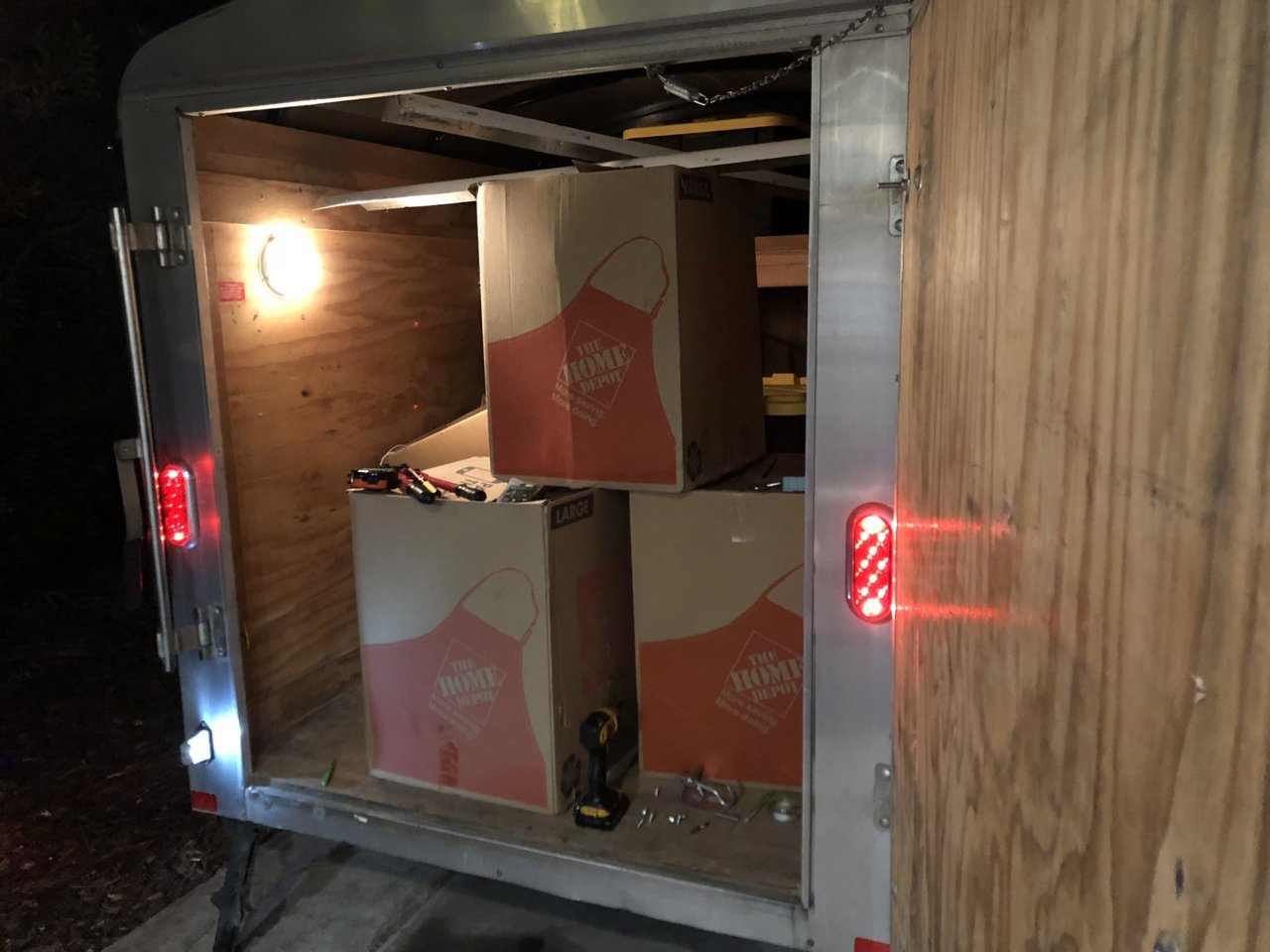

    Okay, now onto the trailer. Took me forever to find the license plate bulb and some light bulb. They are some obscure ass bulbs.

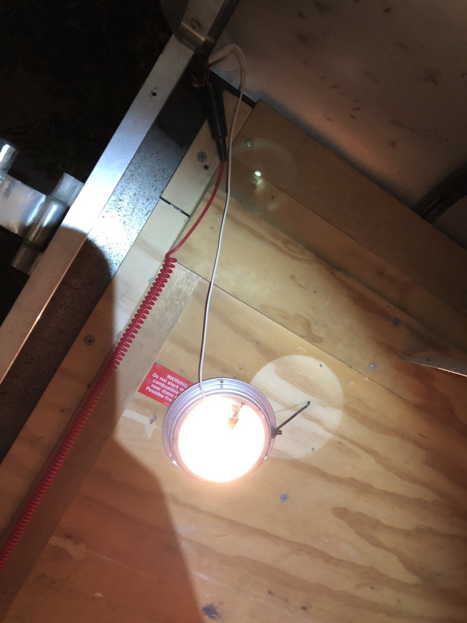

    Whoever built this trailer were a bunch of morons. The dome light never worked because it didn’t have a ground. I added a ground with a little jumper lead and it works perfectly now.
    lucky13don and Running Board Man like this.
  19. Oct 20, 2018 at 9:07 PM
    BartMaster1234
    Aug 21, 2016
    #195197
    45,888
    Tyler
    Pittsburgh, Pennsylvania
    Flux Capacitor
    That light, by design, is made to be grounded through the metal base with screws.
    But the people who installed it in the trailer just screwed it to wood. Not metal.

    It’s like Christmas.
    I need more lights on this bitch.
