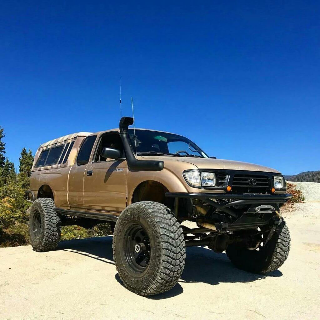

    I think I found the sas inspo truck I needed

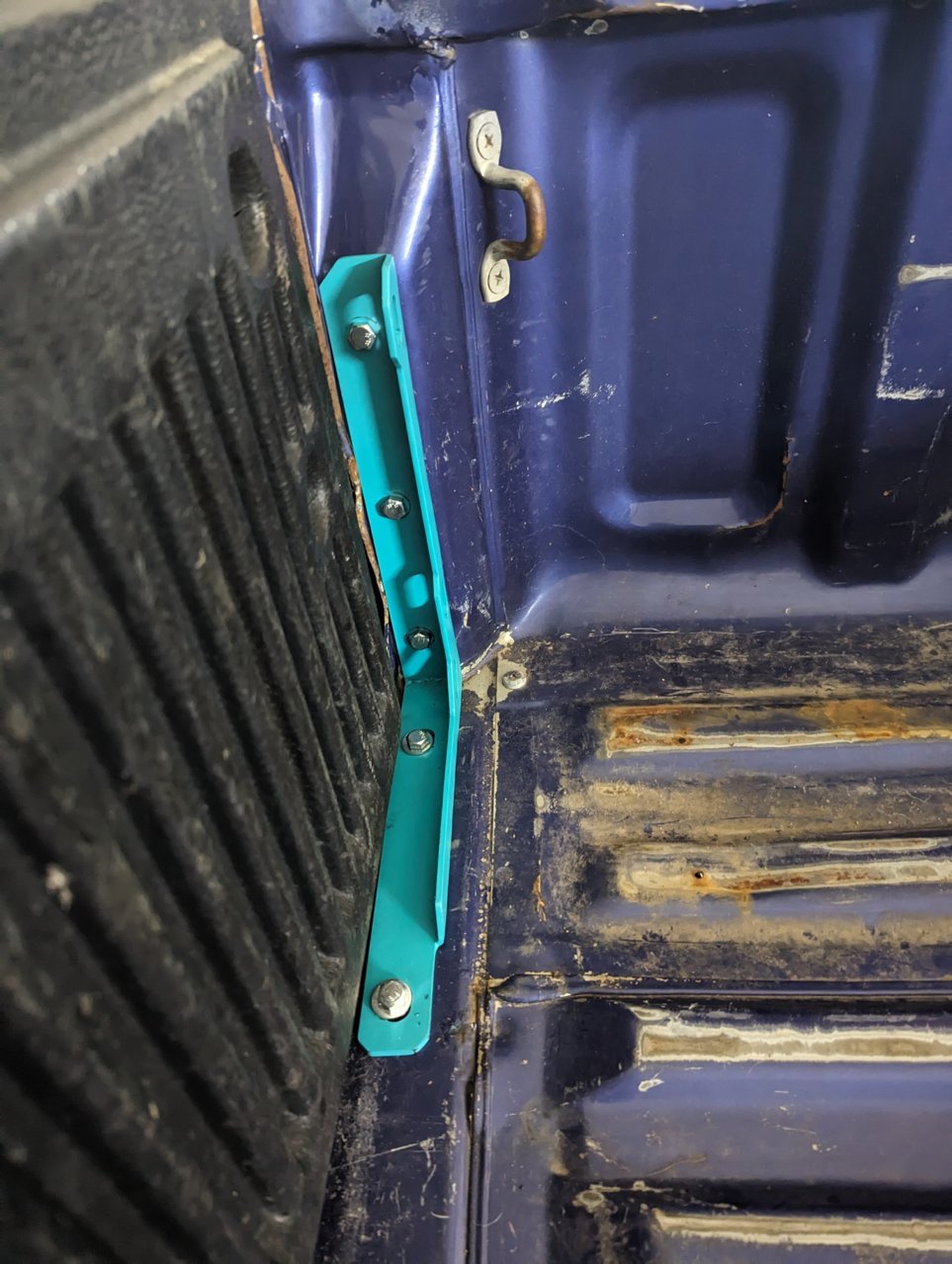

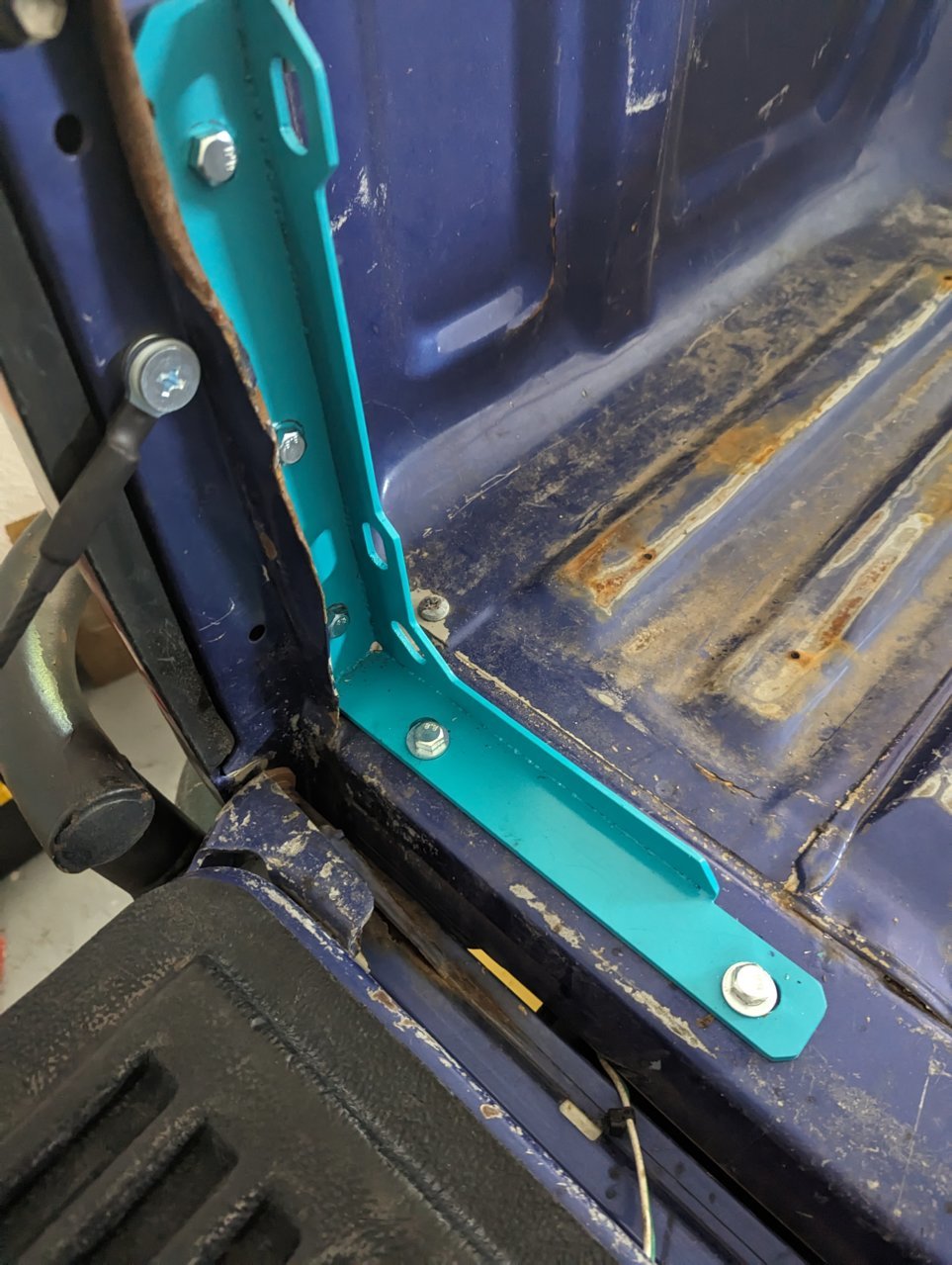

    All M10 or M8 hardware?

    M8 ...
    M8x16mm for all holes except the lowest one in the vertical, I used M8x20 or 25 for that because the metal on the back side is a double sandwiched layer.
