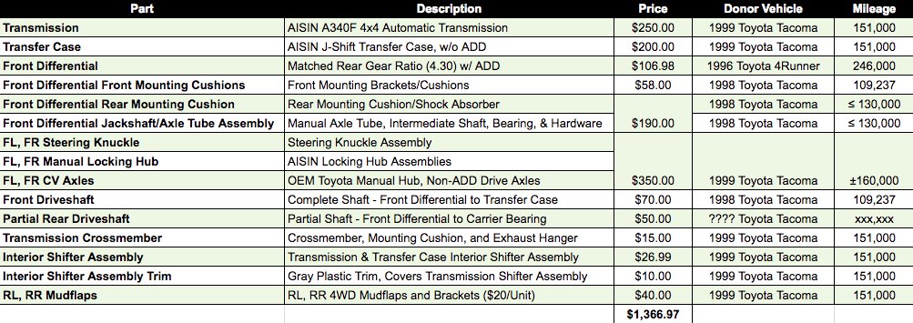

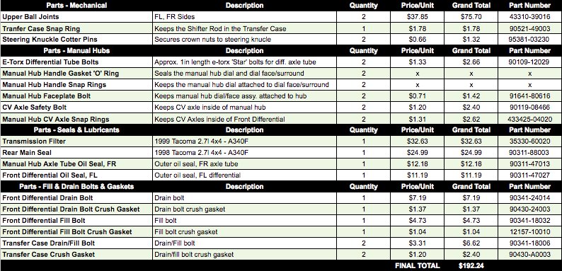

  15. Oct 20, 2018 at 11:52 PM
    BartMaster1234
    Aug 21, 2016
    #195197
    45,889
    Tyler
    Pittsburgh, Pennsylvania
    Flux Capacitor
    Here's the parts I used, and what I paid just as a basis for some research. Assumes J-Shift and Manual Hubs.
    I didn't included some things I splurged on, like I had my manual hub dials snadblasted and powdercoated, and I also bought brand new Manual Hubs to rebuild my old ones with (new pawl, clutch, springs, o-rings, and snap rings)
