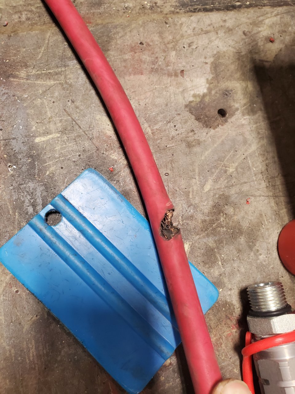

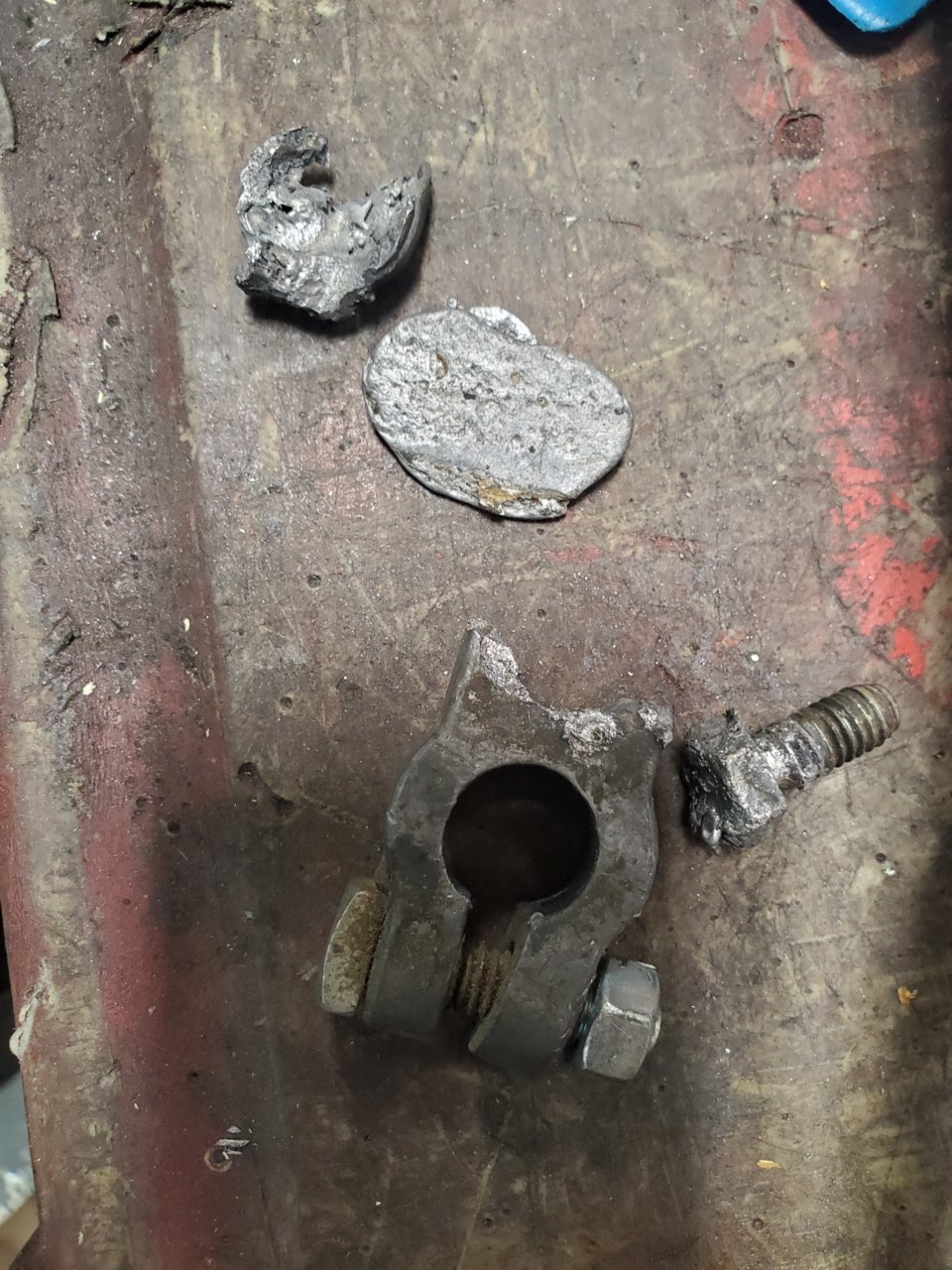

    Customer states : small fire in battery compartment20230706_080022.jpg
    That's the negative terminal lol.
    Traced the issue to the positive cable rubbing through under the engine and welding itself to the frame. I'm thankfully their truck didn't catch fire 20230706_080037.jpg

    Jeeeez yeah that was bound for a fire -- the negative terminal overheated and melted through before that happened?

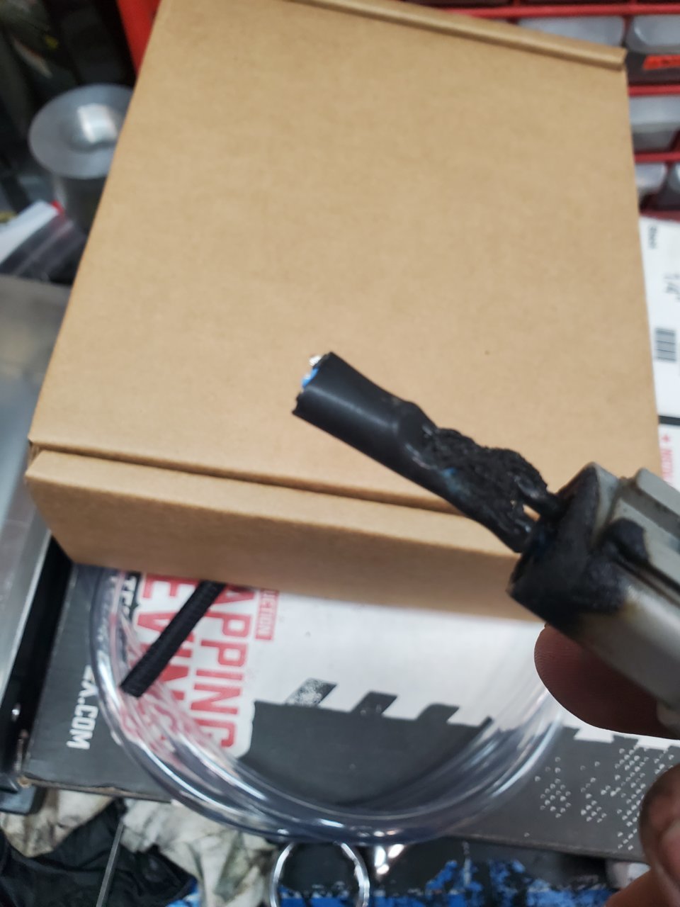

    Yea that's what happened, absolutely amazed. The fire started cause the lead terminal melted enough the cables loosened and then started arcing.it was actually the little wire for a cooling fan that caught fire right above the arcing20230706_084720.jpg
