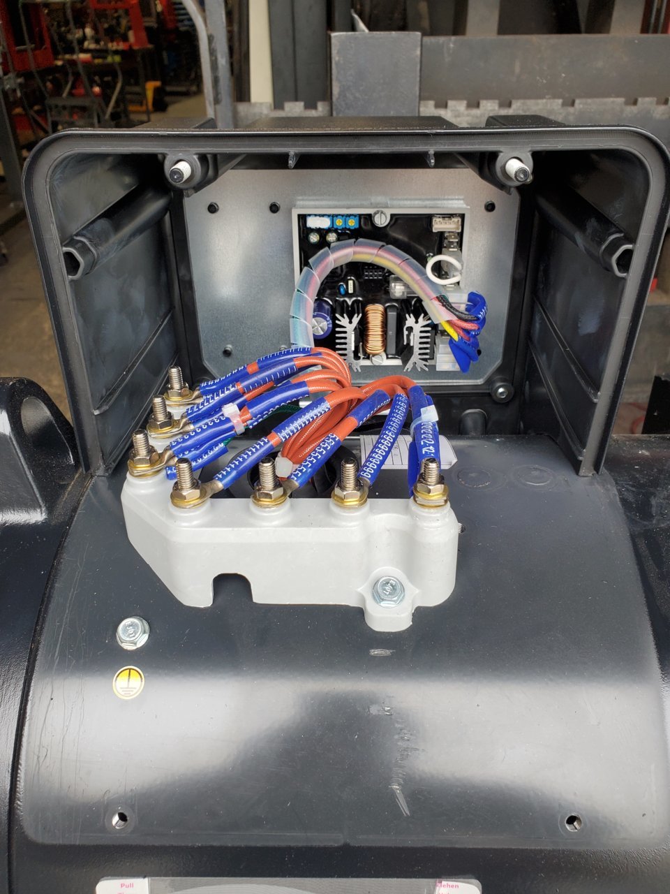

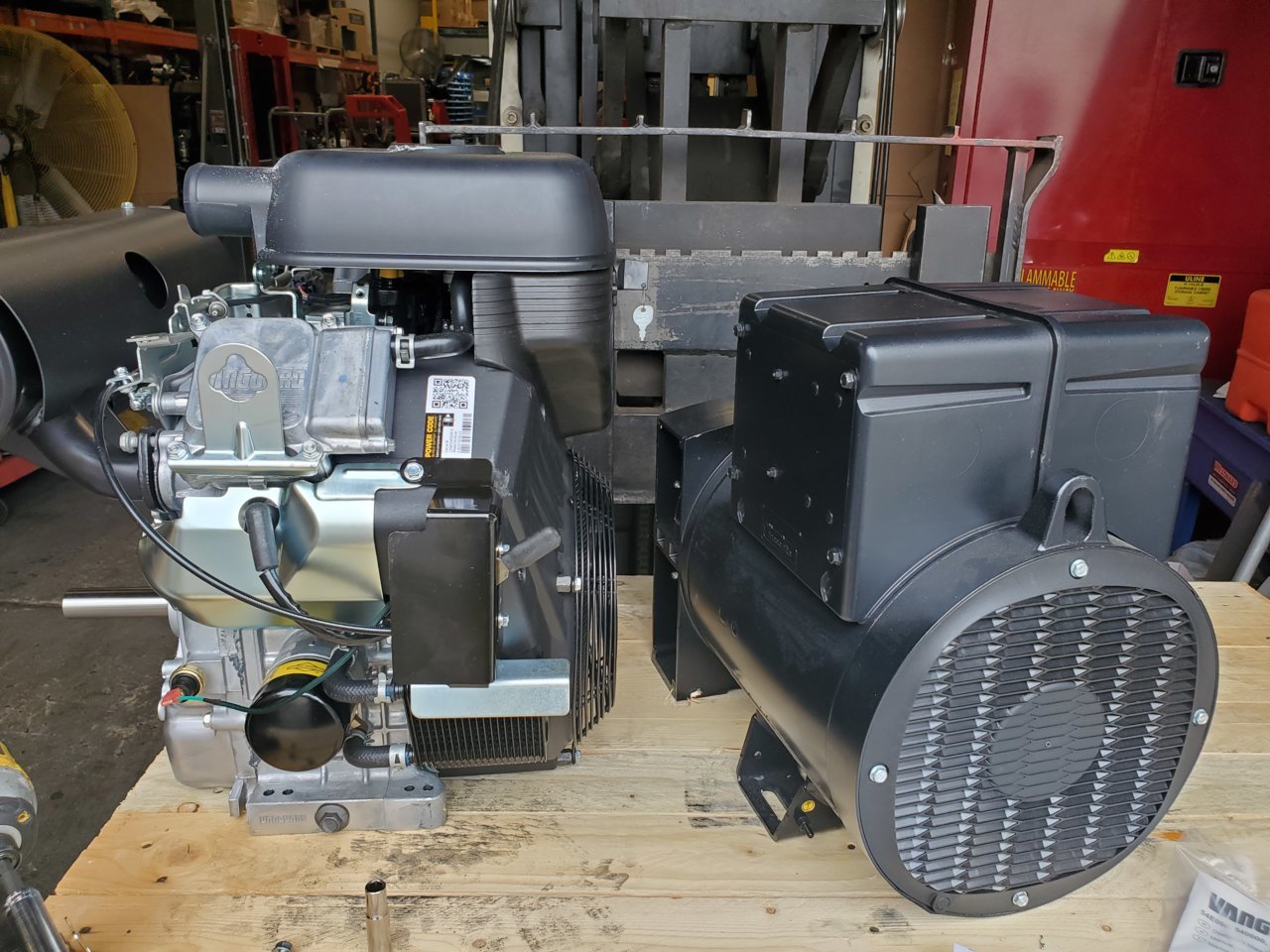

    So uh, why a generator instead of a rotary phase converter...

    My initial thought was a rotory phase converter with a step up transformer. But getting one that could give me 30A 480V was close to 10k.. at least thats way cheaper than the quote I was given for having 480 3ph brought directly to the shop, which was almost 20k.
    Since we already have these engines for our small frame hydraulic powerpacks I found an Italian company (meccalte) that makes this 3ph generator and it was only 2k. With our OEM engine pricing I'm into this for only 4.5k (including frame material and fuel tank) I've still gotta add up the cost of electrical things likes cord and breakers, etc. but it should still come in less than a rotory.
    Plus if it works well, we can sell it to our customers as another line card item:spending:

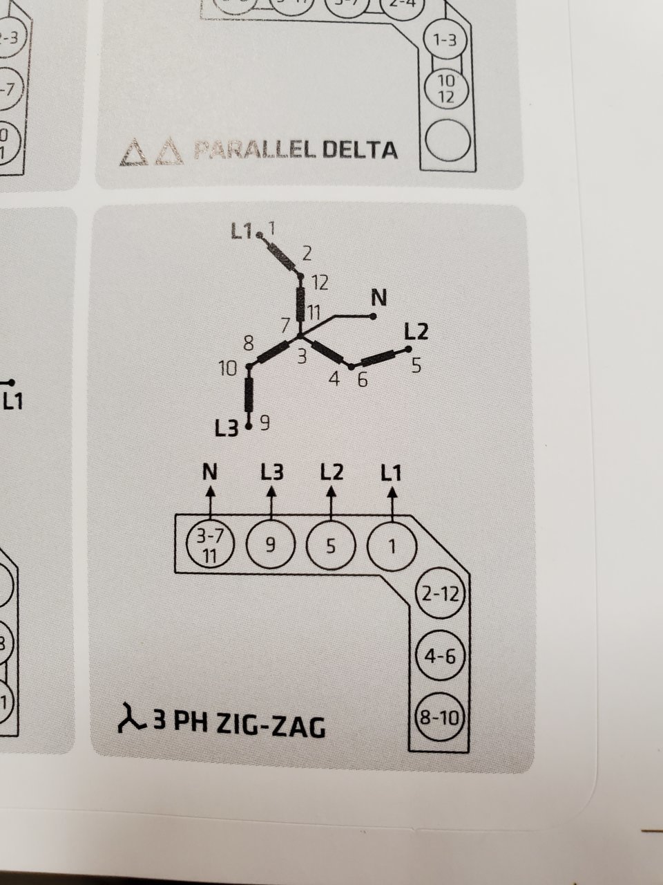

    @treyus30 I'm just a simple wannabe elec-chicken so pardon my ignorance, but WTF is this?20230708_103350.jpg
    I know wye and delta configurations but this is the first I've read about zig-zag

    I don't think I've heard of zig zag. I'm used to star and delta for machines... Wonder what that's used for

    I'm alright with these configurations... up until the last two lol20230708_104631.jpg

    I guess it's purpose is to introduce a neutral into a system. Maybe some machinery with 120v circuits would need that?
