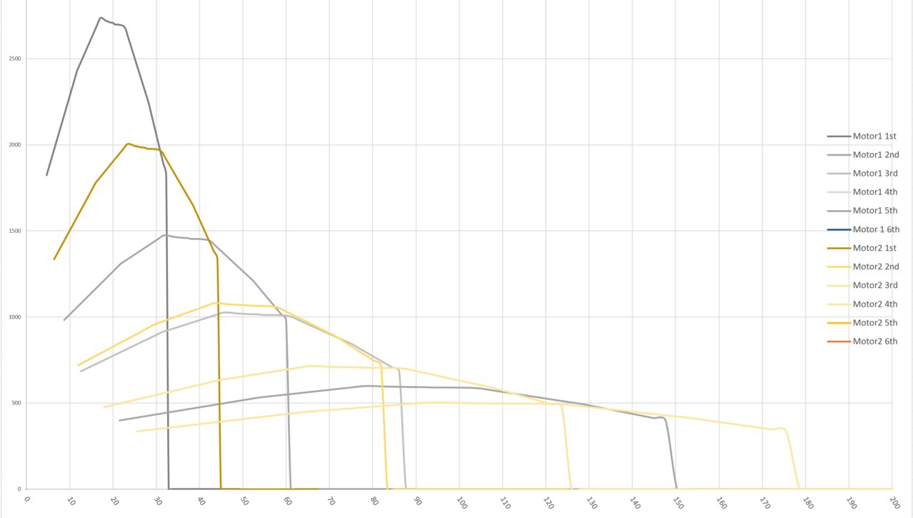

    also the overstep from 1-2nd on both trans is almost more a function of the 5VZ than the trans...

    the way the Powerbnd matches to gear ratio and quantity of gears has a major impact on the perception of drivability.
    I'm extremely pleased with the experience my powertrain config provides.
    2GR revving out to ~7300rpm .69 hino 5th gear, 4.88 final drive. Compared to the factory 5VZ/A340F combo, its literally like a newer generation vehicle.

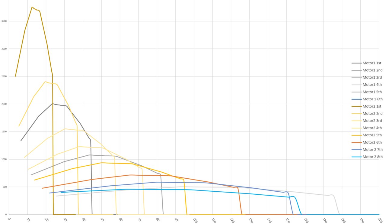

    yeah on paper the 8L90E and the ZF8 both have a fantastic spread with the ZF8HP51 (unsure if this can be changed to a 4x4 trans like the ZF8HP50 in lots of things, but notably the JL and JT) probably having the "ultimate" spread having excellent lower speed spread and great cruising spread sacrificing the mid speed performance "slightly" imo

    I'd be willing to bet we could make a ZF8HP51 work, and I already know from tuning BMWs I can make that trans shift instantly (it can go gear to gear without unlocking the TC if you have ignition cut/retard configured)

    The one upside of using a GM trans though is that the adapter already exists... that said the GM trans 8 and 10 speeds at least can also go gear to gear without unlocking the TC

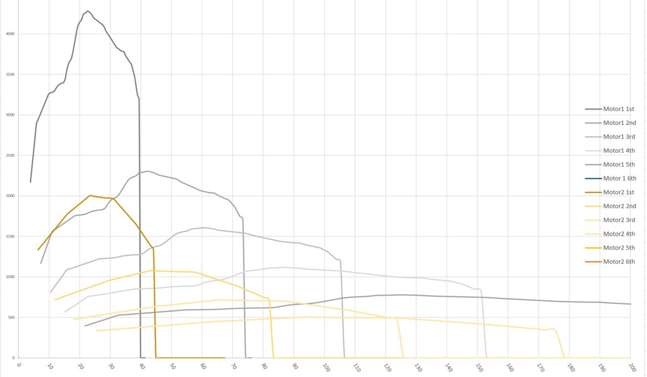

    Took a minute to add, but heres that ZF8HP51 vs A340F both with 5VZ and 4.10 fd. absolutely superior

    Can you explain the axis on the chart? I assume that your Y is rpm but that's not really making sense with having two points on the graph with different MPH (my assumption of the X) at the same RPM. Also hen you say 31s, are you rounding up on a 265/70/16? Sorry for the gauntlet of questions just trying to understand what I'm looking at and why things look slightly off from my own data.

    Y is the "road force" aka the force experience by the vehicle as the result of torque application, but taking tire diameter into effect, so... not just torque

    Ok that makes a bit more sense as I remember the NA motor falling off after 3.5k. I can tell you in practice you can't hit the 88mph in third as your chart suggests :anonymous: that's being very not picky though, it's a really cool chart though and very useful information. I want to find something similar for an LS bolted to a T56 to see how it compares to the LS bolted to an R150F. I'm being too lazy to actually do the math ha!

    but this is where the power being left out of what I'm showing leads to some questions, since even tho the Force is greater, the rate at which you are progressing thru the RPM is slower, so acceleration is not optimal to stay in higher gear, but if for some reason you were towing up a hill and trying to maintain speed, you would be in the top of 3rd and not the middle of 4th. dDes that make sense?
    I don't think the chart I have shared there shows you can get to 88mph in 3rd on a 31 with 5VZ... theoretically ~86 is possible, but with 5VZ, I recall myself shifting at just barely over 5k since the lack of power past that point was crazy... so shifting to 4th around 78 is more likely from my memory.
