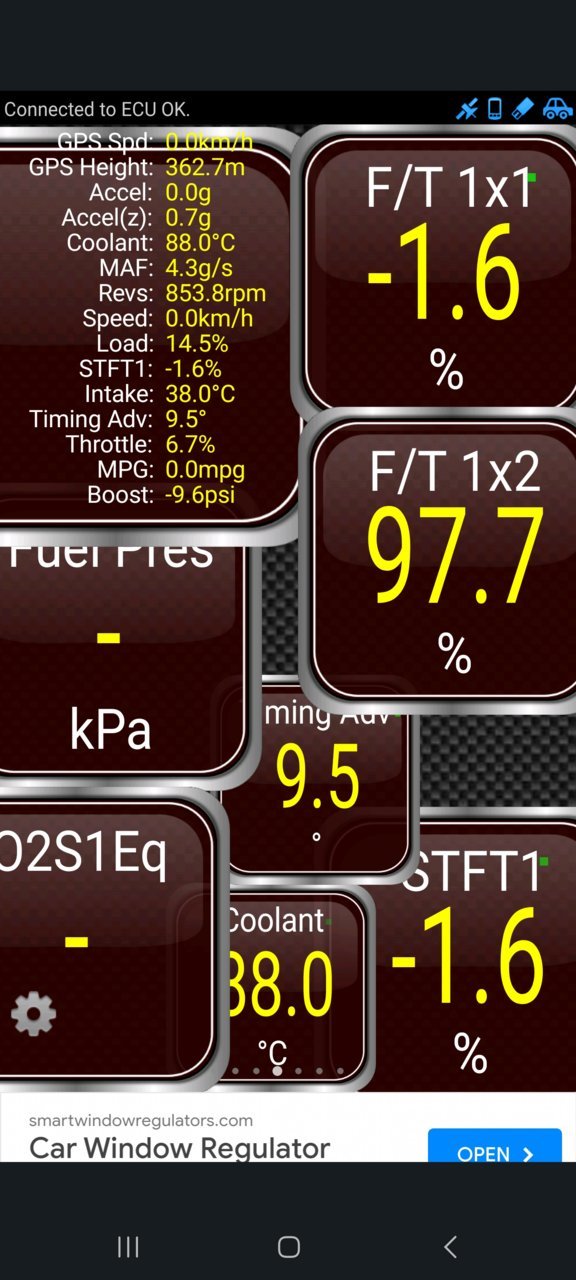

    so the truck starts more in the negatives, had it go to -14.6 in the first 2 min of driving.
    Thennnnn when it got really bad after 15 min of driving the number would go upwards of 19 after it would bog and die on me with a limp pedal. The numbers did not spike until after the bog, but that may be due to the torque app registering it. at the end of my drive im fighting it nose diving constantly if i barely press more than lightly on the pedal ; truly terrifying

    Timing advance drops too, but i think thats normal when it dies. The coolant does not go above 88 Celsius

    False lean? Richens up and dies? Symptoms of exhaust leak pre-cat or intake post-MAF

    You
    Checked your main intake tube for cracks?

    Ill check this. The initial startup idle is insane, like this morning was 1.8k. idle seems strong otherwise, just when i get on it gas-wise.
    fingers crossed its just the post maf tubing. The cat is brand new and o2 sensor, will check piping earlier on for black marks from a leak
    nope, i will. should it be an obvious one? Or blow cigar smoke into it after its hot.
    Gonna keep at it, thank you all. Really want to enjoy the shit out of this truck. It is so fun otherwise
