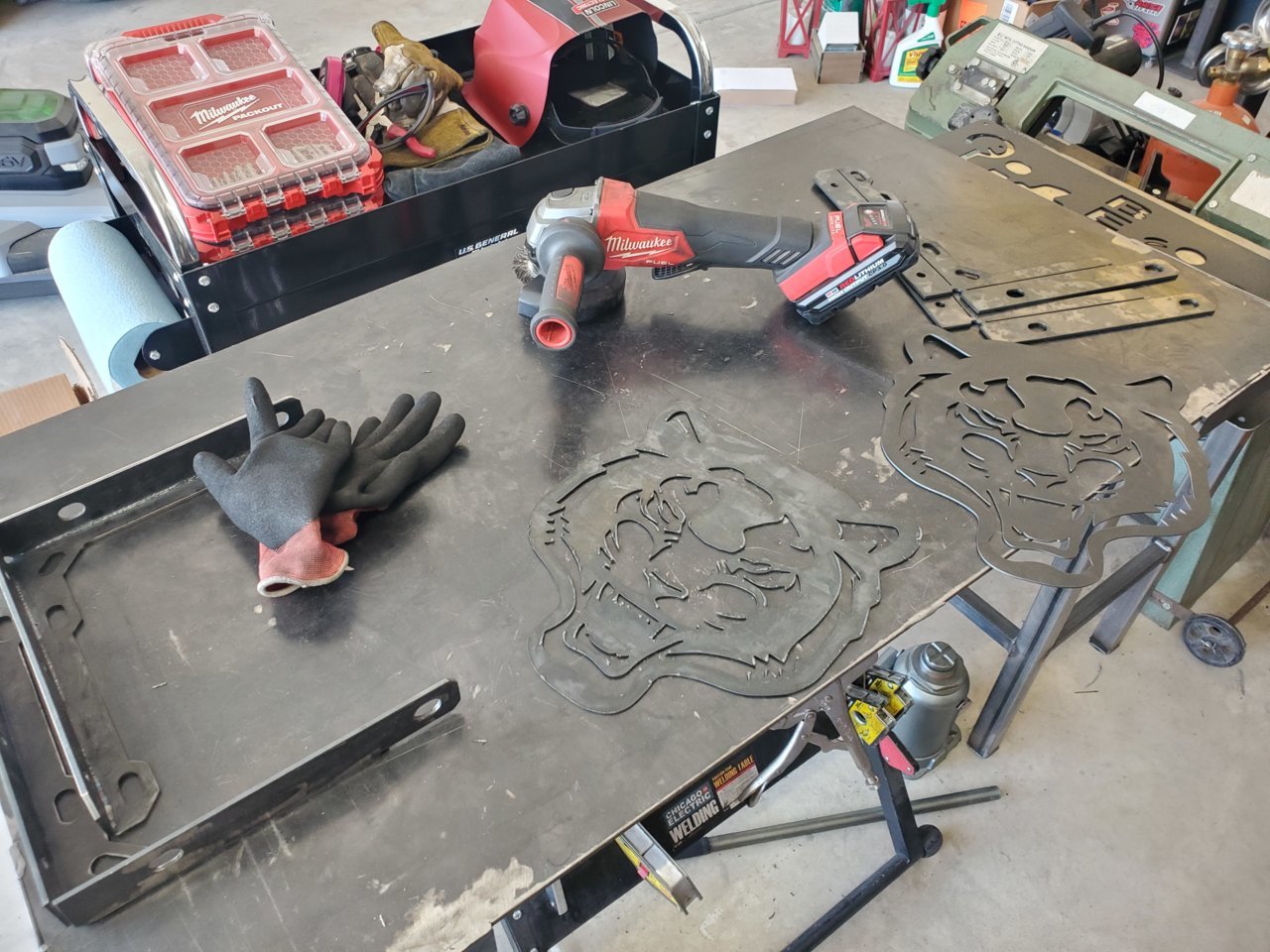

    If you can find a background you like, I can incorporate your name
    Or individual items to convey what you're wanting, I'll see about making it work
    Your name would be the easy part
    Just came to the garage to make some more stiffies and work on another set of tiger cut outs

    Convertio is what I used for that tiger; the apple/teacher one I just used an image as a canvas and traced it

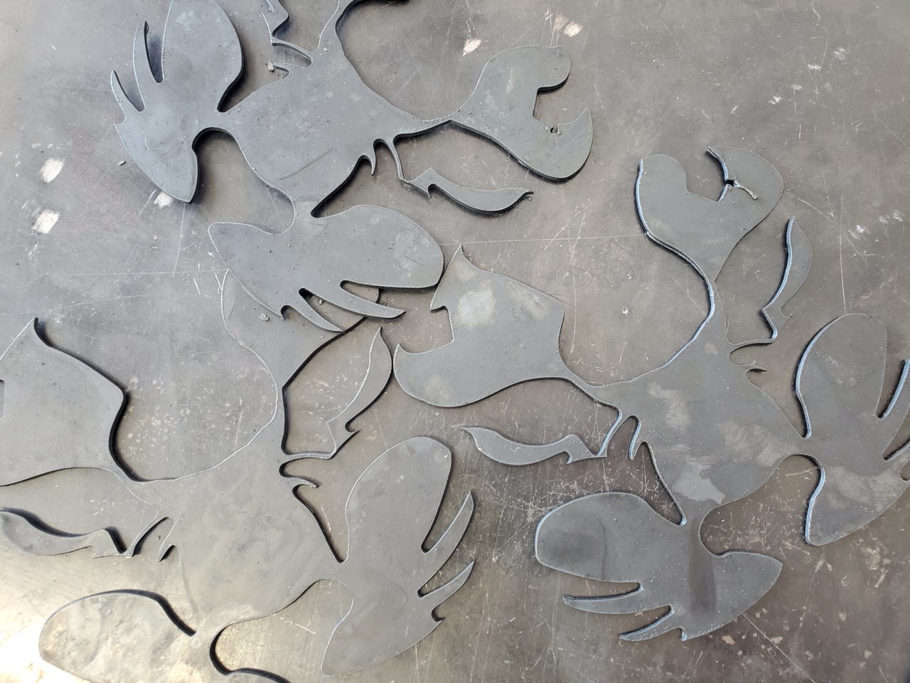

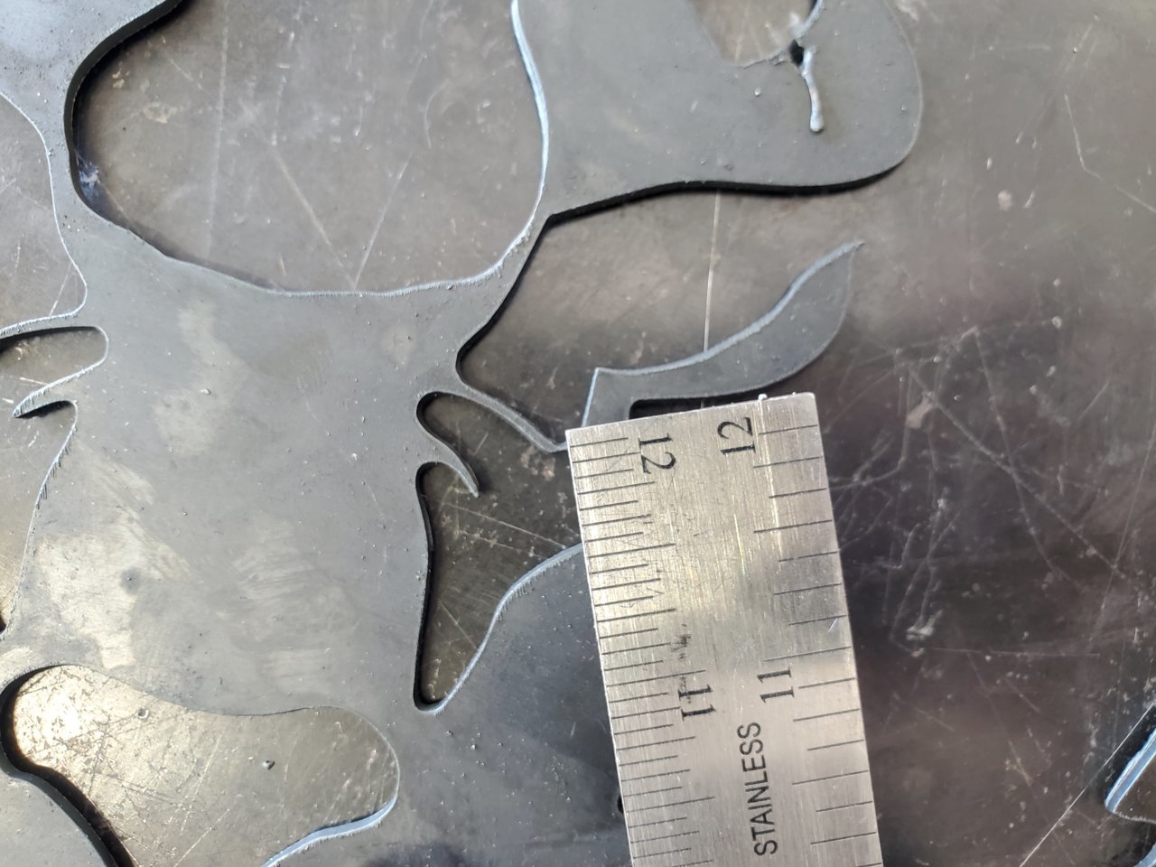

    Have to say, I'm glad I got a water table too cause I wouldn't be able to experience within 1/32" on some of my cuts
    Consistent across all pieces
    I remember Danny telling me his experience was without a water table; would've been a no go on 16 gauge cause that shit would've been warping like crazy

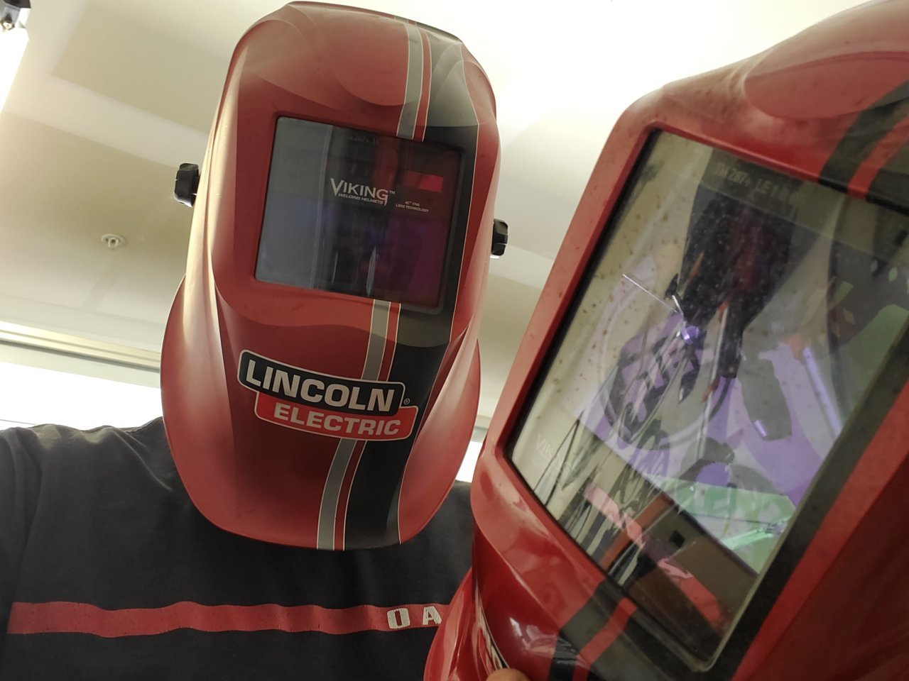

    You ever just grab your backup hood, and realize you practically never use it so the lens is clean AF?

    Yeah those tiny sections wouldve burned right through/melted off
