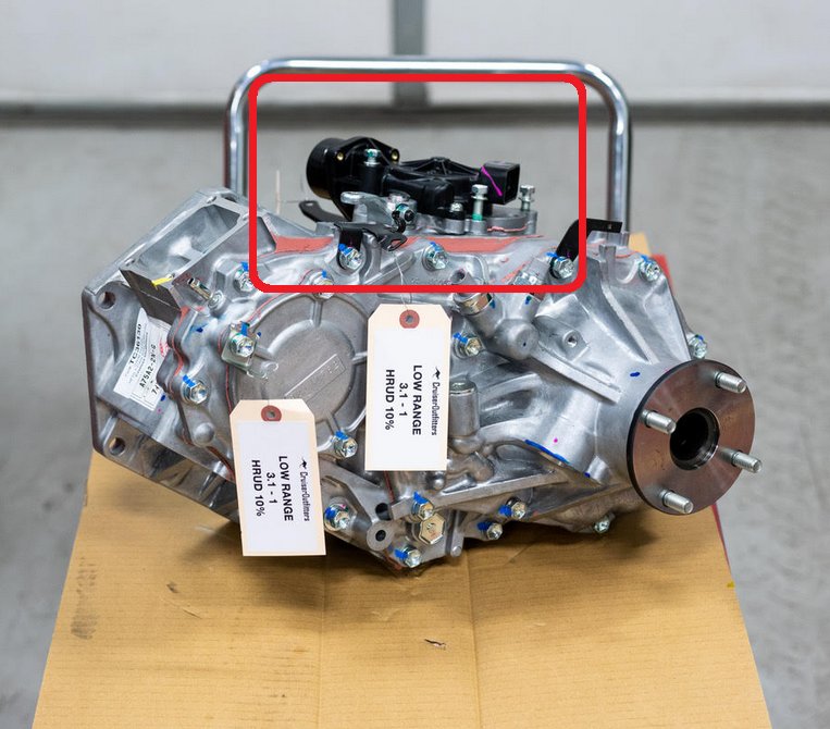

    Well that hurt my wallet but it had to be done. The 80 series center diff lock actuator (4WD actuator) is discontinued so I ordered a brand new actuator for a 100 series since physically the transfer case is the same and now I have to find a wiring pigtail for it. @CS_AR has your old 100 gone to the wreckers yet, would you be able to take a pic of the CDL actuator pigtail/see if the connector has a part number?

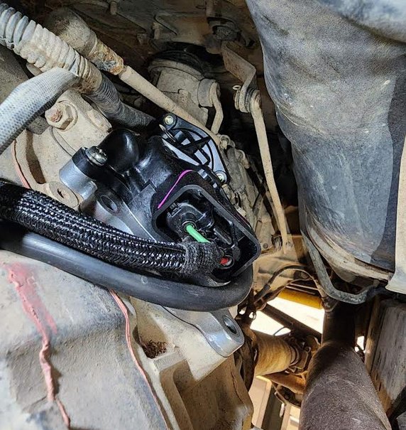

    I'm moving the LX 3:1 reduction transfer case to the LC100. So I need to disconnect stuff. Is this the plug that is on top of the transfer case?
  9. Aug 8, 2023 at 7:17 AM
    Speedytech7
    Feb 20, 2014
    #123587
    58,129
    FCQM+VG Cheney, Washington
    It's less Tacoma and more mod
    Yup plugs into the motor right on top, 5-pin connector that looks like a MAF connector (but apparently isn't one)
    Can see the harness someone else made to adapt, but they wouldn't divulge the part number of the connector. The OEM pigtail may have a little rubber breather hose bundled in with it too.
    CS_AR[QUOTED] likes this.

    Yeah, he confirmed the 100 series actuator works, it's what he sells on his ready to install cases. He makes a conversion harness but only if you buy a whole case from him... which is a bit outside my price range haha

    Ohhhh He's in the group where I just posted the question with the pictures.

    Lol those are his pictures haha, well it may get his attention at least and he'll answer
