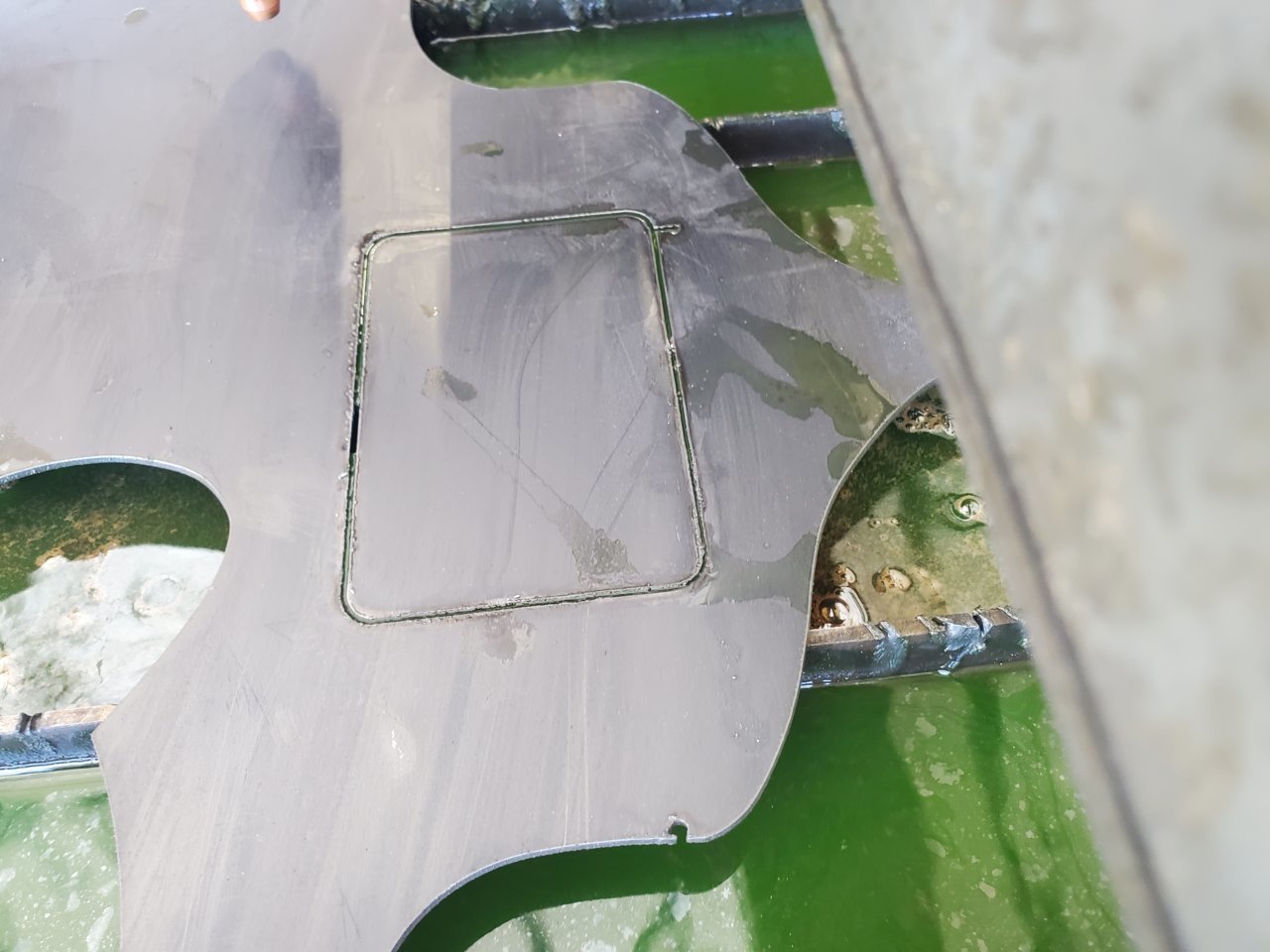

    Ok wow, I'm digging these tips with only .8mm kerf width
    Might not look like a big difference but it is in person compared to a 1.1mm kerf width

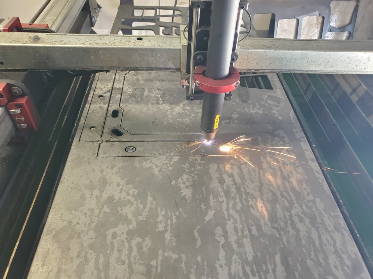

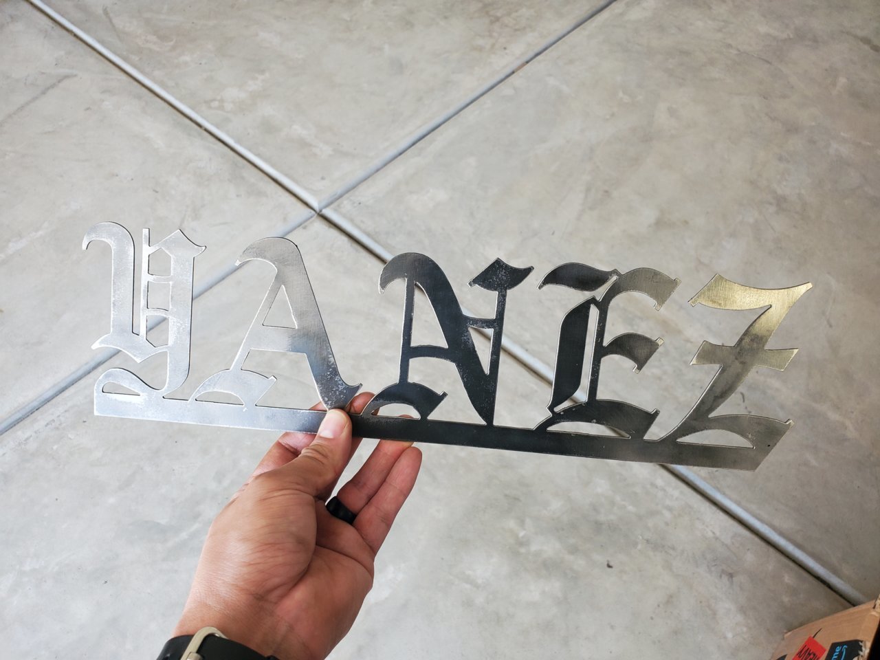

    First time cutting with the .8mm outside of a test piece
    Came out sick
    It's on 16 gauge too

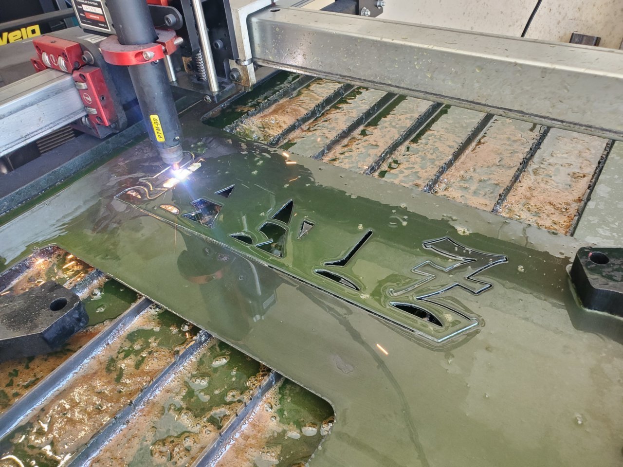

    @Abeyancer
    For when you get your CNC table, I noticed that I cannot see the lead-in marks at all with the smaller tip; the 1.1mm puts out enough heat that I run a 0.6 second pierce delay to cut 16 gauge.
    It took a 0.8 second pierce delay for that same 16 gauge using the 0.8mm tip (I used 0.9 second delay) and with the many cut outs, not a single indicator of where the lead-in was.
