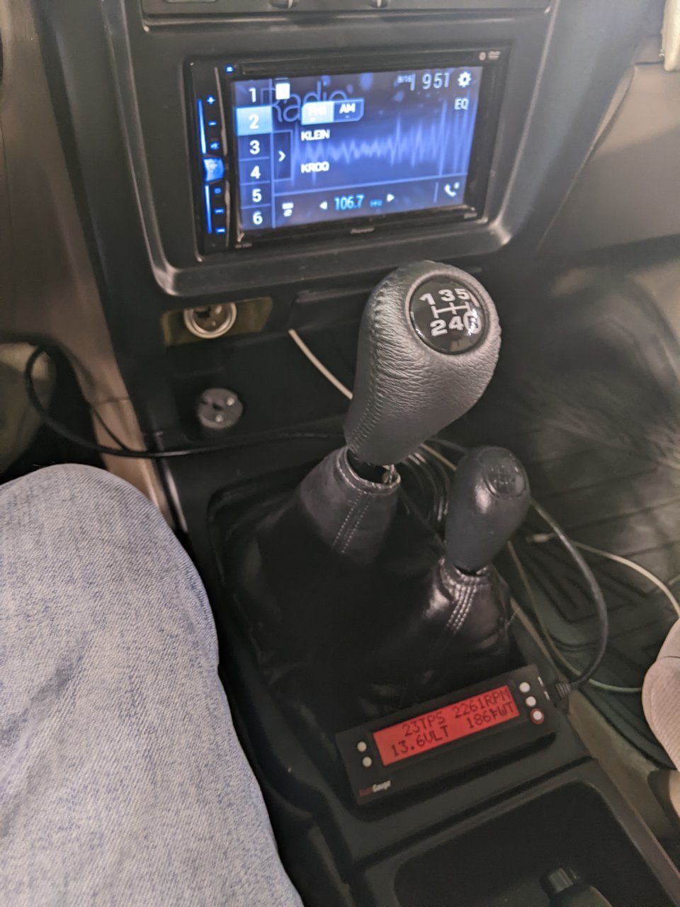

    Is yours a SG1 or 2? I have the 2, I can't remember if I there's an option for changing the color of the backlight. It's always been amber to match the Tacoma, but the 4runner has a green dash so I might see if I can switch it to green if that's an option. Prefer to keep it in the 4runner since it's older/higher mileage, will probably get an UG for the Tacoma at some point.

    Kroq play anything good anymore?

    Yeah they're still pretty much the same station as always, music-wise. Just don't have Kevin & Bean, Dr. Drew etc that made them so famous 10+ years ago.
