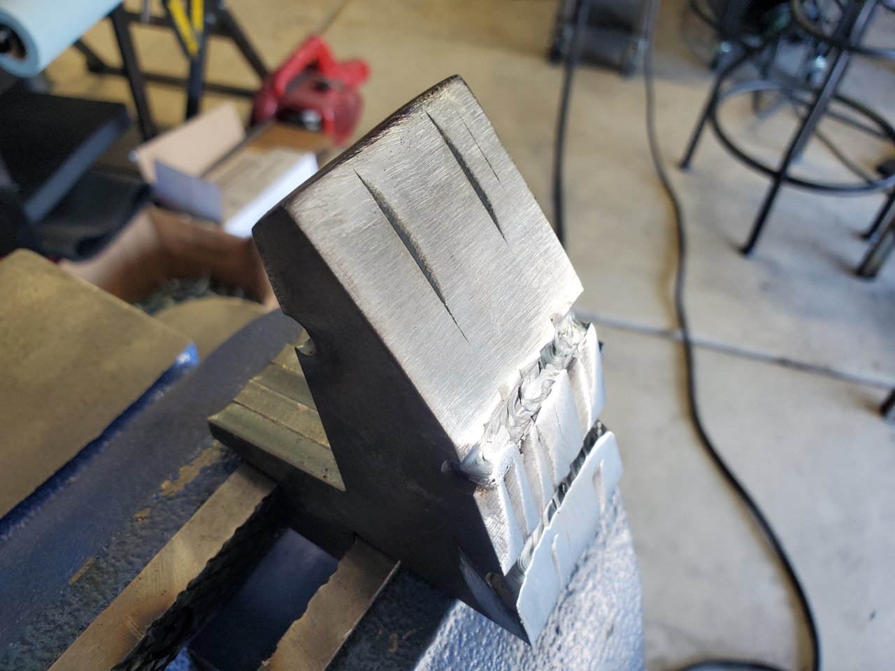

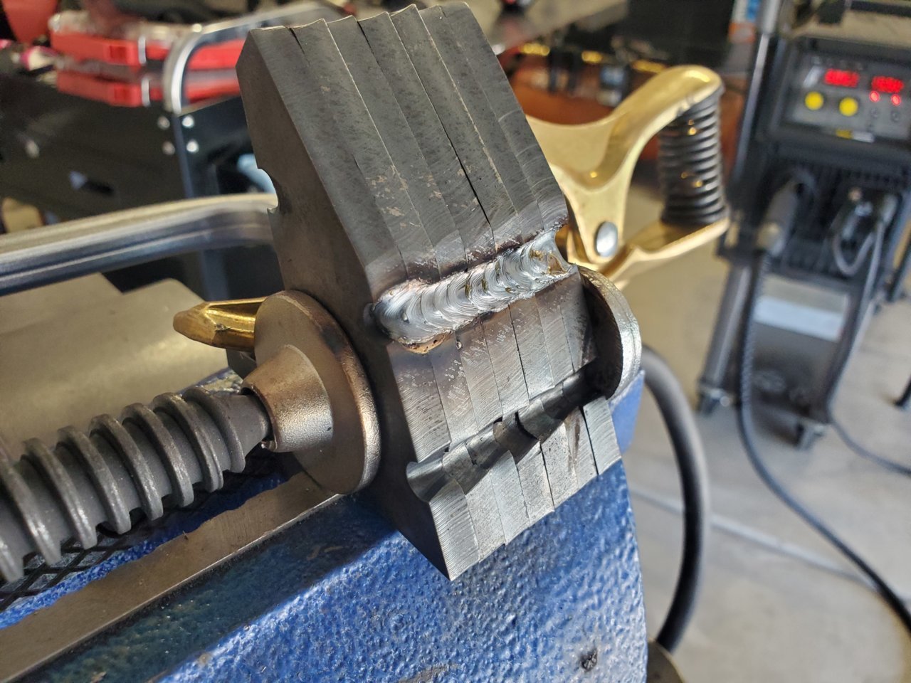

    I will say, even if this set is a bust it did show me that even though gooseneck dies are really convenient, they only work well if you're only making small shit on a 20 ton press
    These dies are similar in size with Swags offerings and only have clearance for a 2" leg so anything larger than that will not work
    This is where I've gotta say, go big or go home
    Least I saved myself some money

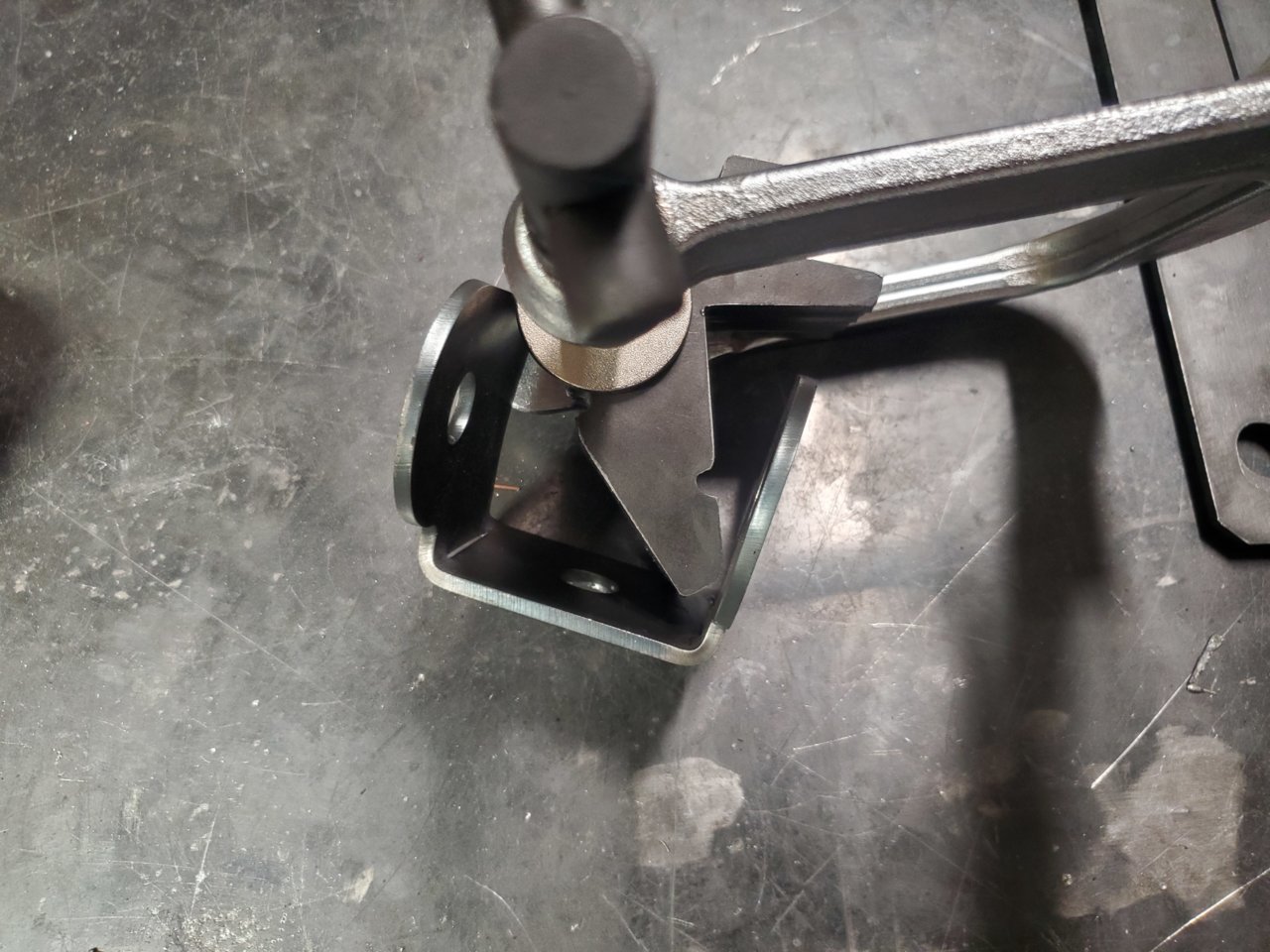

    I'm a dummy dum ... what do you mean by 2" leg?

    The length of each piece as you look at it now
    There's a minimum you'd want on the piece to the left of the die at the bend (the left leg on the V in yellow)
    The piece coming over and around above the V (purple) can't be more than 2" when you make that bend a full 90 degrees otherwise it'll hit the die

    Oh okay, cool. Thats what I thought you ment but wasn't sure. Thankfully I don't think any of my brackets have 2" bends that tight together so I should be good with the swag kit. I'd make my own but honestly with the time involved setting up the shop for everything else, it'll be more efficient to just pay them for it
