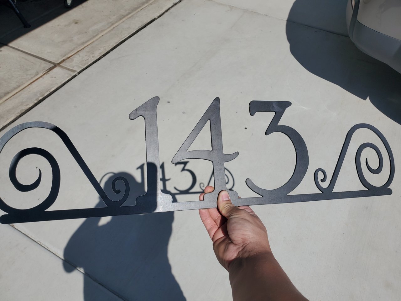

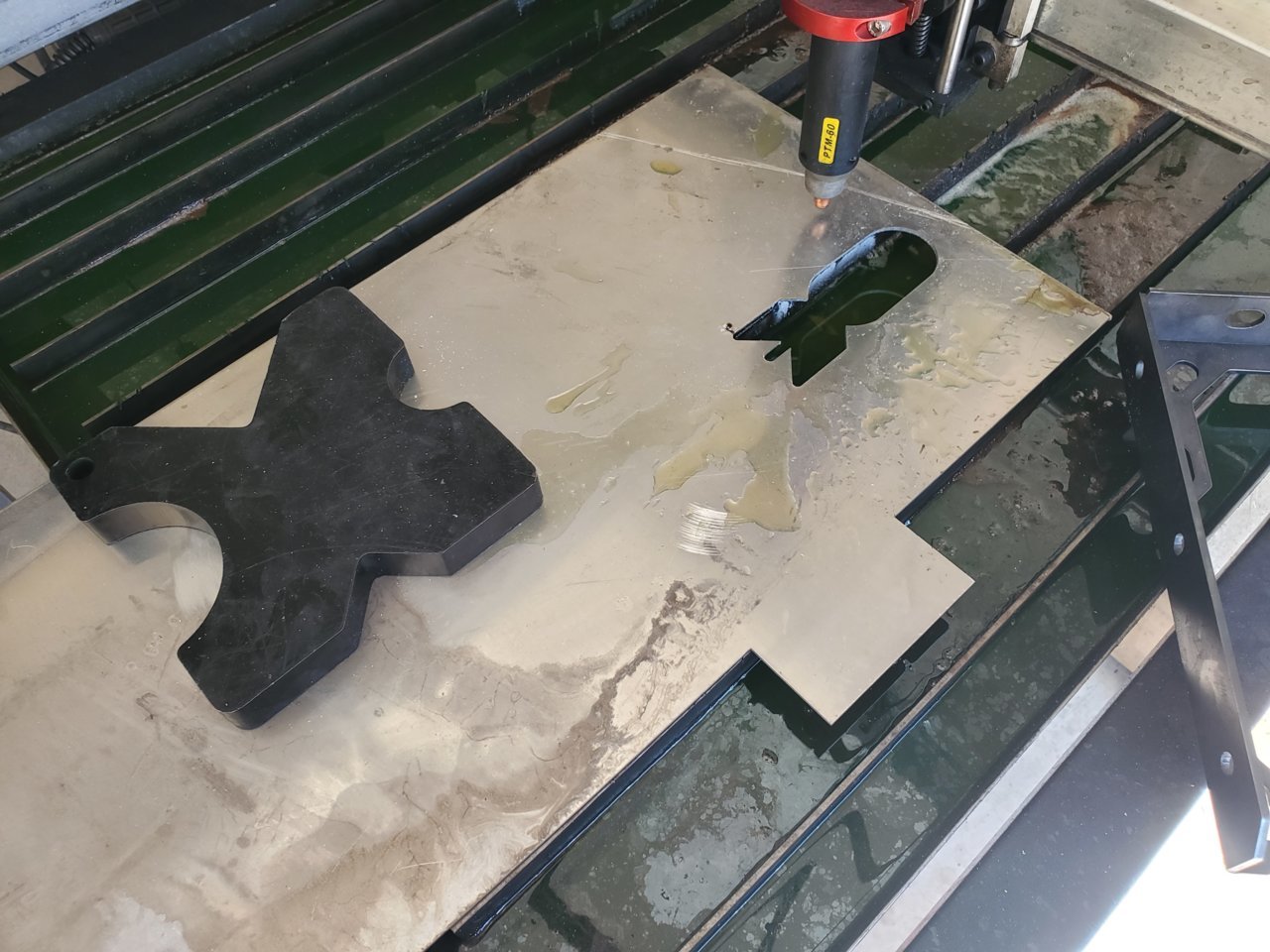

    Not the cleanest, as aluminum cuts much better with gas versus air but this came out clean AF for my first time on aluminum!
    It's that old big piece I got for only $8

    It's less Tacoma and more mod
    I kinda wonder how alum will do for that application. Is it 6061 or 5053?
  8. Sep 4, 2023 at 2:30 PM
    Kwikvette
    Feb 27, 2019
    #284735
    82,202
    Fresno County
    4 run, 2 don't
    5053 as it's what I wanted for both practicing on my table and dialing settings in, as well as bending on the press.
    6061 or 6xxx series is supposed to crack when put on the press.
    But the cuts done with gas on this table are sooooo clean :drool: just gets expensive

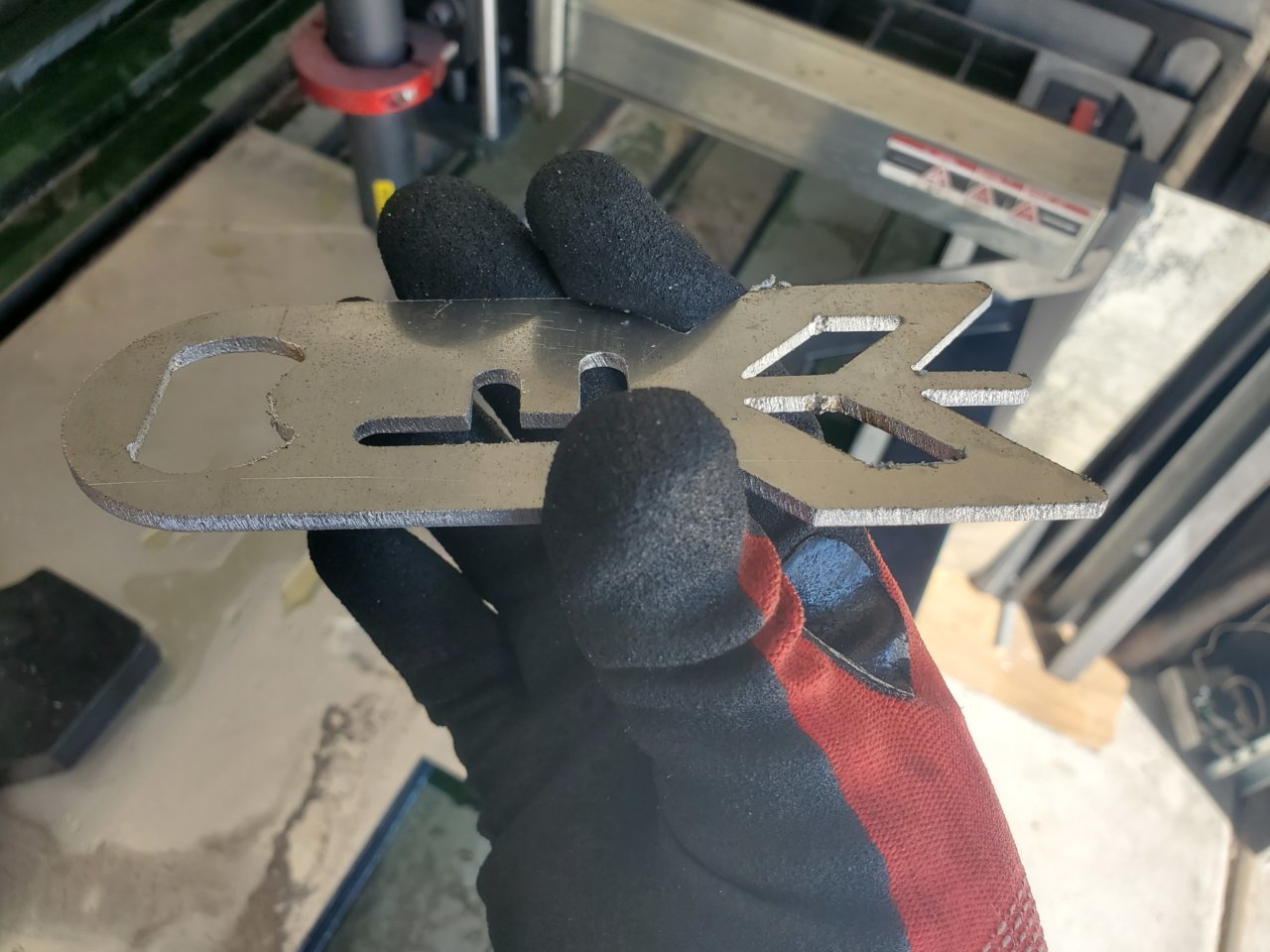

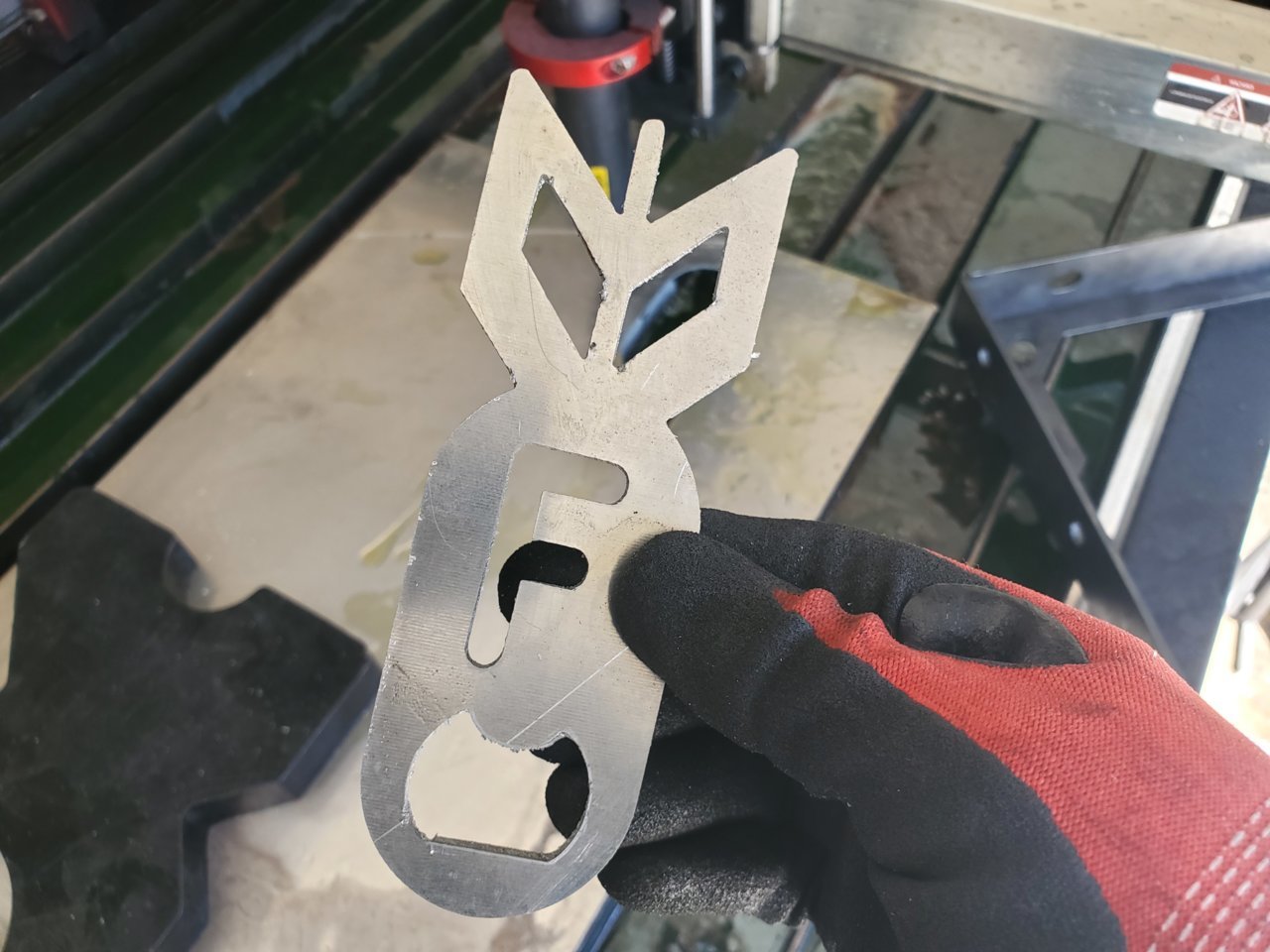

    Also got this done for another member
    No clean-up has been done, right off the table

    Yeah 6061 wouldn't bend well at all. 5053 should bend a few times but I think that tab as a bottle opener would probably part ways kinda fast. Certainly cuts nice though

    Oh for sure; I hate drawing on the laptop so I took an already-small file and just adjusted my cut speeds (100ipm)
    It needed to be small cause when Ryan was here, I was running my table quite a bit. Sofia even got to watch while she wore shade 7 goggles :rofl: anyway, I had a failed cut and didn't want to zero my table if I had cut a larger profile
    I feel like once I've got speeds dialed in, I could give it a shot at trying to cut stuff in aluminum so I don't have to prep/paint. Some dude cut a battery bracket/holder recently and it came out really nice.
    @treyus30 originally wanted aluminum, but instead decided on steel cause I told him I'm not confident in cutting aluminum. However, I might try his project on aluminum as an "extra".

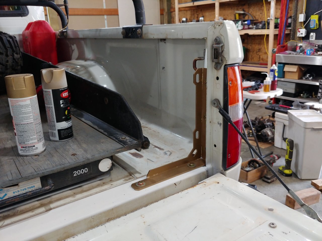

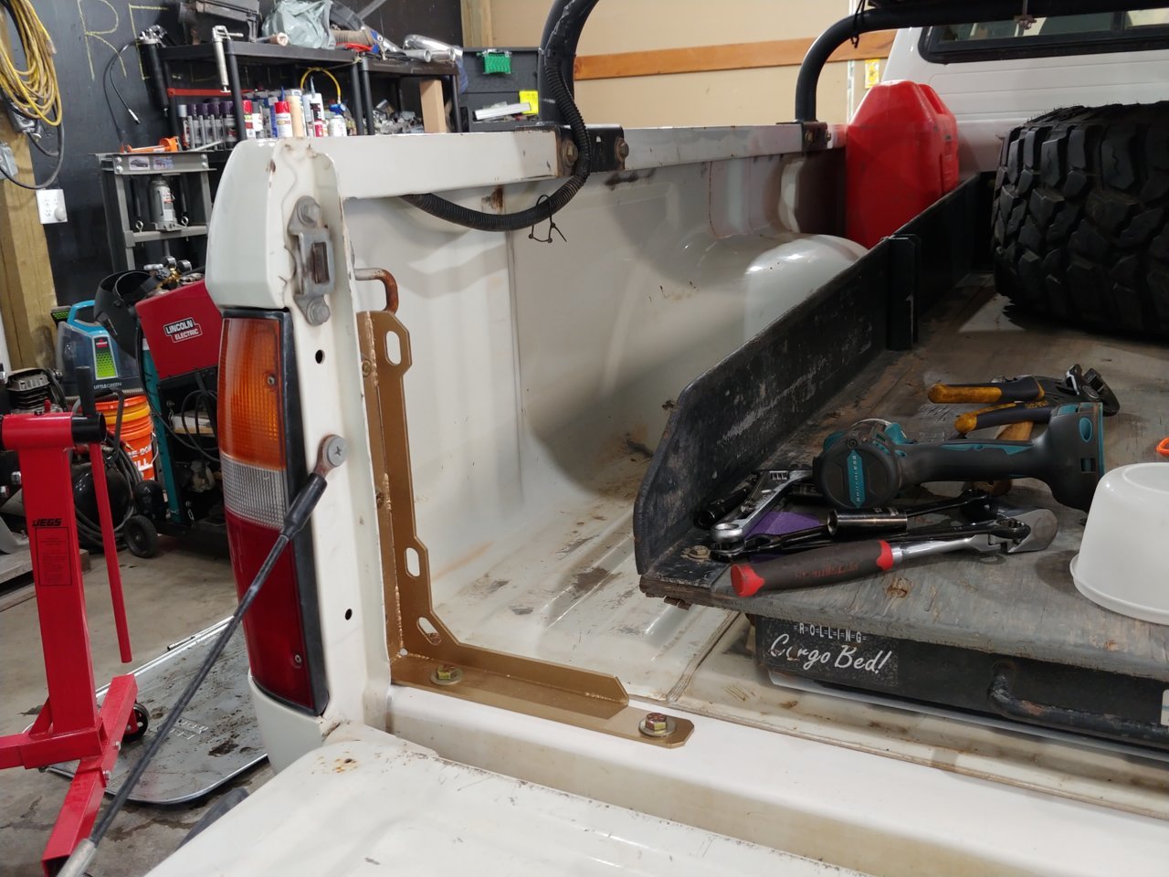

  16. Sep 4, 2023 at 5:29 PM
    Kwikvette
    Feb 27, 2019
    #284735
    82,202
    Fresno County
    4 run, 2 don't
    Bro, it's only 828 over there
    Taco critter likes this.
  17. Sep 4, 2023 at 5:29 PM
    Speedytech7
    Feb 20, 2014
    #123587
    58,317
    FCQM+VG Cheney, Washington

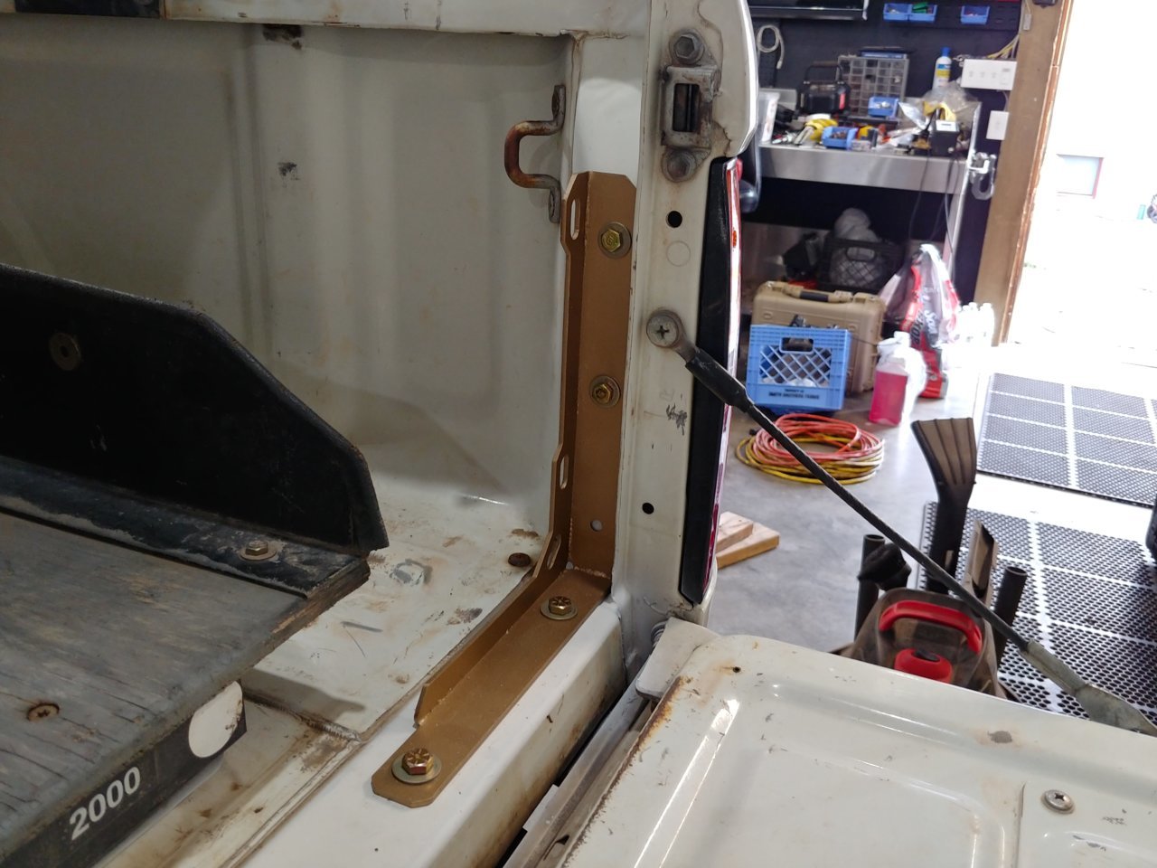

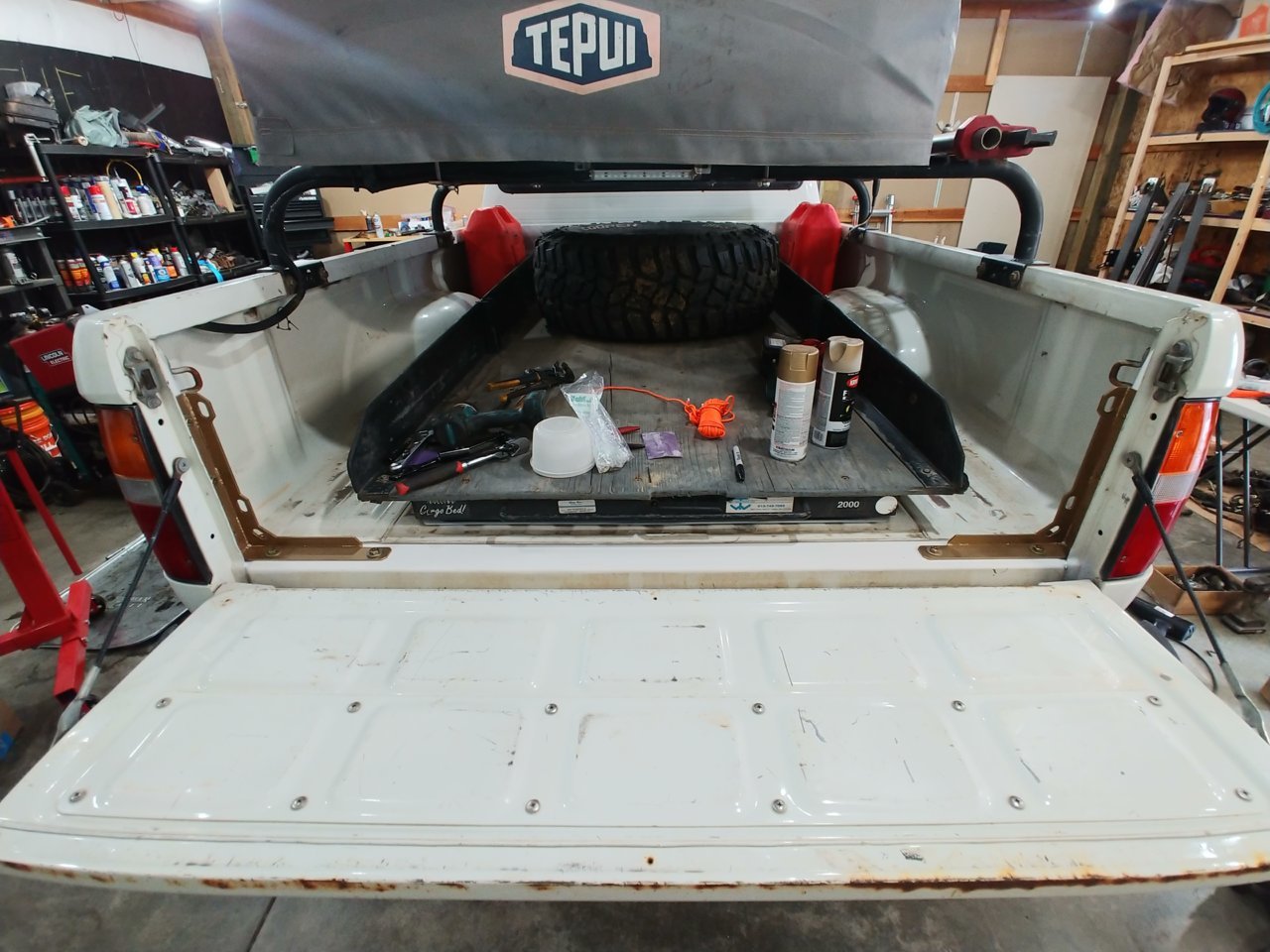

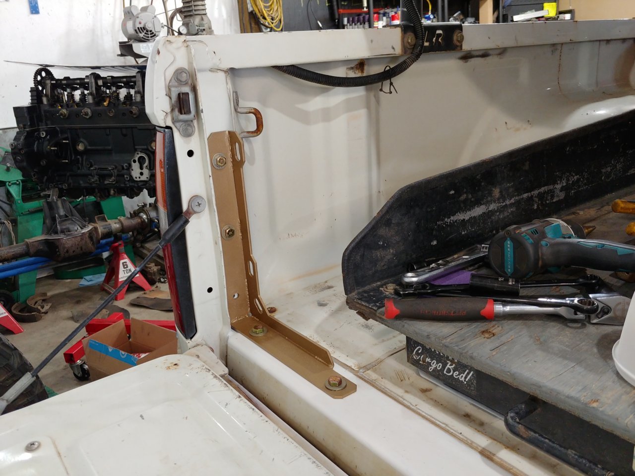

    Thanks again @Kwikvette
    They fit well but the bottom hole on the tail light side is occluded by a brace in the bedside, could move all three holes up a bit or just use the top two. The top two alone is likely plenty enough.

    Absolutely!
    Yeah I'll do that then
    Some trucks use that 3rd hole, and you and one person didn't
    You think a small bracket on the backside and/or under the bed would add any additional support
    Another member was asking and I only had a chance to check out the clearance from behind the tail light
    Was wondering if I should even bother as really it'd just act like a "large washer" tying in the top two holes
