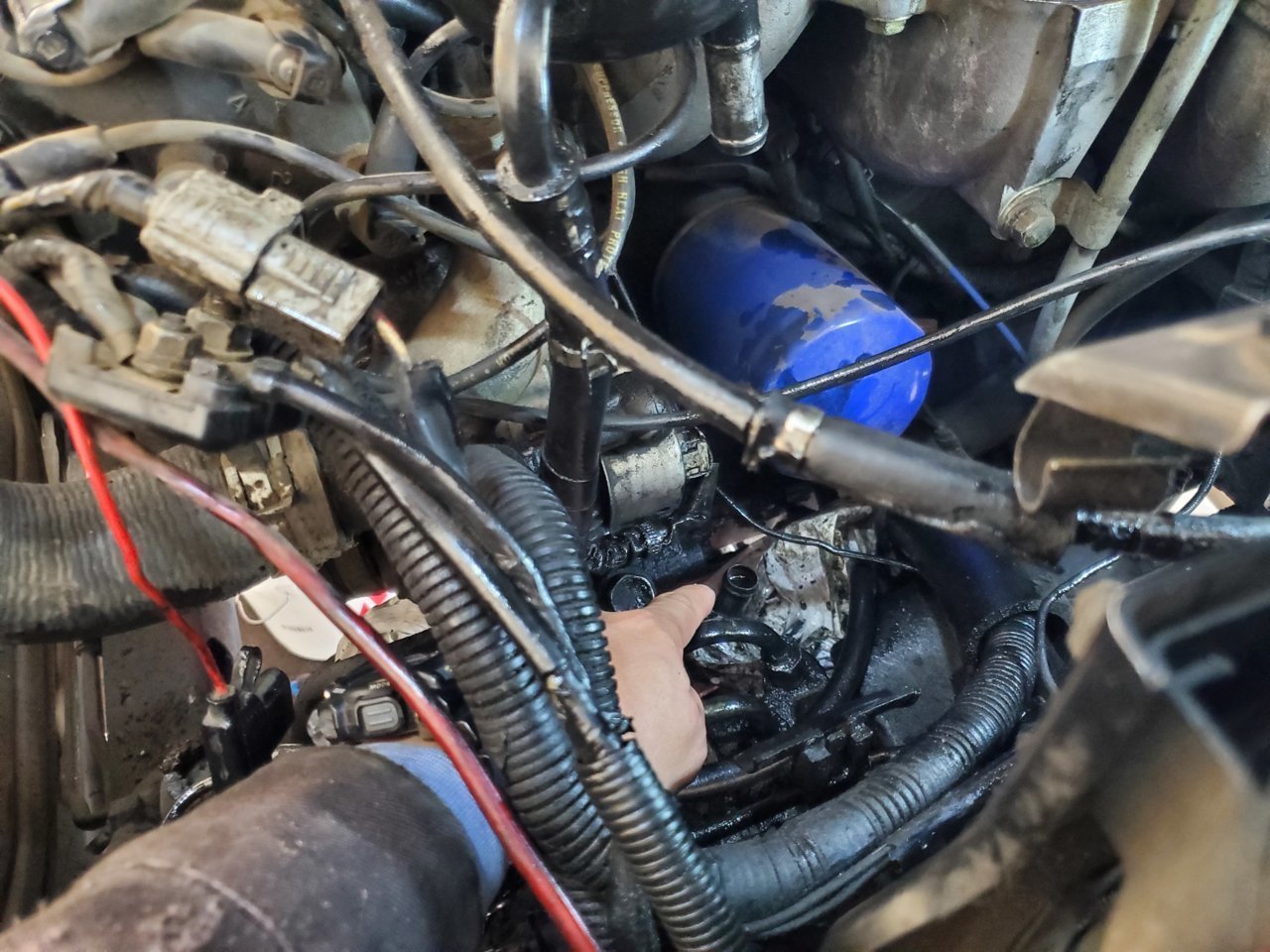

    @Ozark_RegCab
    Had to dig through my old thread but here you'll see the cluster fuck of leaks and wires in the way right above the pump after yanking the battery out
    Even then, steering pump comes out from underneath after removing the steering damper
