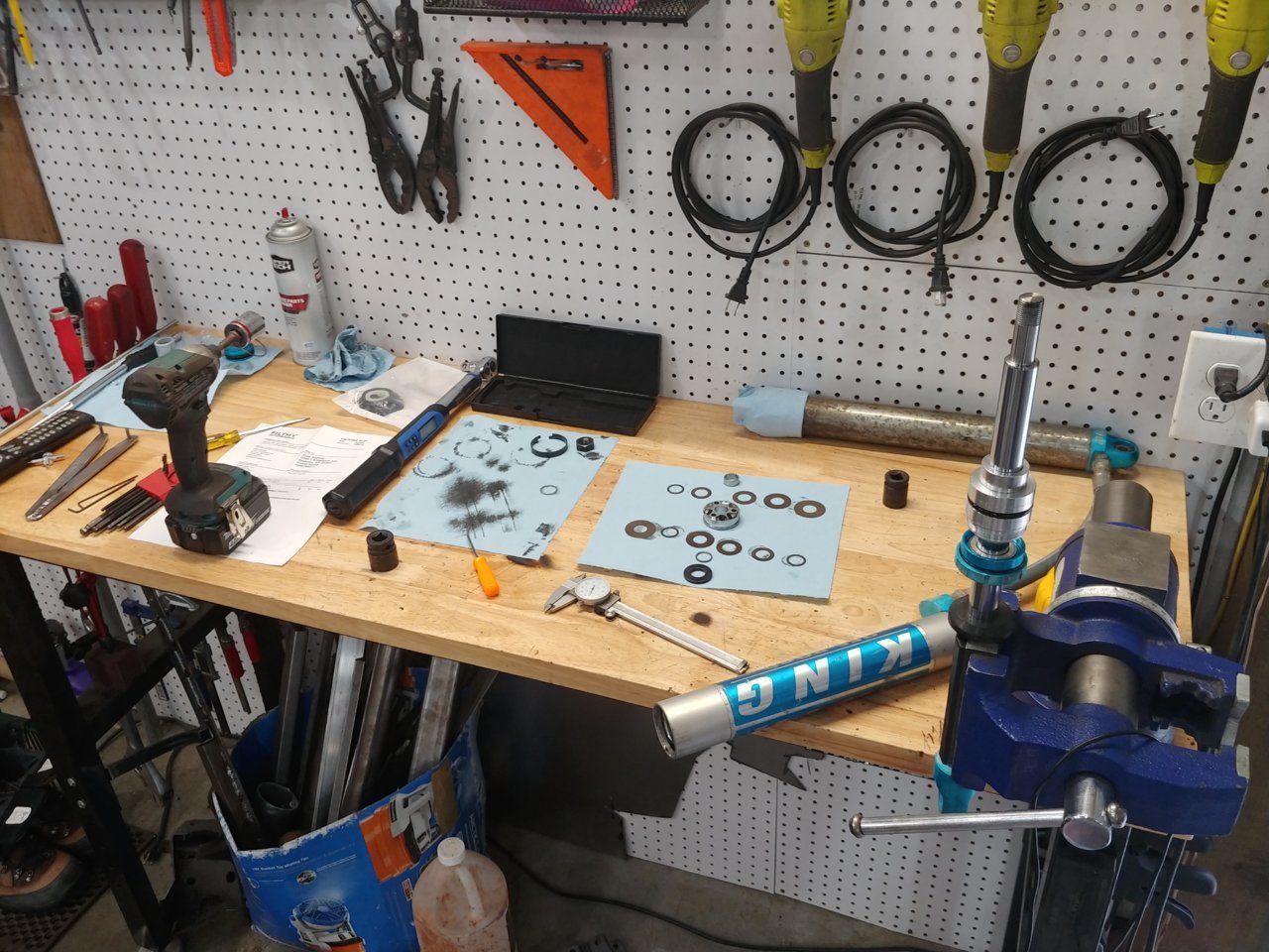

    Sweet, I didn't know that. I'm trying to figure out what the hell this existing valving is supposed to be

    Can you measure the individual shims, the shim total take a picture and email king. They may be able to tell you.

    Oh, I measured them all it's just a really weird compression stack and and a pretty standard rebound stack. I bought these used so I was trying to figure out how the hell they were used that this valving is what they ended up with.

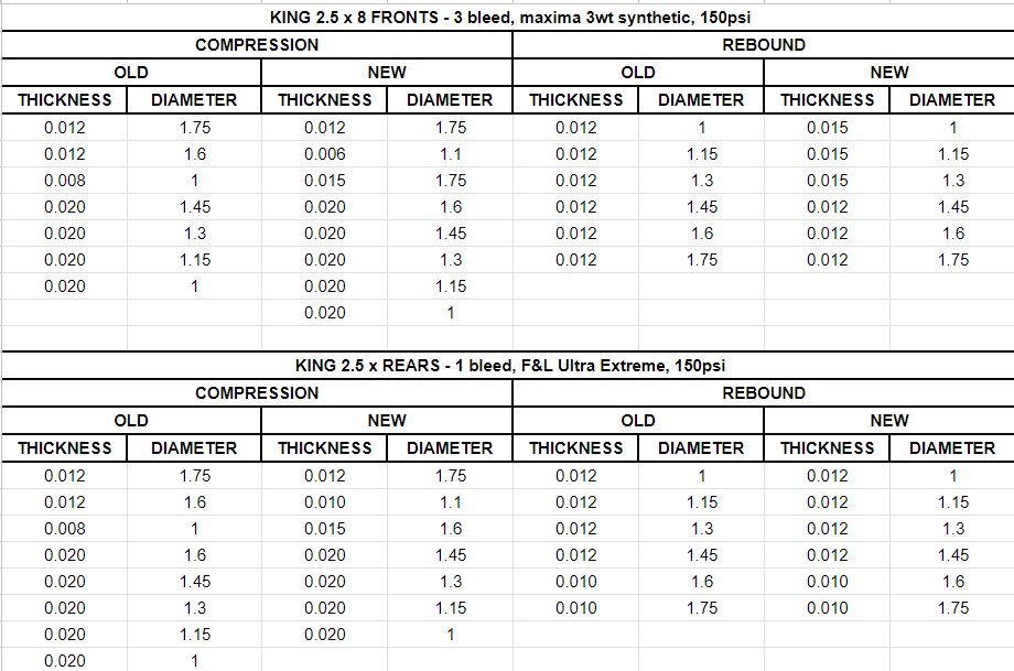

    If it helps at all this is what was in my kings. 2.5s and yours look like 2.0s it would be different but maybe you can take something from it. seems like they put flutters in most of their stuff from factory

    @JTFisherman So this is what I had planned for my truck, its always been just a little bit soft to me. I always have the compression adjuster maxed out but I don't have much for shims on hand just some .015...

    This is also a possibility with what I have on hand. Crawlpedia says doubled up shims are additive but not linearly so that last part of the stack should be stiffer than a .015 shim but not as stiff as a .020.
