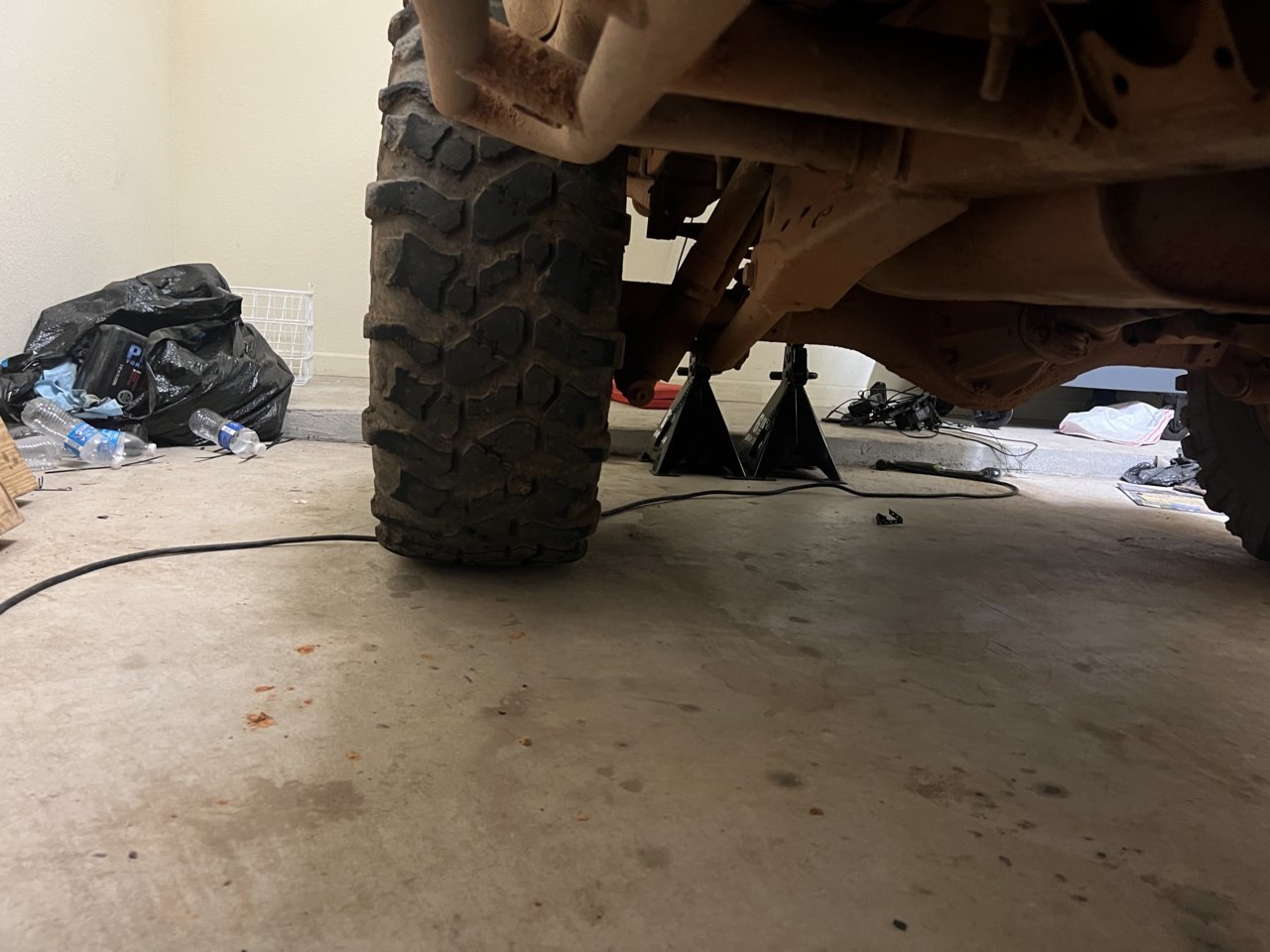

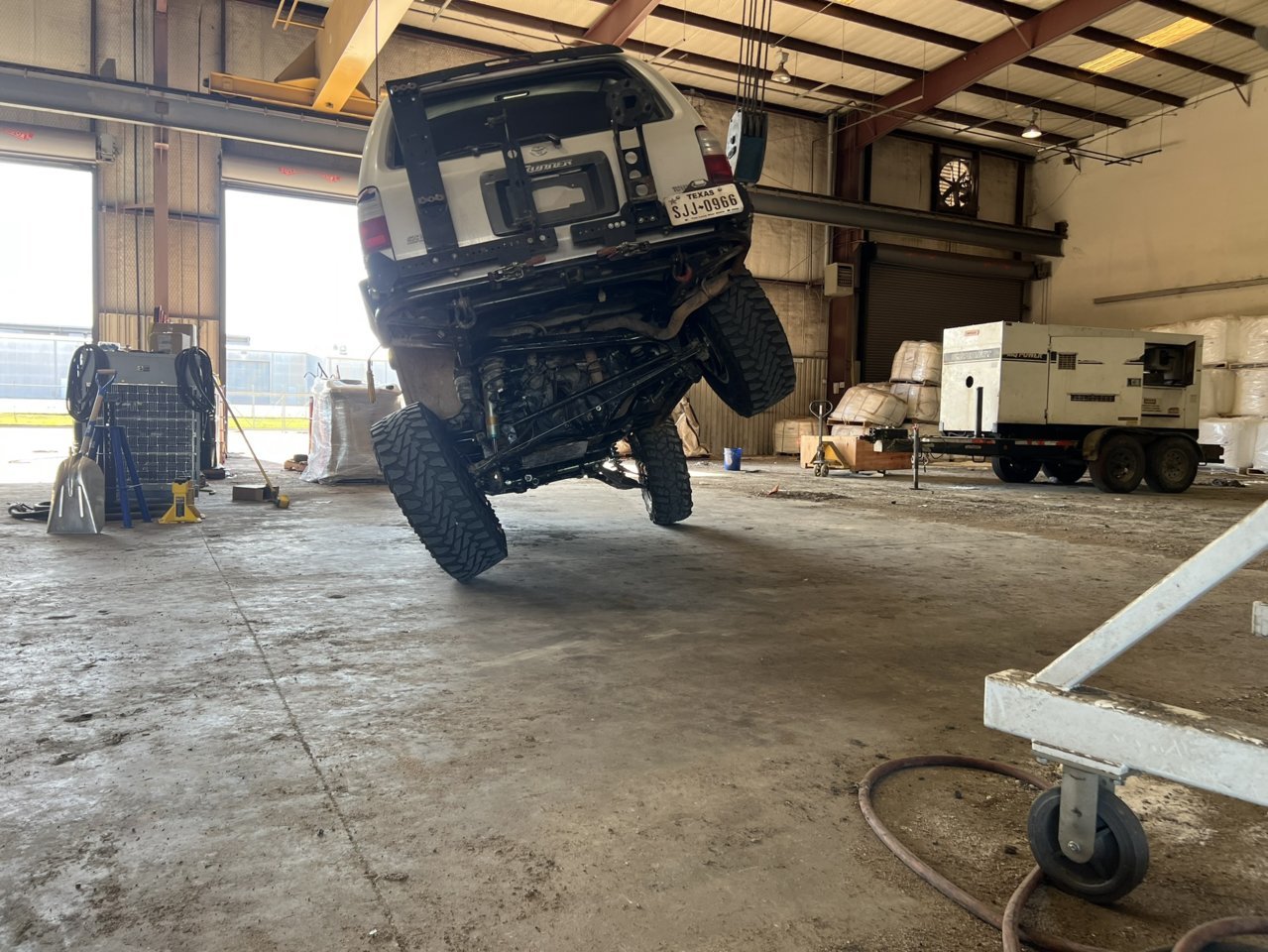

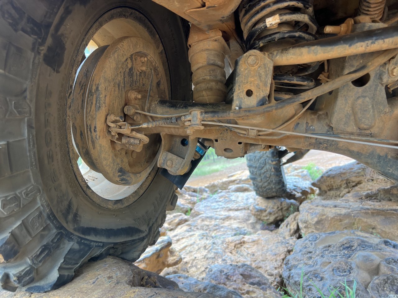

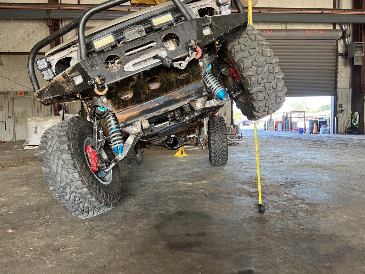

    @Speedytech7 Forgot I covered up the shocks with rubber to protect the shafts from rocks so the pics are kinda bad. You can at least see mounting angles. Didn’t want to crawl around and get dirty so there are some old ones in here too. Also put on some soft shaft bumps from shockseals.com and I really like them.
    Flexed out yesterday. Shows it cleaner and the shaft bumper00AD83FC-C454-4672-9578-4C7406A88666.jpg

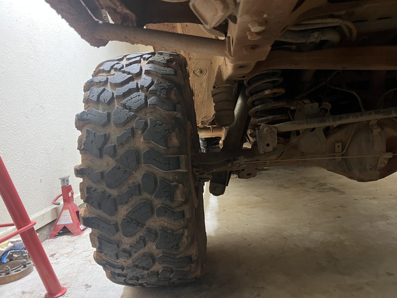

    Old pics you can kinda see angles on suspension travel.3DE54835-A7BB-4C43-BBEE-5D7A05EA0099.jpg

    You replace the upper link mount locations?
    They're literally vertical if you're flexing even shy of that as they're short AF.

    All stock mounting locations. They get steep but it hasn't caused issues for me in a year and @theesotericone had it for a long time before that without issues I would relate to the upper length.
    I do wonder how much the sort upper and lower rear arms contribute to it being hard to control at higher speeds off-road from bump steer but maybe I just need tacoma for fast stuff. This is a crawler anyways I just like going fast too.

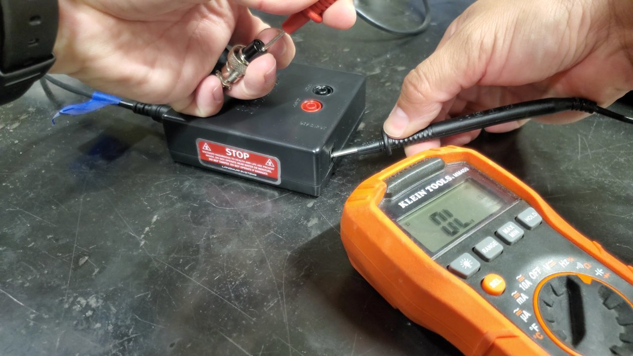

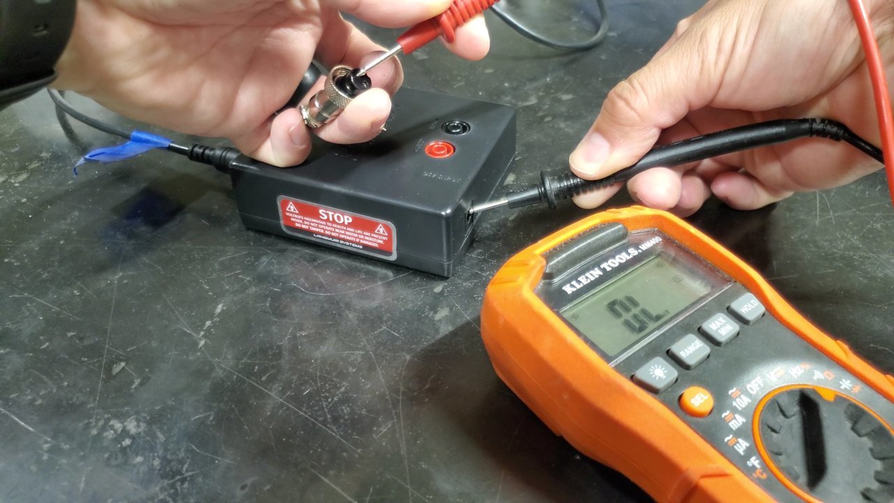

    You little fucker
    Going raw voltage next time around

    It's a through hole component, bust out the old soldering iron you can replace that lickety split

    Oh for sure, in fact I'd want holco resistors all throughout whatever circuit I'd be using
    The raw side looks unscathed so I could still use the box, just going to have a new one sent out while I repair this one and keep as a backup

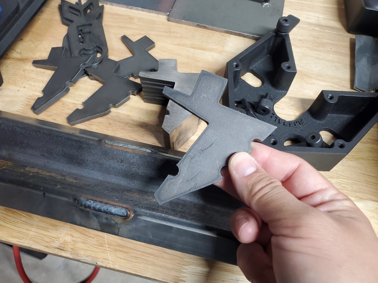

    Just sucks I make a bottom die, not to mention I even cut myself out some more gooseneck dies, only to have this shit go down

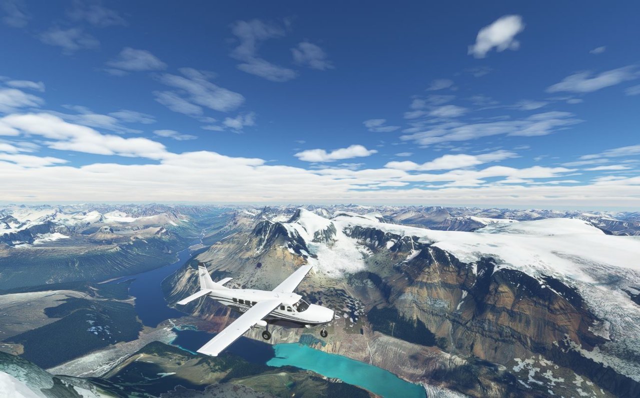

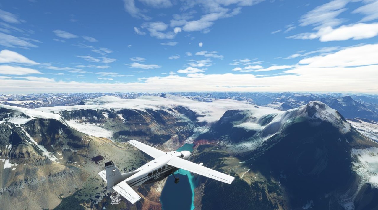

    I am so thankful that the sit I build today doesn't have that ancient bullshit on it.
    You wanted a video of bigger planes..
    https://youtu.be/HUJOTbfccSM?si=ODYTk00zHIqACVE9
    Also i flew the back country Canadian Rockies, was pretty rad!

    Dude :rofl::rofl::rofl::rofl:
    Few things, check list is on point :fistbump: and the music lol
    Damn though I am surprised you don't have more peripherals! Just engaging those switches, magneto start, priming your pump, all that....I've added several of those and do the same on my throttle for the Cessna just cause it's fun
    Other thing I was going to say is, during take off I noticed you were using your rudder quite a bit. Were you countering the forces of the engines? Seems like you were countering it by steering right.
  17. Sep 17, 2023 at 10:31 PM
    m3bassman
    m3bassman Well-Known Member
    Jan 16, 2011
    #49376
    17,138
    Green truck
    I had to find that copyright free phonk. Usually have some youtube music playing though, hence the ad on approach LOL
    A lot of aircraft dont need the extra stuff, my setup has few buttons to optimize for the wide variety of planes. I should do a cessna one fpr fun. Plane is super simple control wise.
    As far as rudder, that tail dragger requires the least of them. I barely had to counter the engine torque. That plane, because its old also has shit brakes so you can see my struggle to stop the damn thing in the grass on landing.

    I had one of the connectors on the inside of mine break, popped it open and its an easy fix.
