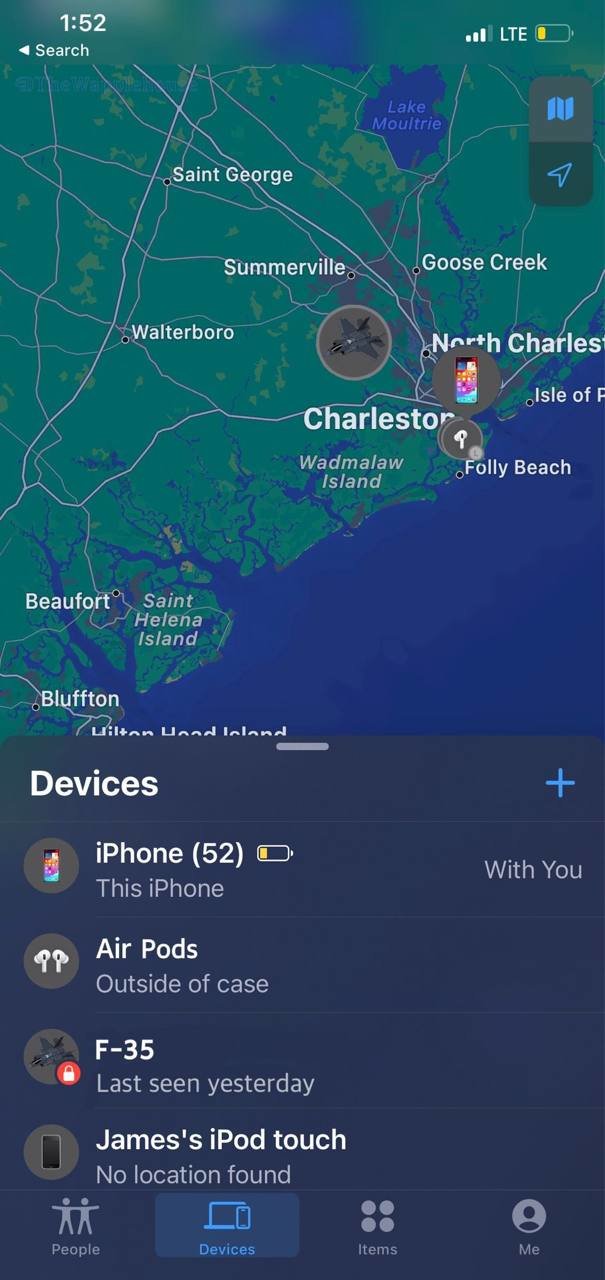

    eon_blue
    Mar 4, 2016
    #180213
    70,120
    Azusa, CA
    you'd think they'd put some kind of tracker on these things...
    they found and pulled an SR-71 out of the bottom of the South China Sea in 1989 after it crashed, you'd think they could find an F-35 in our own backyard lol.
    I wonder if finders keepers would apply here
