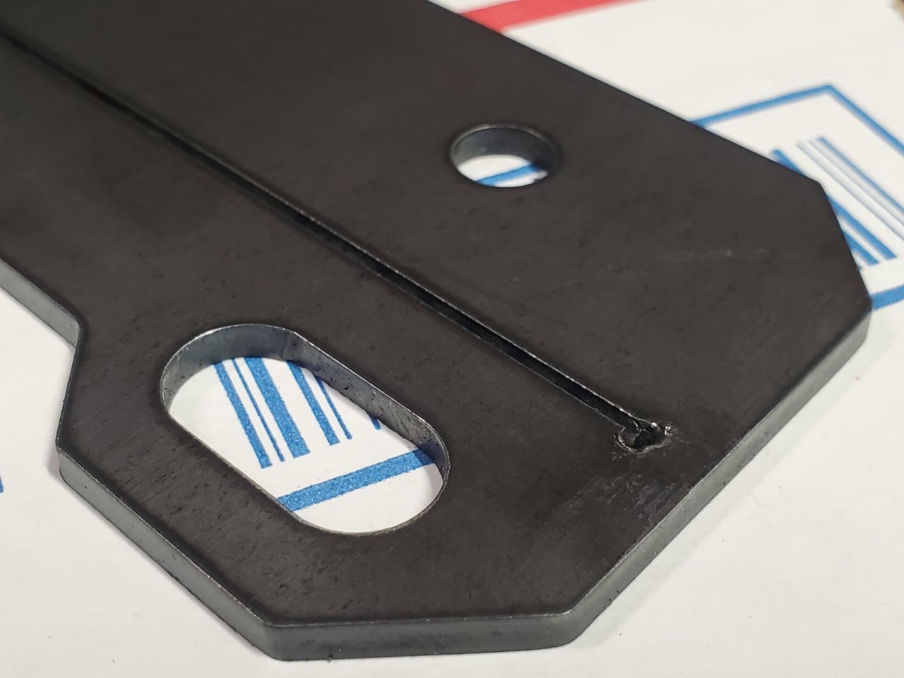

    4 run, 2 don't
    Super easy to do

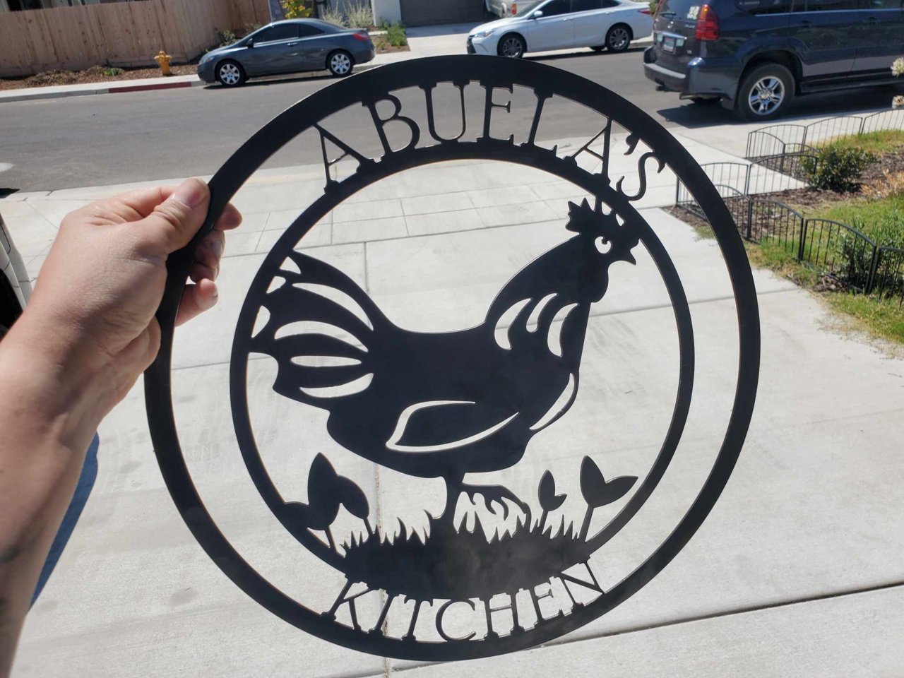

    I'm sure you've had your table longer than I've had mine
    I cut 10 gauge, 12 gauge, 1/8", 3/16", and 1/4" on it all successfully
    The little dross it had just came off with my finger

    I am mostly cutting 1/8" steel materials
    I really do need to do something similar to what you are doing and market/sell all the nifty bits I make

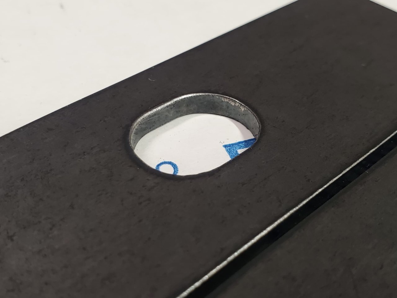

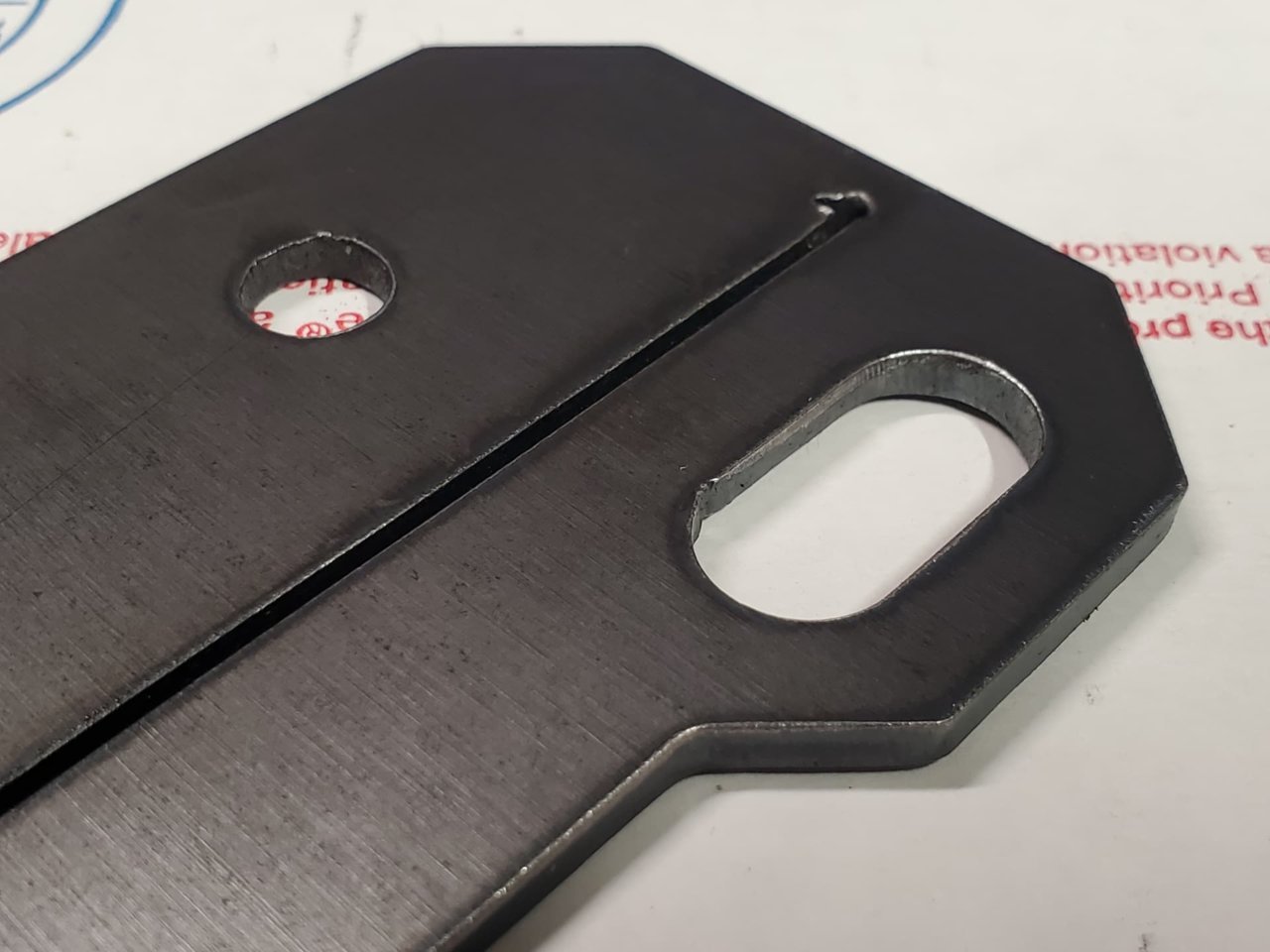

    Also at 1/8" you want to be closer to about 65 ipm, 34 amps, and 0.8 second pierce delay
    Moving too slow will cause hardened dross on the back side not to mention you'll eat up consumables even faster

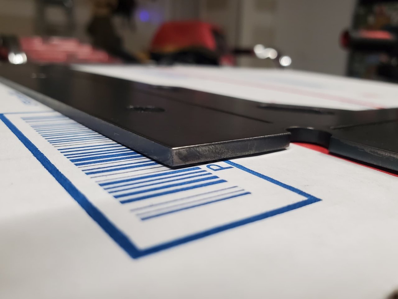

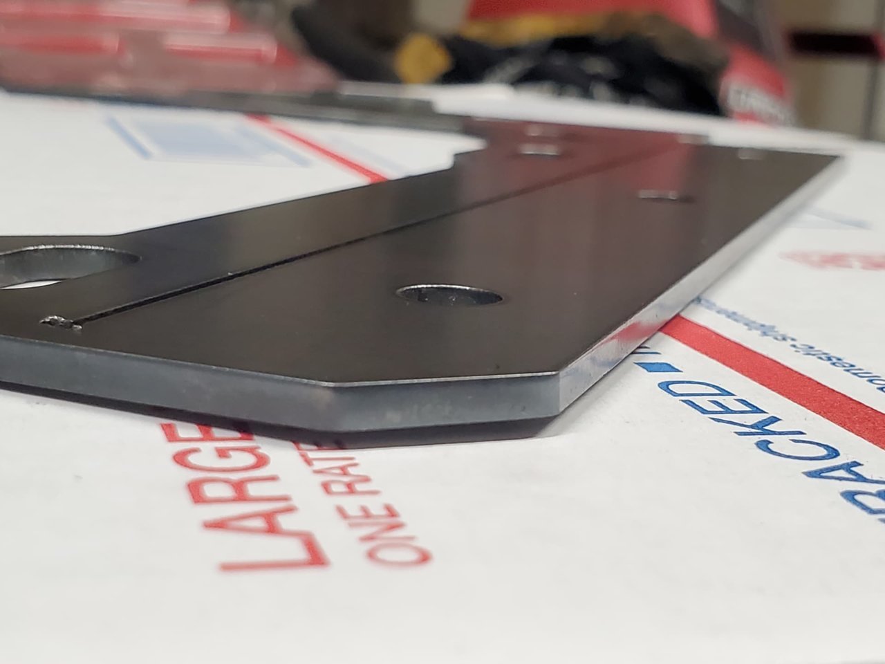

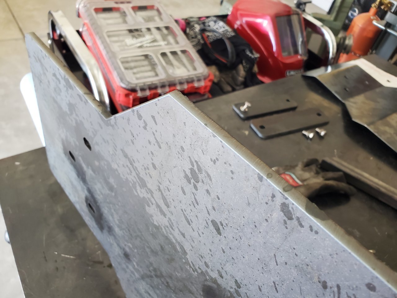

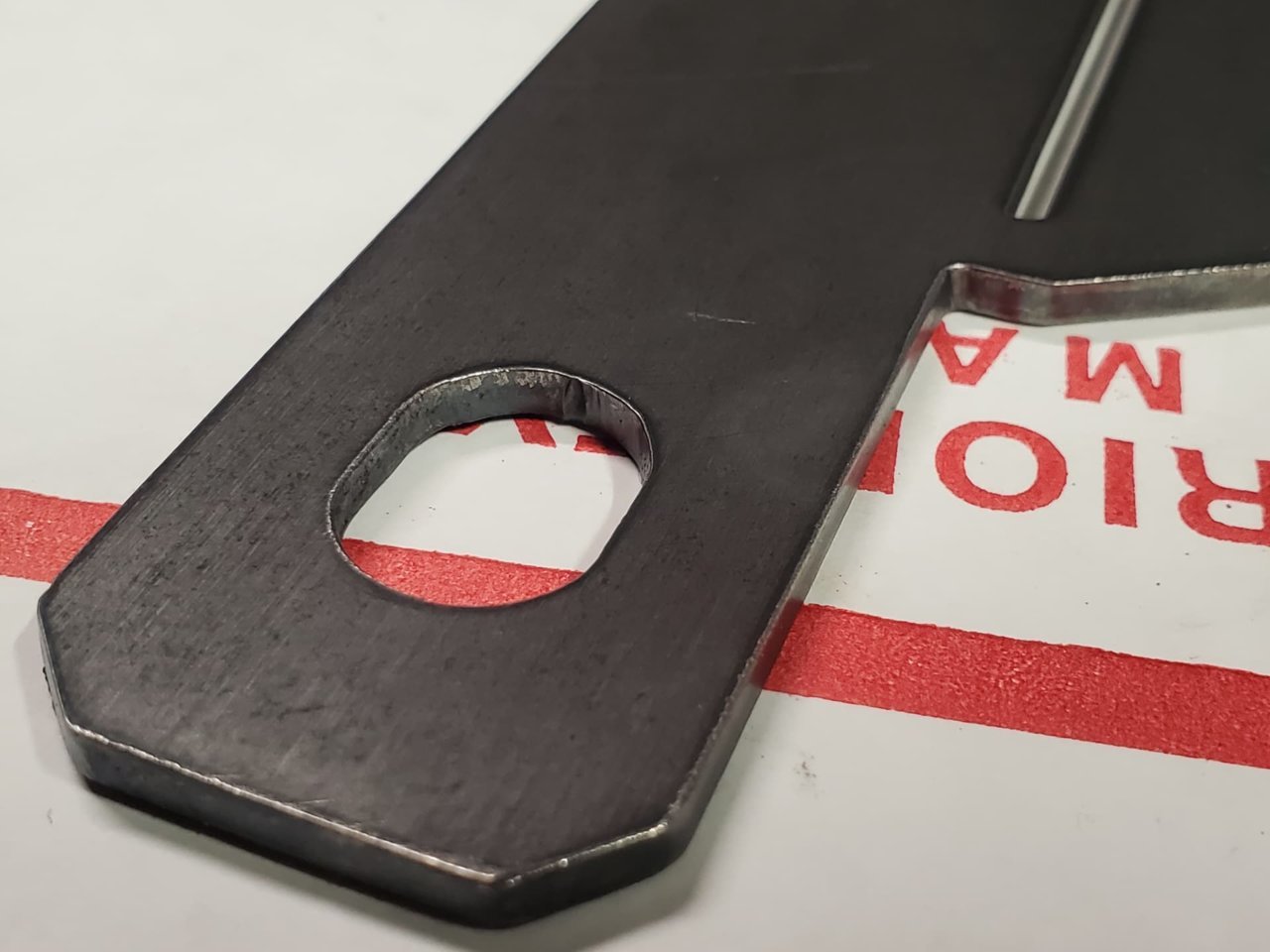

    It's the best thing when you can pull up a part you just cut right off the table and have no dross at all
    This was literally right off the table and was still dripping from the water table
    I do get some hard dross on 16 gauge, but that's because I cut too slow on it at 90ipm
    Some people cut 16 gauge at 150ipm and another dude even posted 200ipm so I'll have to experiment later; here's a 16 gauge piece I cut
    Did have to run the wire wheel on an angle grinder a little bit on the backside but not for long
