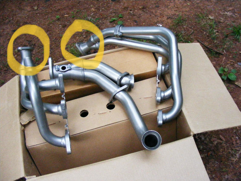

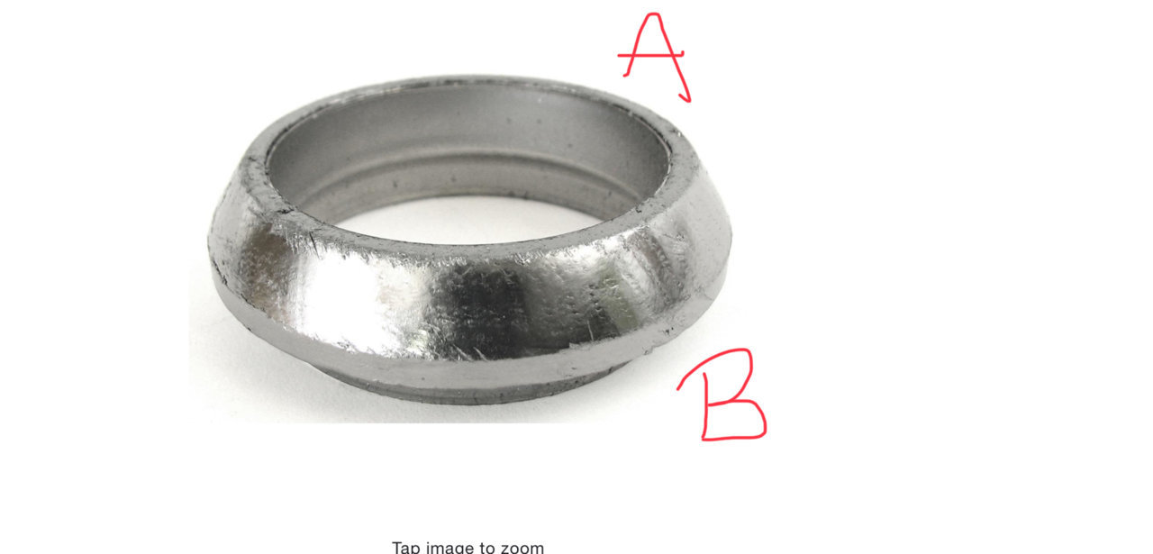

    I removed my TRD headers to coat them with hi temp paint, and change out the donut gaskets when I replaced my clutch. Having the transmission out made it super easy. Removing the transmission helps with the crossover pipe, but otherwise, installing right and left bank shouldn’t be that difficult, even with the transmission installed.
    Also, not sure if this is where you struggled….but, side B of the donut gaskets gets pressed into the flanged ends, circled in yellow below. The metal lip on the gasket will seat into the stepped inner diameter and is held in place like an inner sleeve. This will firmly hold the donut gaskets in place while you install the crossover pipe. No worry about the gasket falling out while you adjust the position and tighten the hardware.
    For the driver side, you will to separate the 2 pieces and install and tighten the part of the header piping that connects to cylinder 4 and 6 first, then install the header pipe for cylinder 2.
    You should also use the metal OEM exhaust manifold gaskets. I used them when I first installed the headers over 20 years ago, and gave me no problems. Went with the OEM gaskets again this time around.
    What part of the install is giving you issues?
