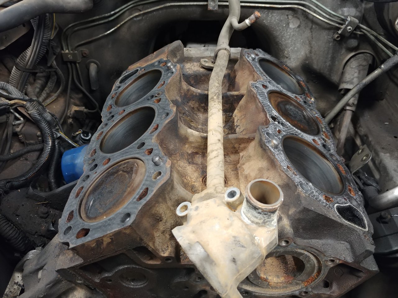

    ive always used brass wirewheels on blocks. never hurt anything. but i do it with no pistons or anything so i can make sure nothings shed into the engine.... for yours.. id use scotchbrite pads and wd40

    Wire wheeling Pistons tops is like one thing I know you can do haha. I just don't wanna have to fix a knick or something. If it was someone elses engine I know I could do it with a wire wheel and be fine but this bitch gotta hold boost.

    Scotch brite.......!!!!............?????????
    NEVER USE SCOTCHBRITE TO CLEAN UP GASKET SURFACES OF AN ENGINE.
    NEVER, EVER, EVER USE SCOTCHBRITE ON AN ENGINE. At least not one you want to run again for a long time.

    I'm well aware of that, hence why I don't use rolocs or scotchbright on anything I can't full washout afterwards
