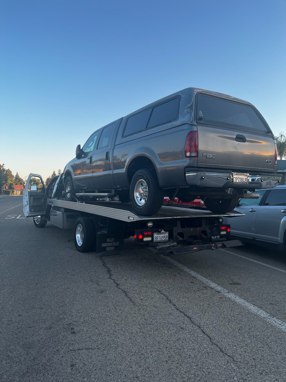

    Unfortunately this was before Ferd implemented those lay-flat-seats so I'll be broken down without comfort :pout:

    It's less Tacoma and more mod
    That's actually why these early models have beds, its not for moving cargo... they can't do that. It's just for sleeping quarters

    There's that experience I was looking for :luvya:
    Got like 3 OBD2 readers so looks like one will be for Ferd duty only; might as well leave it hooked up 24-7 amirite

    #1 reason to have one of those tuners haha, so you can de-tune the 6.0 enough to hold it together and so you can watch the coolant pressure for when the EGR or HG explodes.

    I'll have to dig out all my 6.0l stuff from memory. but there are some things you want to keep an eye on that tell you a lot about what's important
    Oil temp & Coolant temp -- if the spread is too far apart your oil cooler is clogged. You want to see them within 15 deg of each other
    FICM voltage -- if FICM fails truck will crank no start, usually voltage indicates health of it
    IPR percentage -- if the IPR percentage is out of a certain range you have a high pressure oil leak which is bad because the injectors are driven by HPO
    Kwikvette[QUOTED] likes this.

    Meh neither of those are really a concern on stock tuning. You absolutely cannot run any hot tunes without ARP head studs though

    Okay but can we agree he will have an HPOP failure

    I'm voting no on the HPOP itself but yes on a standpipe o ring or something lol
    Again, looking at the IPR percentage can tell you about it long before the truck leaves you stranded

    I've never seen the standpipe orings blow out. But I've seen an HPOP fail before, I'm not really sure how they go out it's just a vane pump but man the inside was wiped... like it had 800k on it. But it's a 6.0 so it had barely made it 80k. I'm sure some of the other orings can go too.
