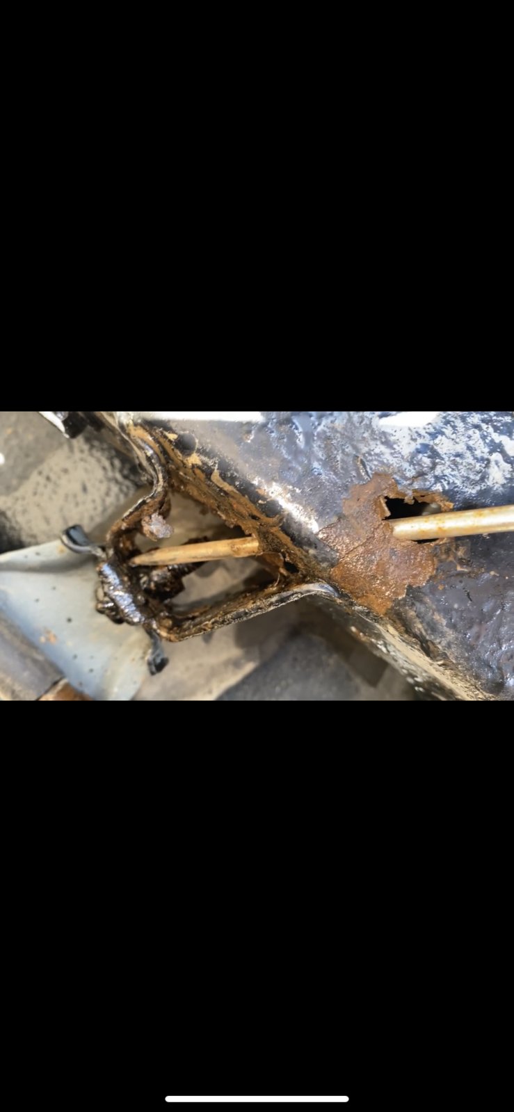

    I would order frame reinforcement plates and weld them over the outside. Probably add some angle to connect the inner channel of the frame but not box it to limit water trapping

    Is that what you’re referring to as frame reinforcements?
    I’m not sure what exactly you mean by adding “angle” to the inner frame
    is there any other way you could explain that?

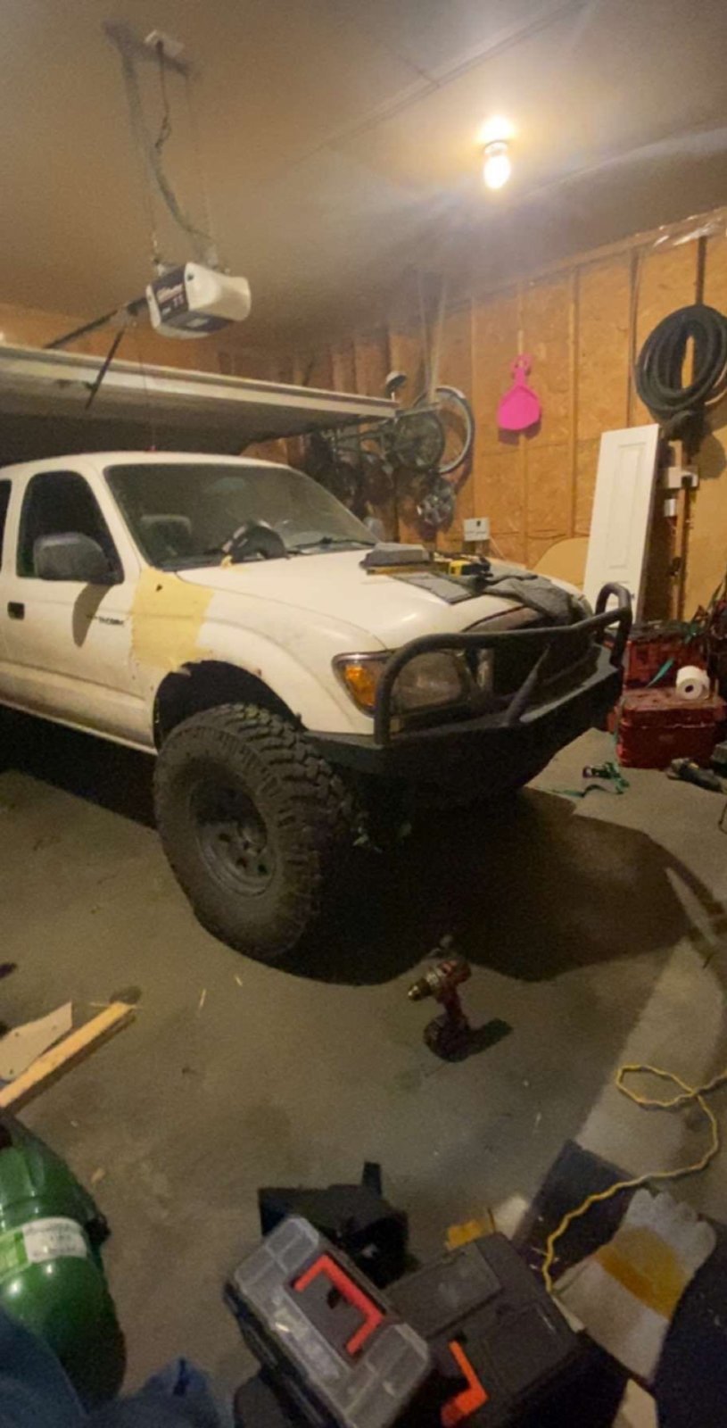

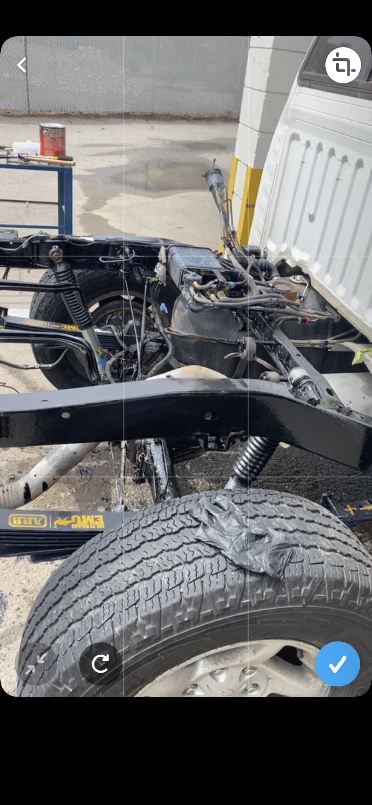

    Well, 1st and 3rd pic are useless as to what you're trying to get done.
    2nd pic is too close up, what part of the frame is that exactly?
    Wire wheel a shit ton in that general area, knock off whatever is rust, clean up whatever is actual metal, and weld reinforcement over it tying it into the frame.

    Looking closer, that's where your gas tank strap bolts in right?
    I'd hit that bracket and see if it's loose or if the surrounding metal is still good.
    If it's loose, cut it off and make a new one as it's just flat stock bent 4 different ways.

    Or would you saying buying the L shaped ones from safe t cap better?

    Safe T caps replace (and reinforce), the above plates reinforce
    Assess your frame as mentioned before buying anything

    nah I mean I would probably use some angle iron to reinforce the inside of the frame and build gas tank mount
  13. Oct 7, 2023 at 6:15 PM

    Buddy is doing a 63 leaf spring swap, welding in new leaf spring perches, redoing all underbed wiring, pulled the gas tank for a gas tank relocation, and more.
