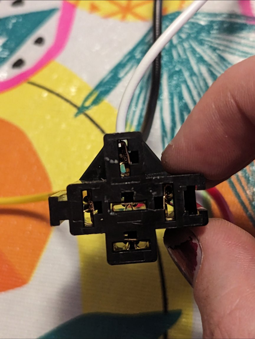

    Any tips for depinning this connector?
    I accidentally pulled the wire out of one of the pins while soldering the pigtail :bananadead:

    Should just be the little squares? Shove a tiny screw driver or something into it?
    Maybe you can push down on the back?

    hmmm yeah I have a depin tool but I haven't been able to pop it out by pressing on the tang in the little squares
    Maybe I'll try a screwdriver and more muscle next lol

    you were right
    It wasn't a spring tab like I thought so press and pull didn't work -- using a flathead screwdriver to bend the tab flat is all it took :)
