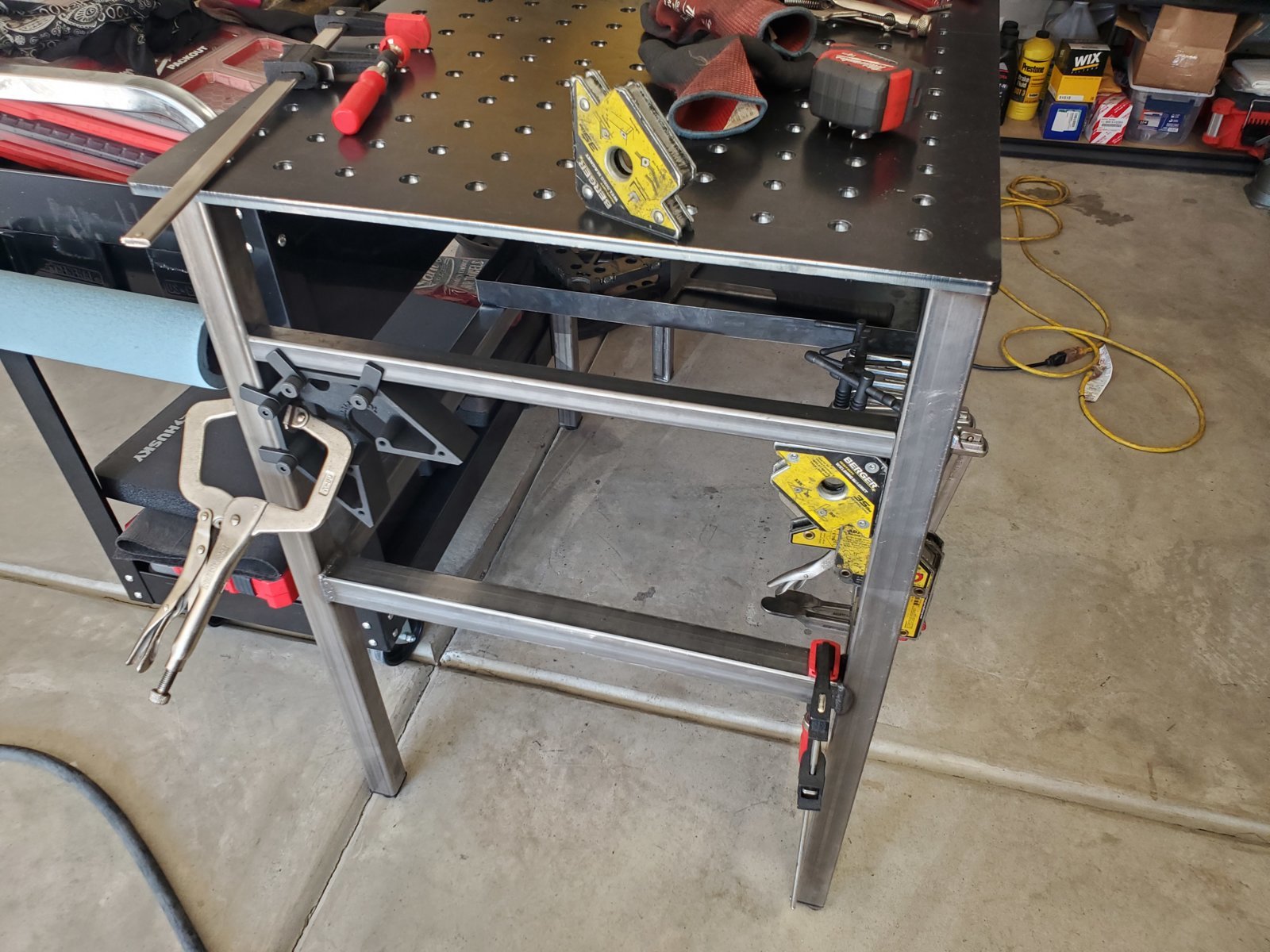

    And TIL that 3 of my 4 table legs are actually stainless :anonymous:
    What's surprising is that it welded just like mild, on 75/25 and I've only ever welded stainless with 98/2 or tri-mix.

    Stainless welds beautifully with mild filler, it just ruins the stainless properties near the weld, but 90% of the time that don't matter anyway

    I've welded with mild filler wire, but never on welding gas meant for mild steel but good to know
    I figured it'd be a heat/conductor thing so thanks for confirming
    And before you ask, yes both my buddy and I looked at it and even made a joke about "light" and "dark" steel (we're both military, so our minds went elsewhere :bananadead:)
    Anyway, it came about cause he sourced it new at a shop and brought up "why is it colored slightly lightly" cause really it's not bright like regular stainless
    Well, I took a magnet to it cause I'm about to weld a bar across for my angle grinder holder and I thought my magnet broke :rofl:

    Must decent grade stainless too if your magnet didn't even stick. I've welded a lot of exhausts with combos of mild steel and stainless steel. Mild wire and C25... it's always a pleasure, it welds better than just two pieces of mild I think.
