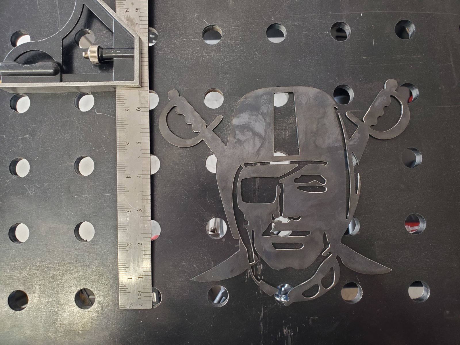

    I've got some 16 gauge left from the shelf I made myself yesterday, thinking I can get maybe 7-9 of them cut out
    $10/ea should hit the mark but since he's buying 10 unpainted, could make it $70 total I think

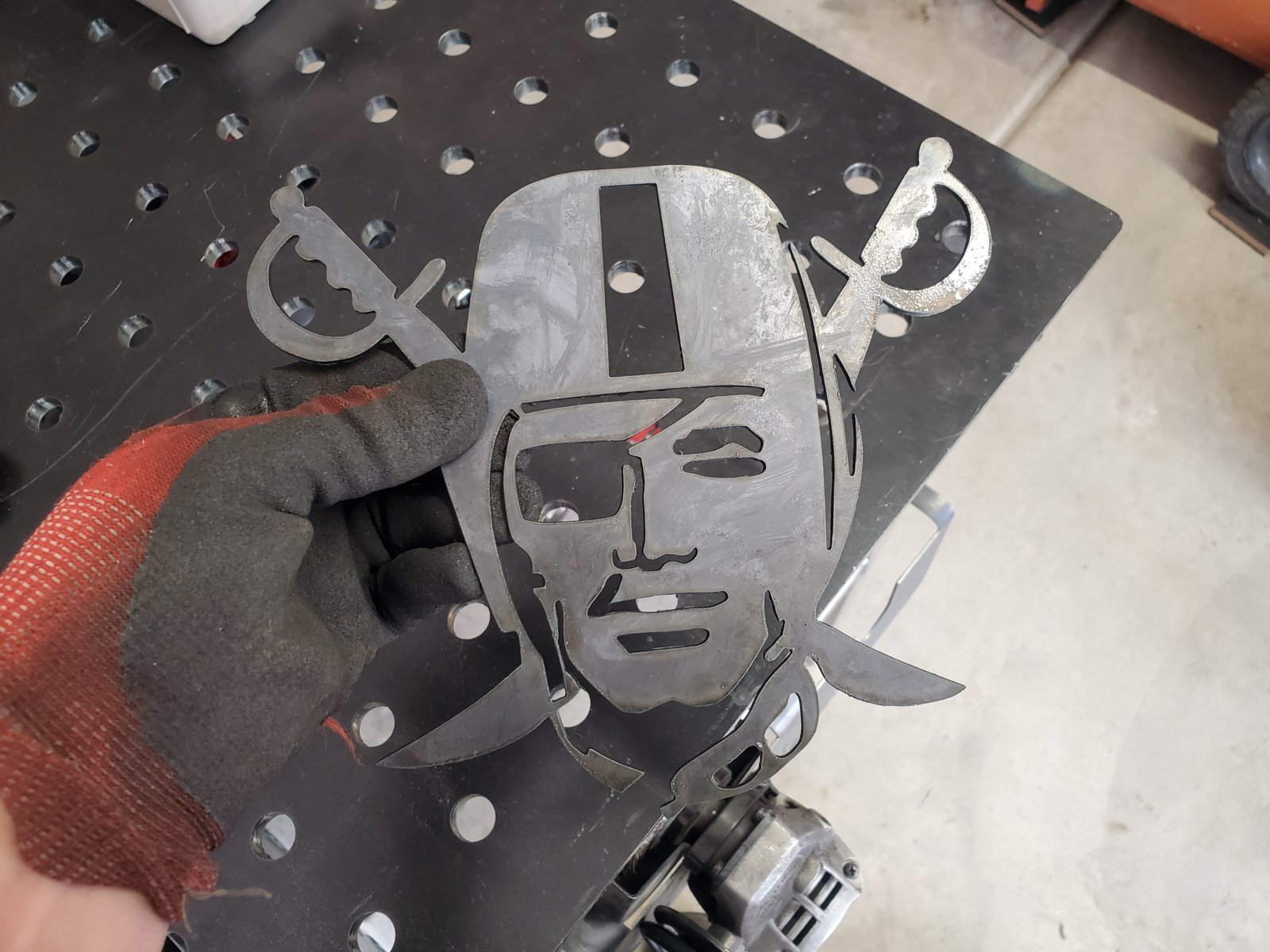

    Lol you're right about the teeth.
    I'm not a football fan either but I will say, I'm surprised at how well it came out :D

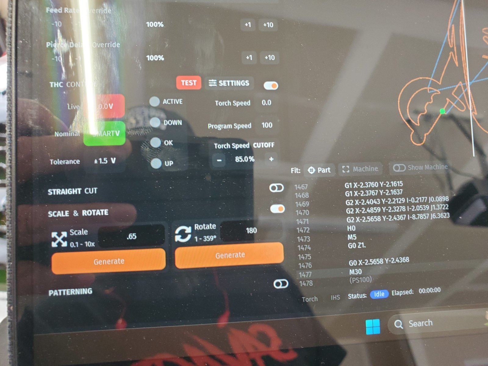

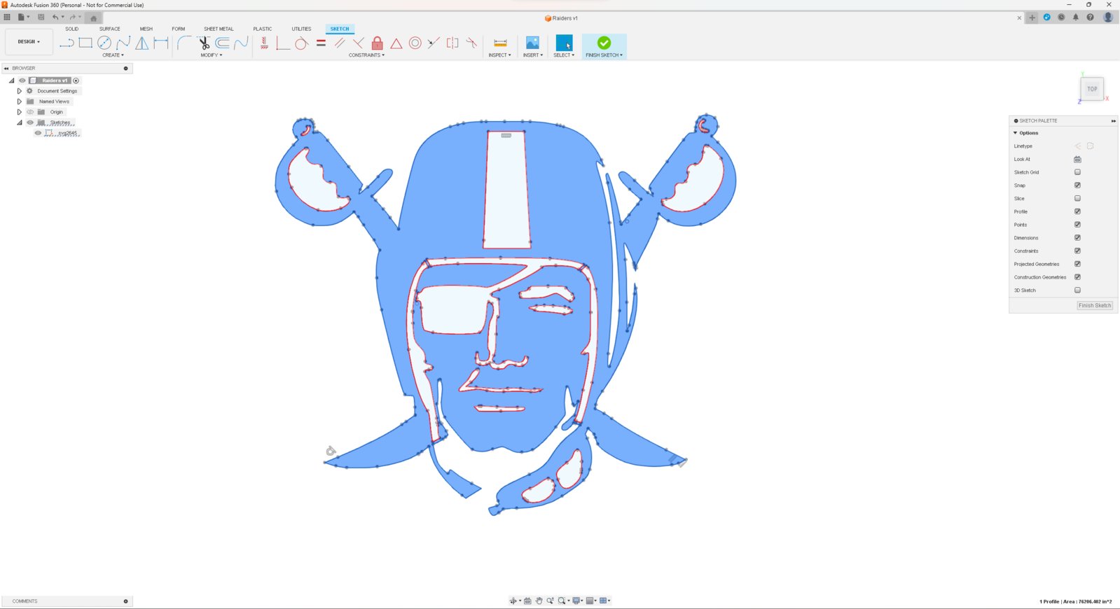

    Reason being is that I made the drawing to size at about 8" only to run into linking constraint issues - in other words the cuts were too close to each other and are disregarded.
    Messing with lead in distances and compensations combined with scaling up the drawing to 10.5" finally allowed me to create my profiles.
    But, I'm not making 10.5" sized cut outs so I got some scrap, and used my controller software to scale down to 0.65 -

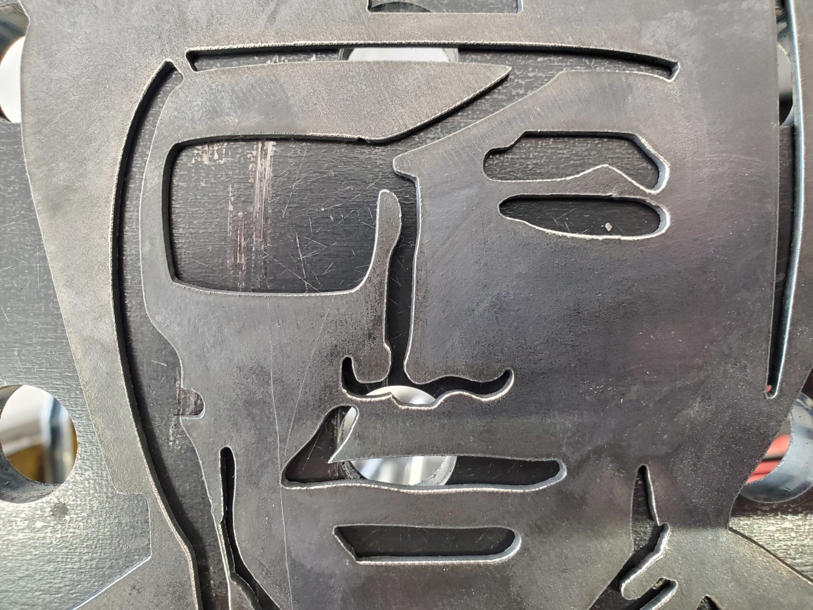

    The result -
    The best part?

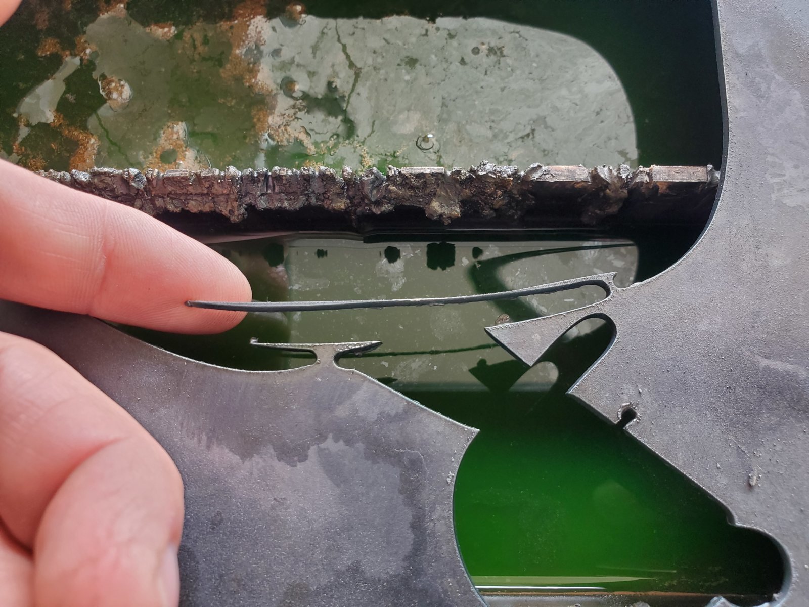

    Anyone that does CNC would critique one's lead ins, pierce delays, lead outs, and the sort but at this small of a scale you can't even see several of them -
    You'll see one at the top center of the eye, and one at the top right corner of the eyepatch and that's it. People cut larger parts and still have lead ins showing.
    Here's the left over between the small gaps -

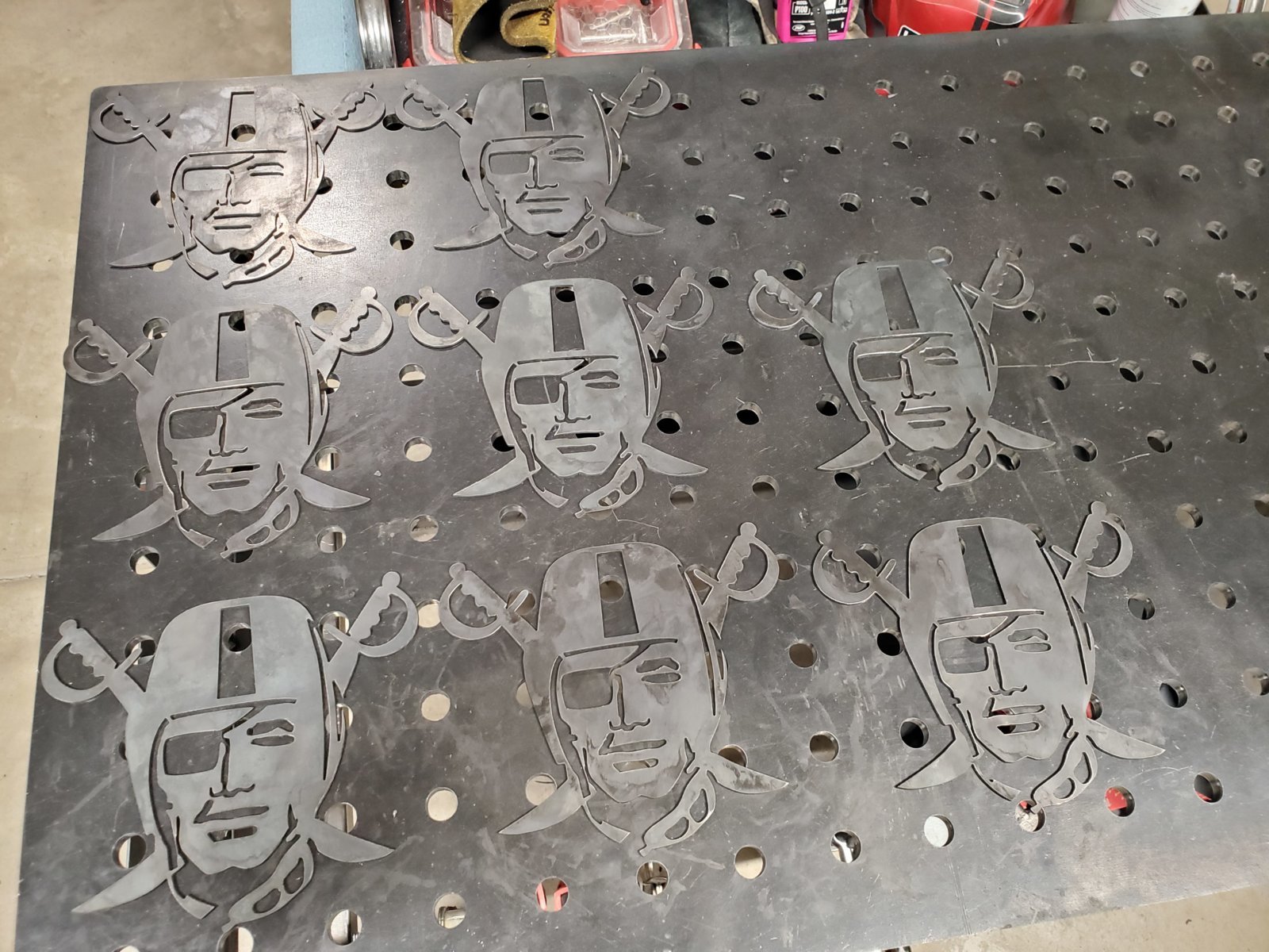

    And really this was supposed to just be a tool in my tool belt!
    Easy $100, told him I'd have them done by Wed/Thur since I'll have to buy some steel

    Love when customers are happy; need to buy $10 worth of 16 gauge tomorrow (2' x 2') but order is almost complete
    This was all cut from left overs
