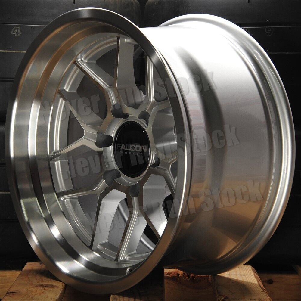

    I might need these for the Land Cruiser, get into some 17s and 35s

    these are so hawt

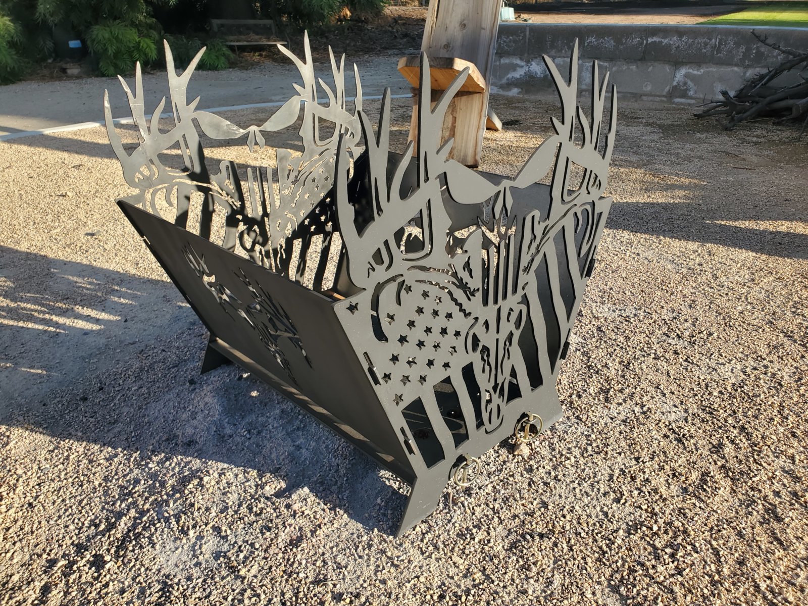

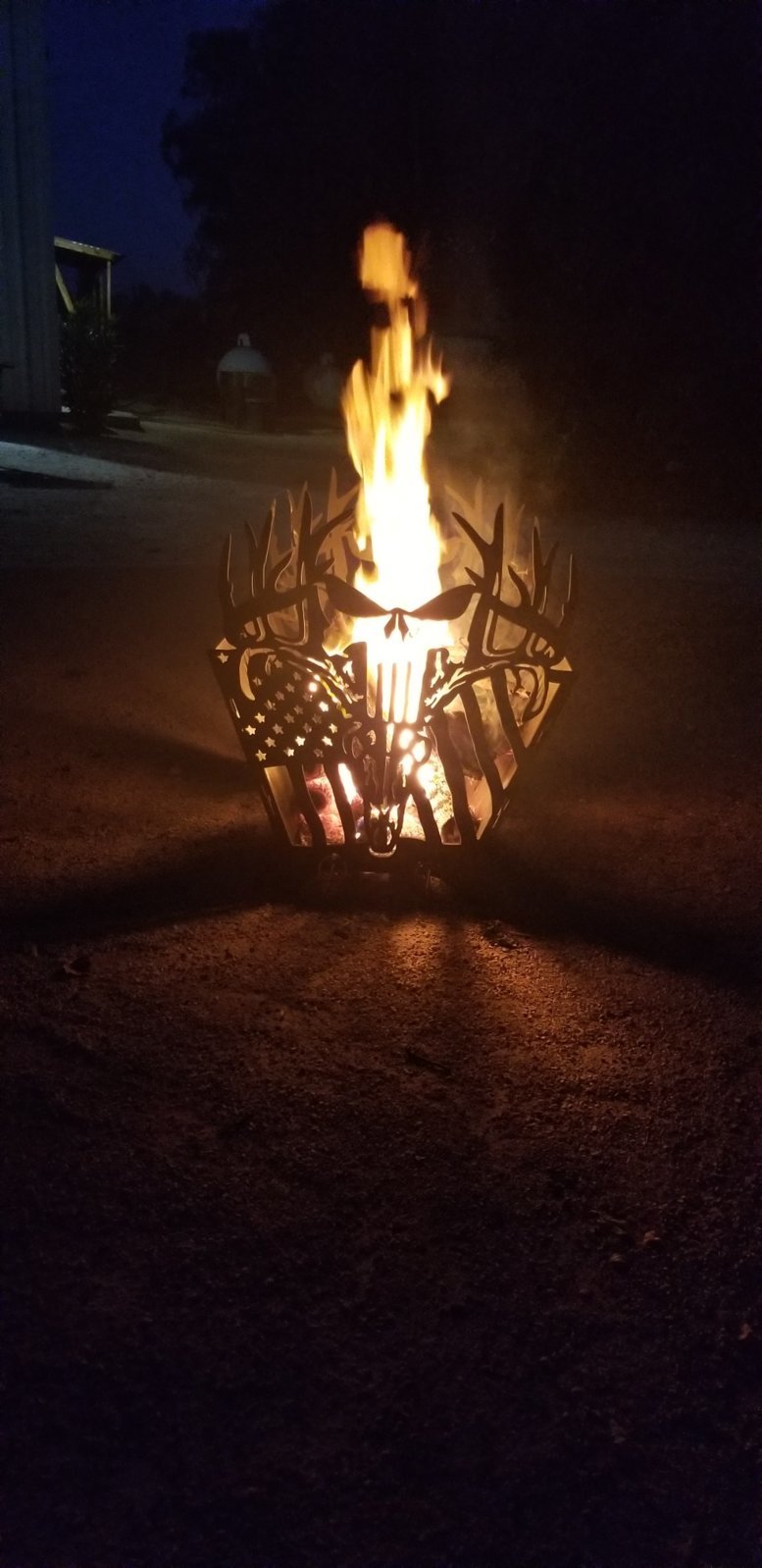

    He's been making and selling these; nets 2 pits per 4' x 4' sheet of 10 gauge and says sometimes he'll get beveling due to the torch not sitting identical to how it was on the cuts prior -
    The machine torch mount allows one to change consumables without ever dismounting the torch.
    Then again if you're not cutting often, there's no real benefit to having a machine torch.

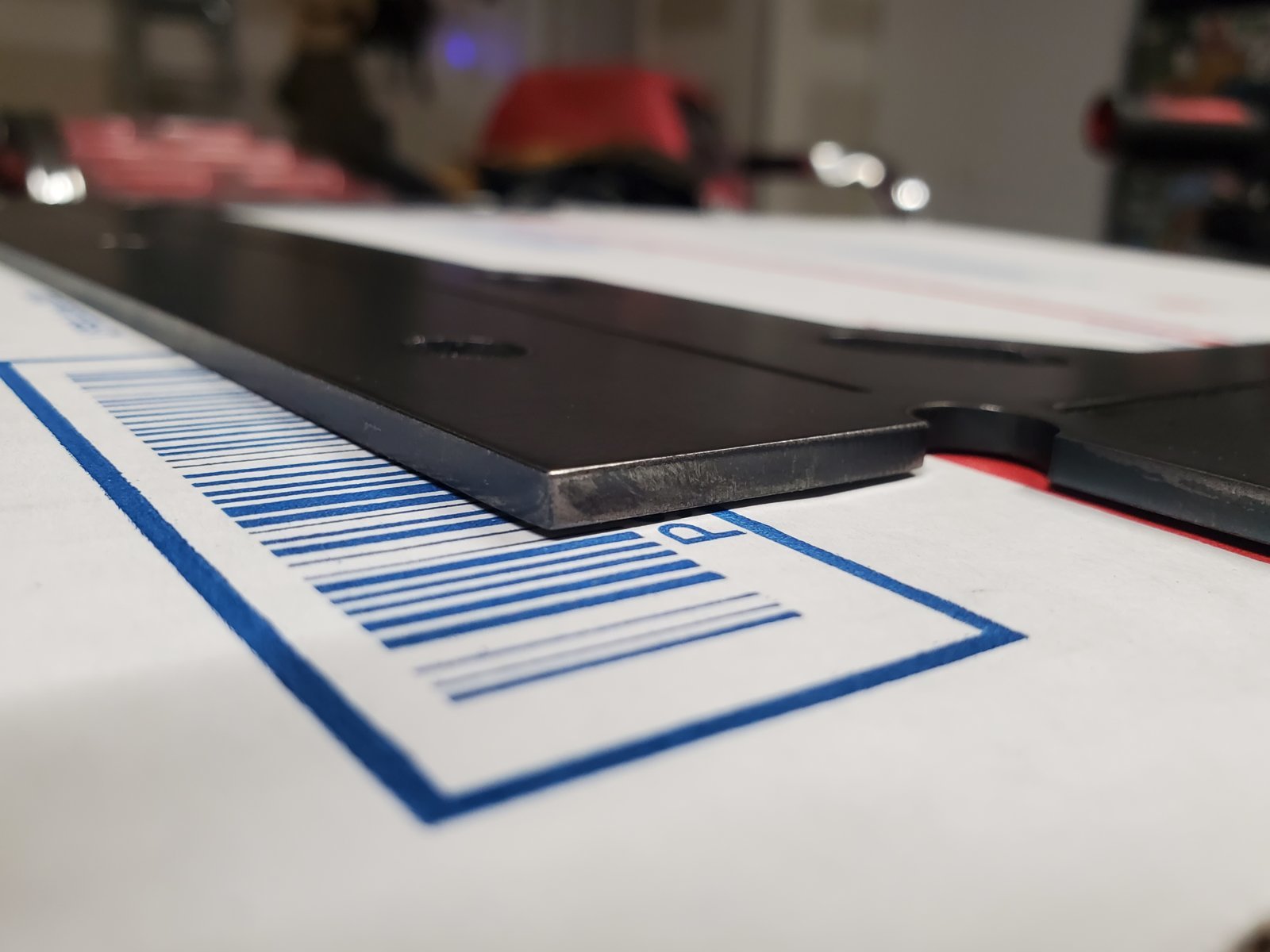

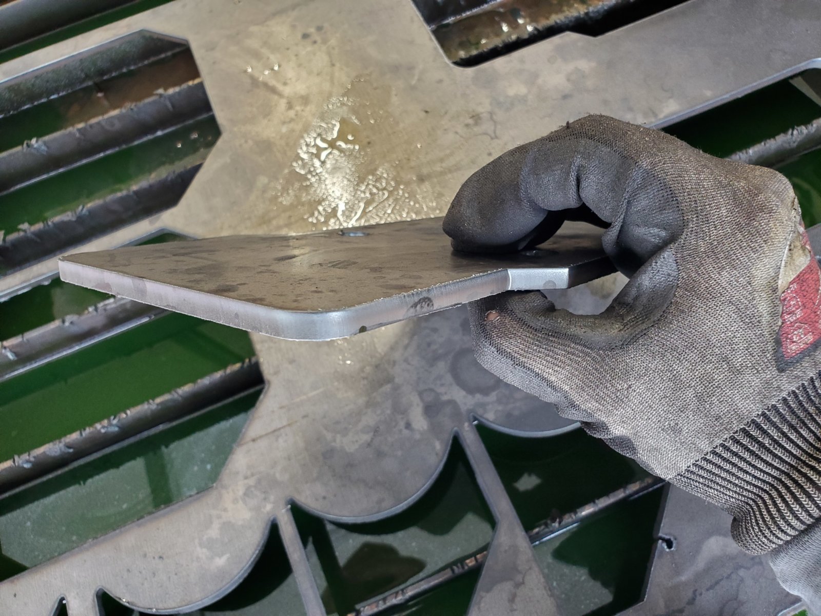

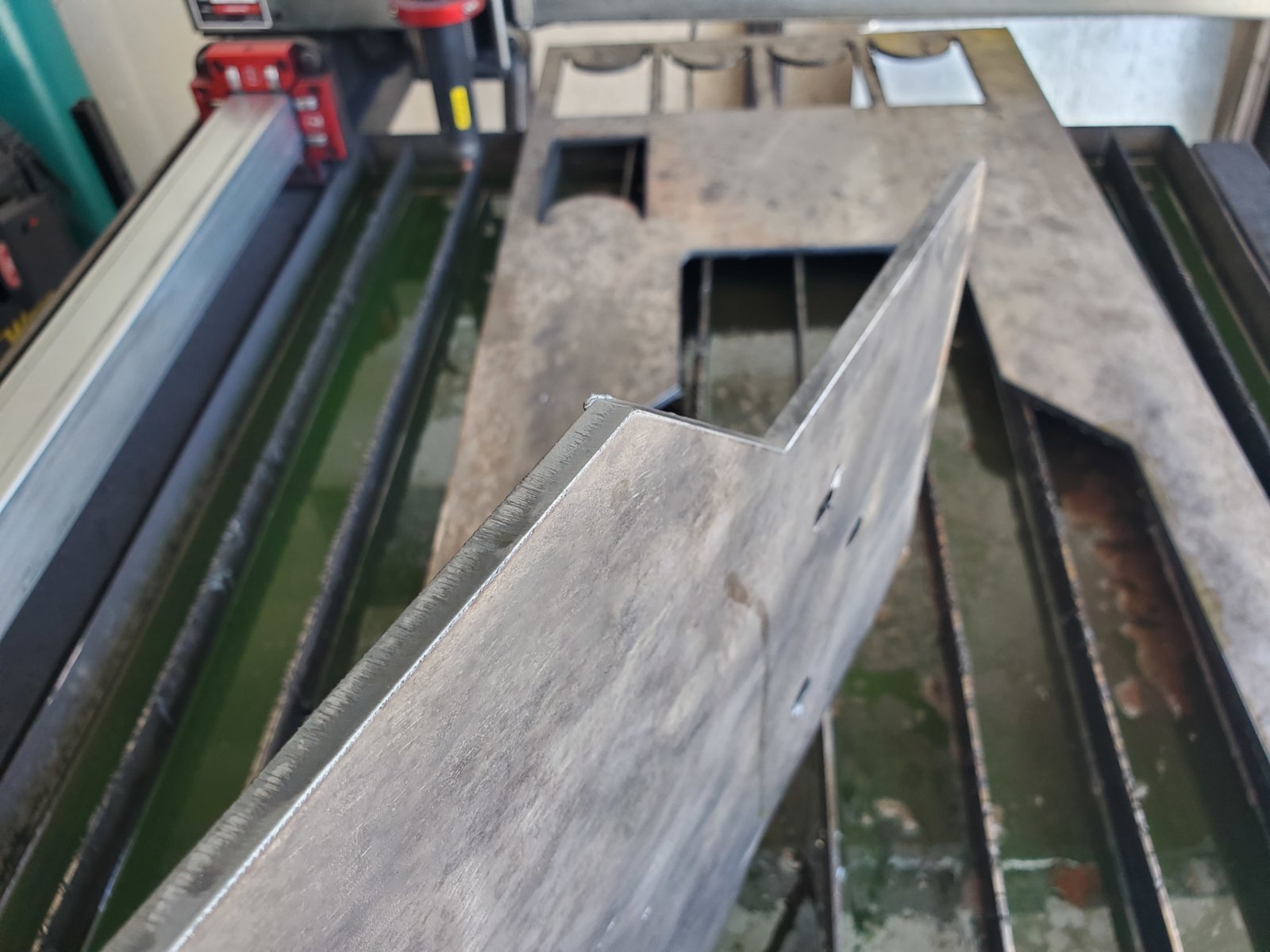

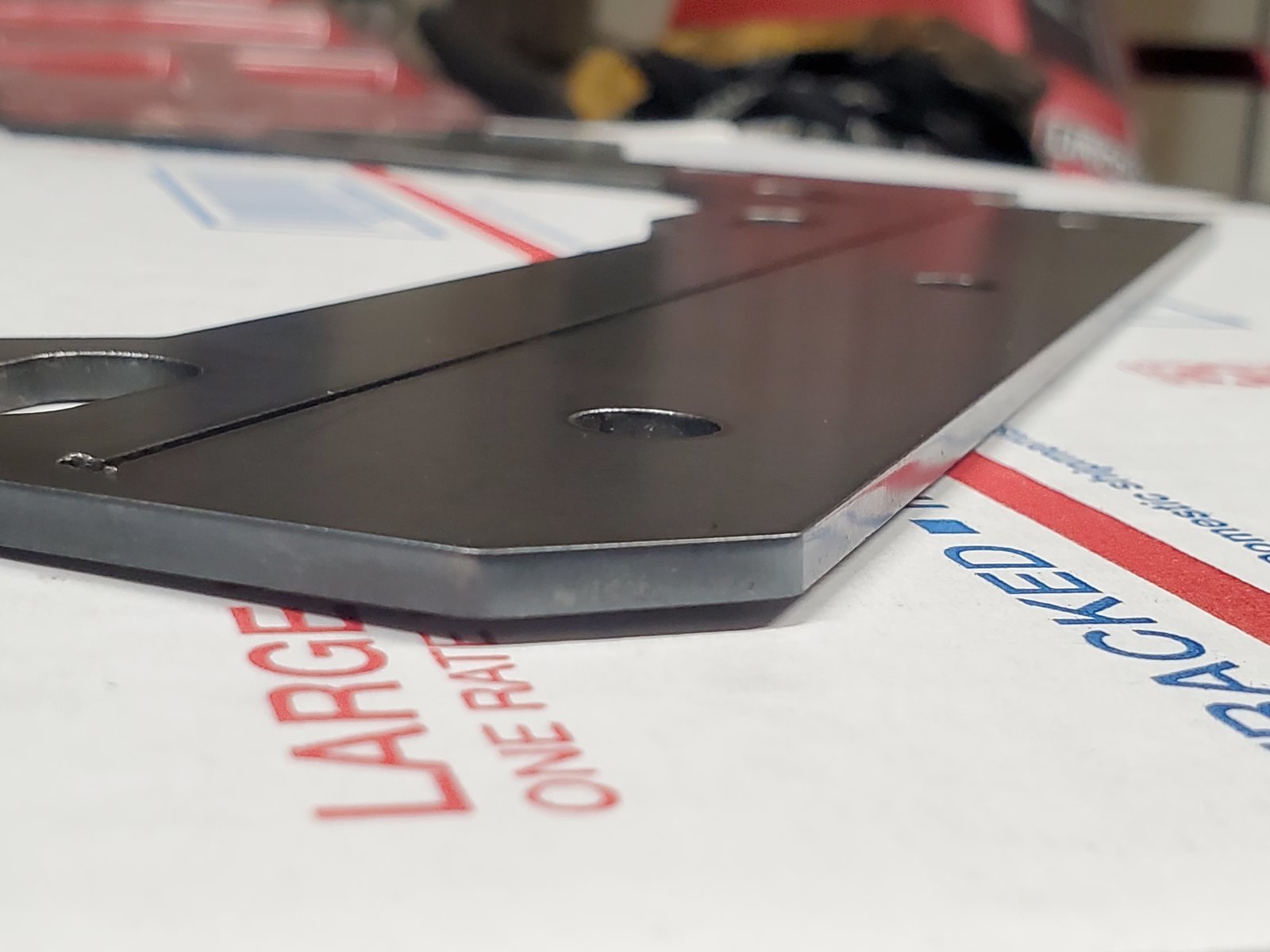

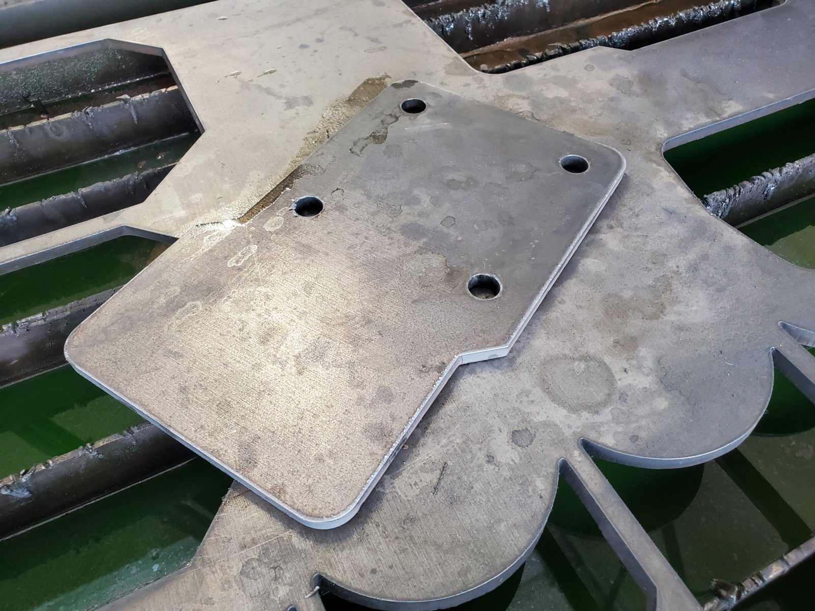

    @Bandido
    I get great cuts already, but my setup can be a bit temperamental
    Hypertherm consumables will maintain this level of quality for a lot longer between cuts, and are easier to maintain.

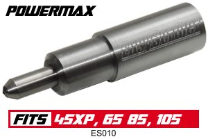

    I'll know I need to swap nozzles when I start getting a bit of beveling, and the crappy part being that the hafnium isn't even worn out yet on the electrode.
