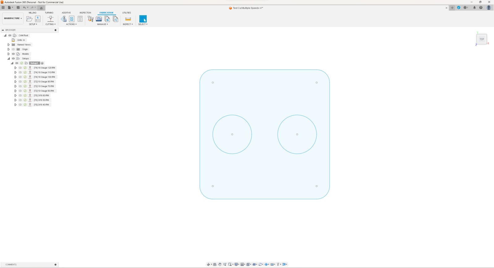

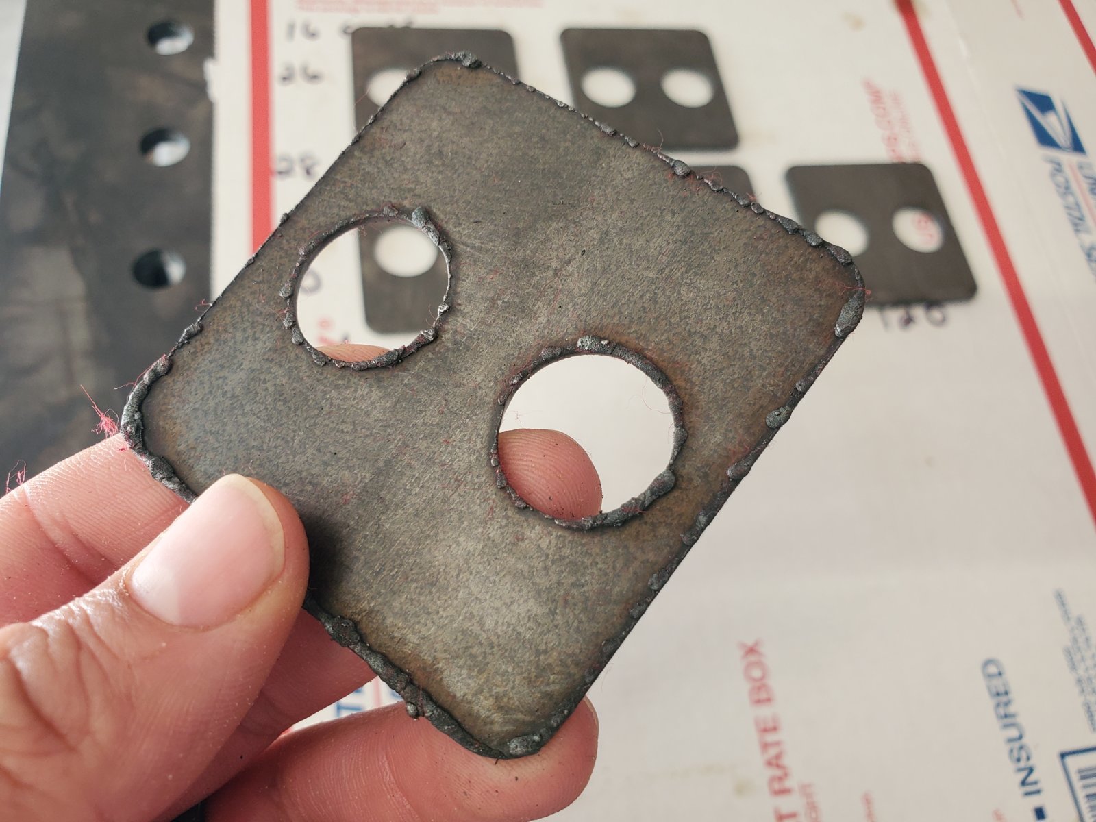

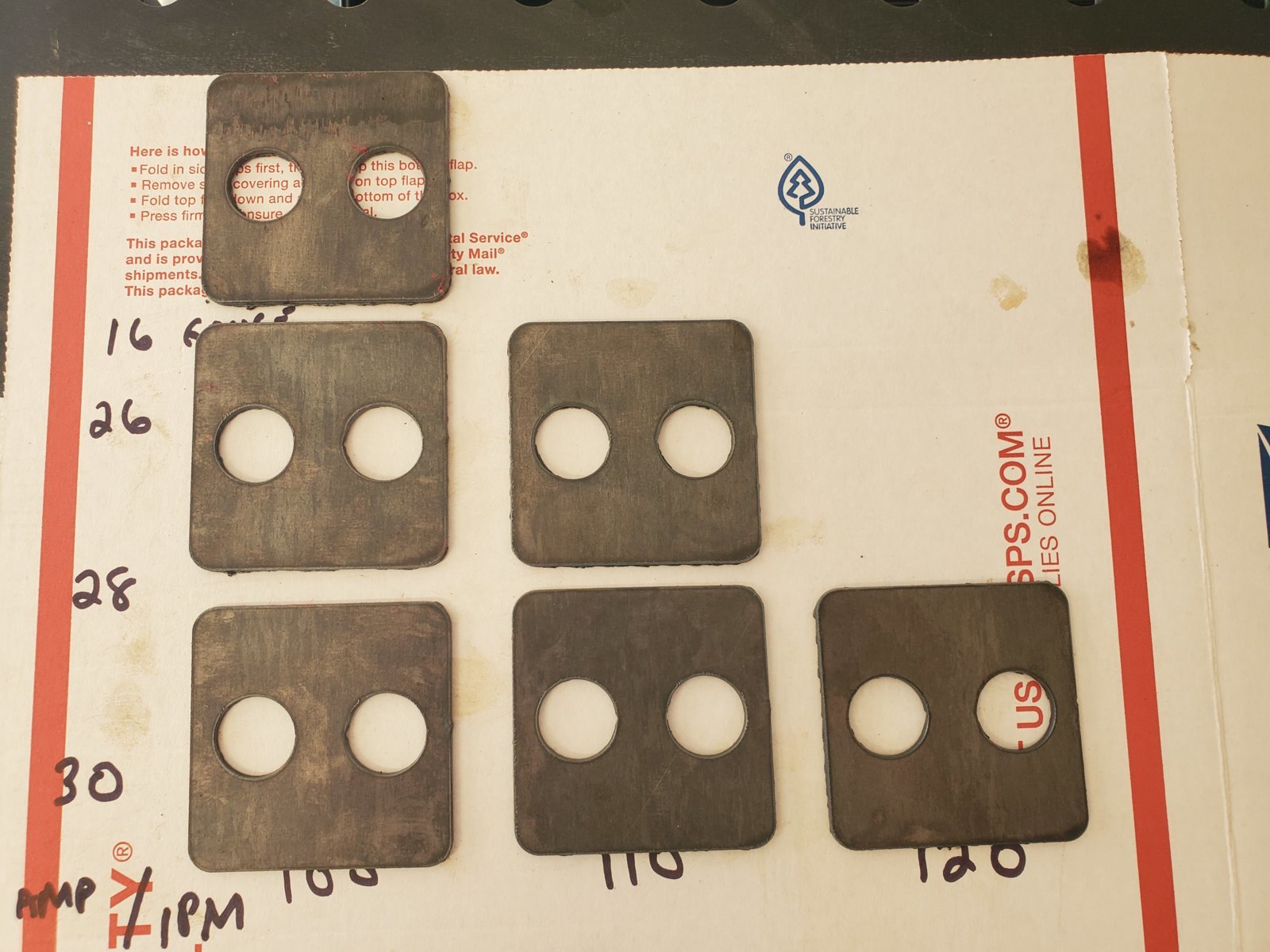

    Got some cutting ahead of me, I've been getting some hard dross on the backside with the new torch so I'll be running these today
    16 gauge will be tested at 26, 28, and 30 amp
    10 gauge will be tested at 32, 34, and 36 amp
    and 3/16" will be tested at 38, 40, and 42 amp
    Got plenty of metal to kill so we'll see

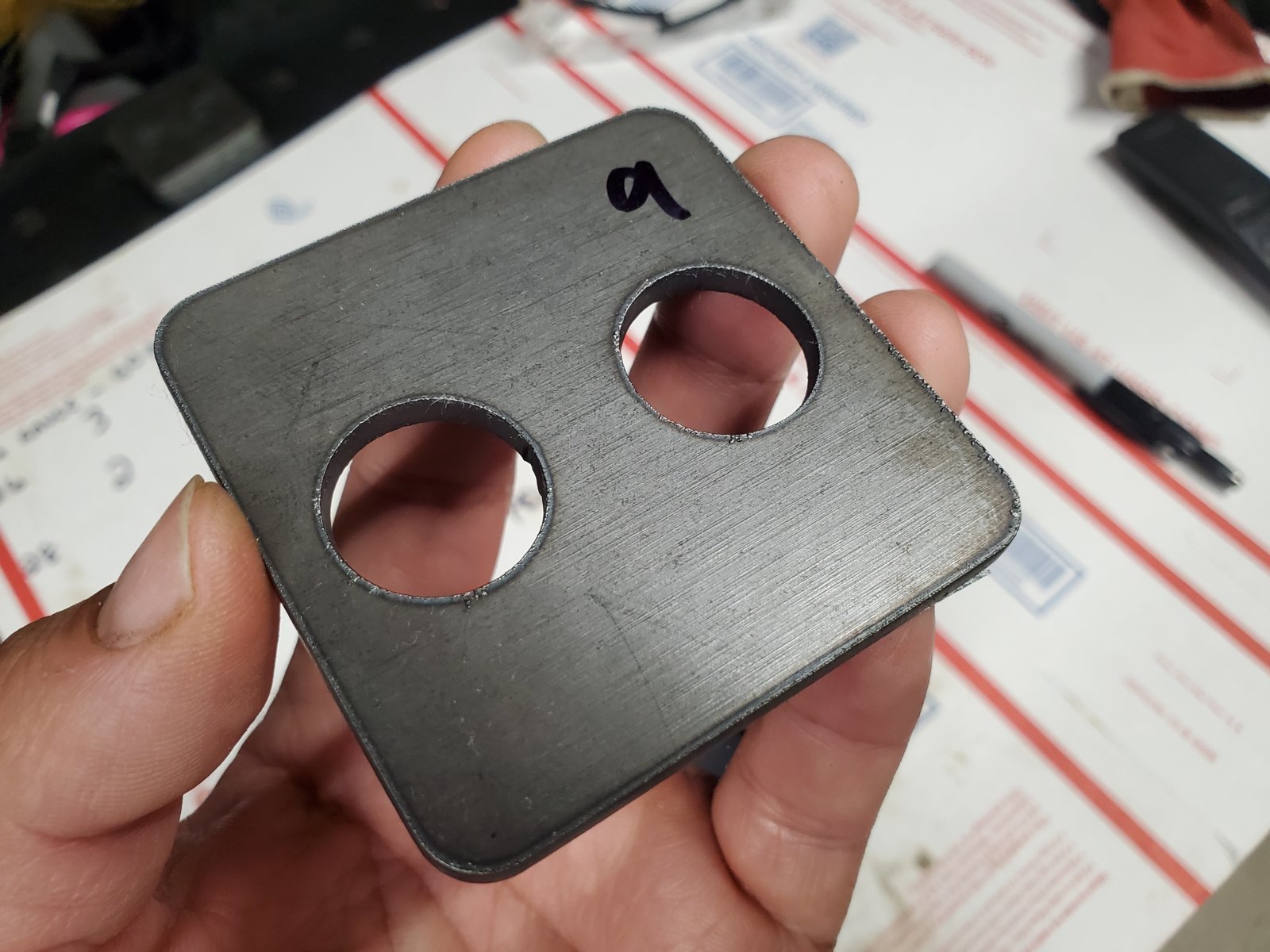

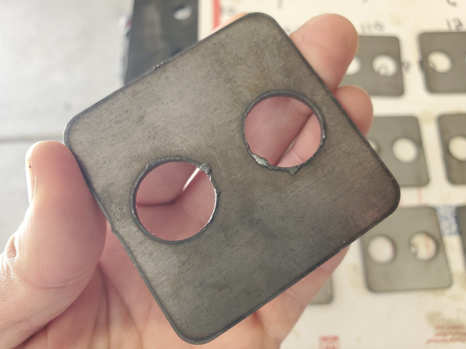

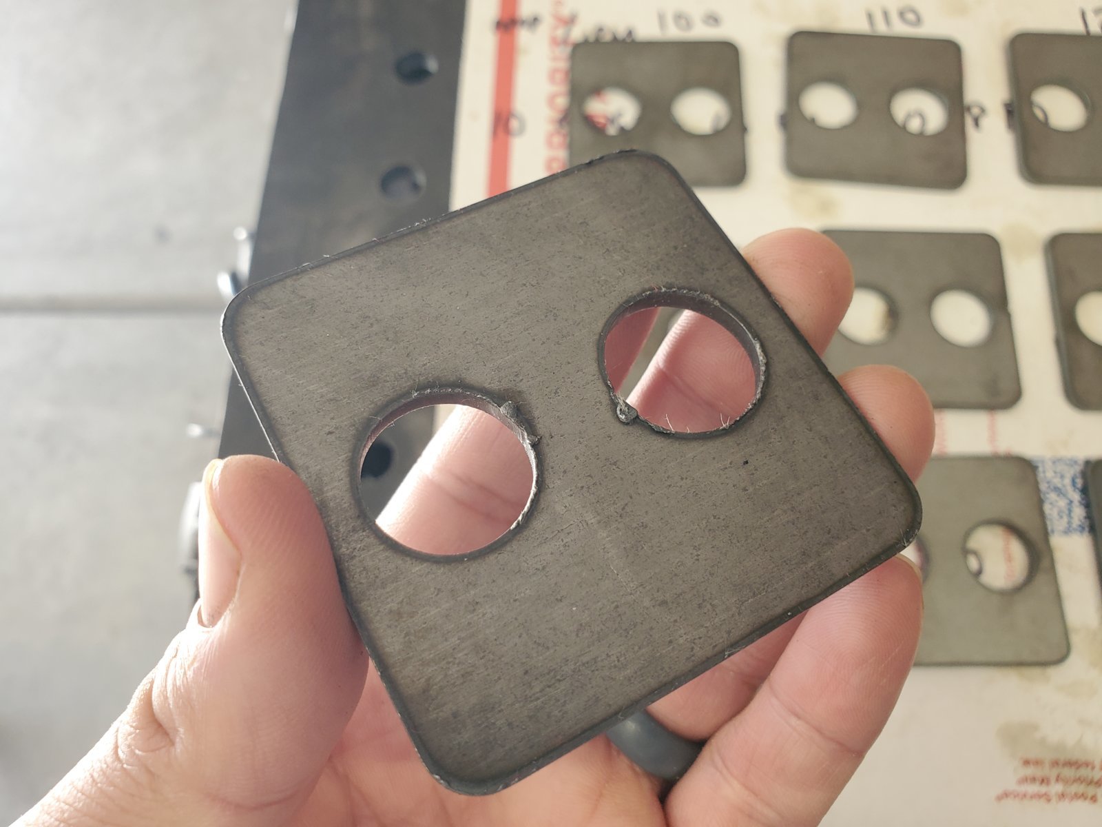

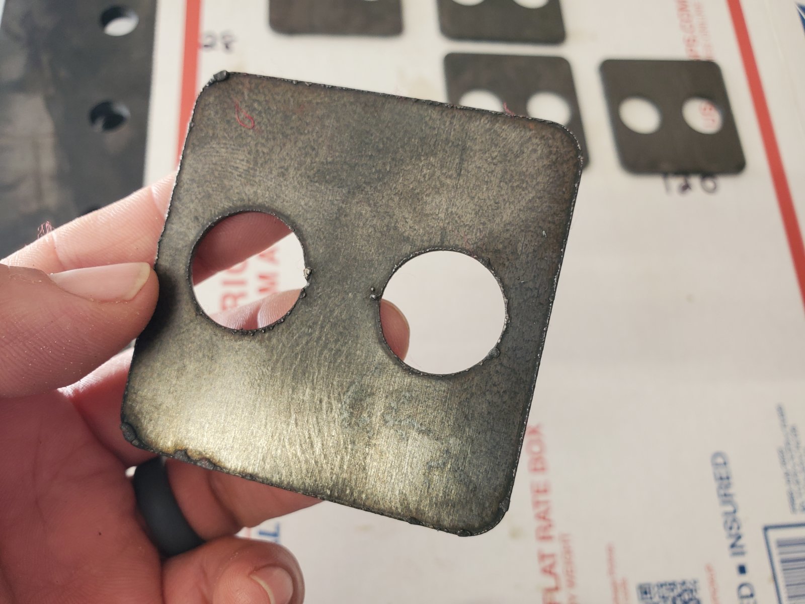

    Running 110ipm at 26 amps meant having to press the test piece out, which meant no further testing at 26 amps
    What I found interesting is I'm running better results at a slightly slower speed compared to my other torch
    What used to be 28 amps and 120ipm is now 30 amps and 100ipm
    People complain about dross on thinner metal, which is a common theme but this is hardly any at all for a thin metal so I'm quite happy with the results
    Meanwhile this is 26 amps at 100ipm
    And this is 30 amps at 120ipm
    Wonder how much more it'll differ if I use a 1.1 kerf width as I'm running a 1.0 kerf width

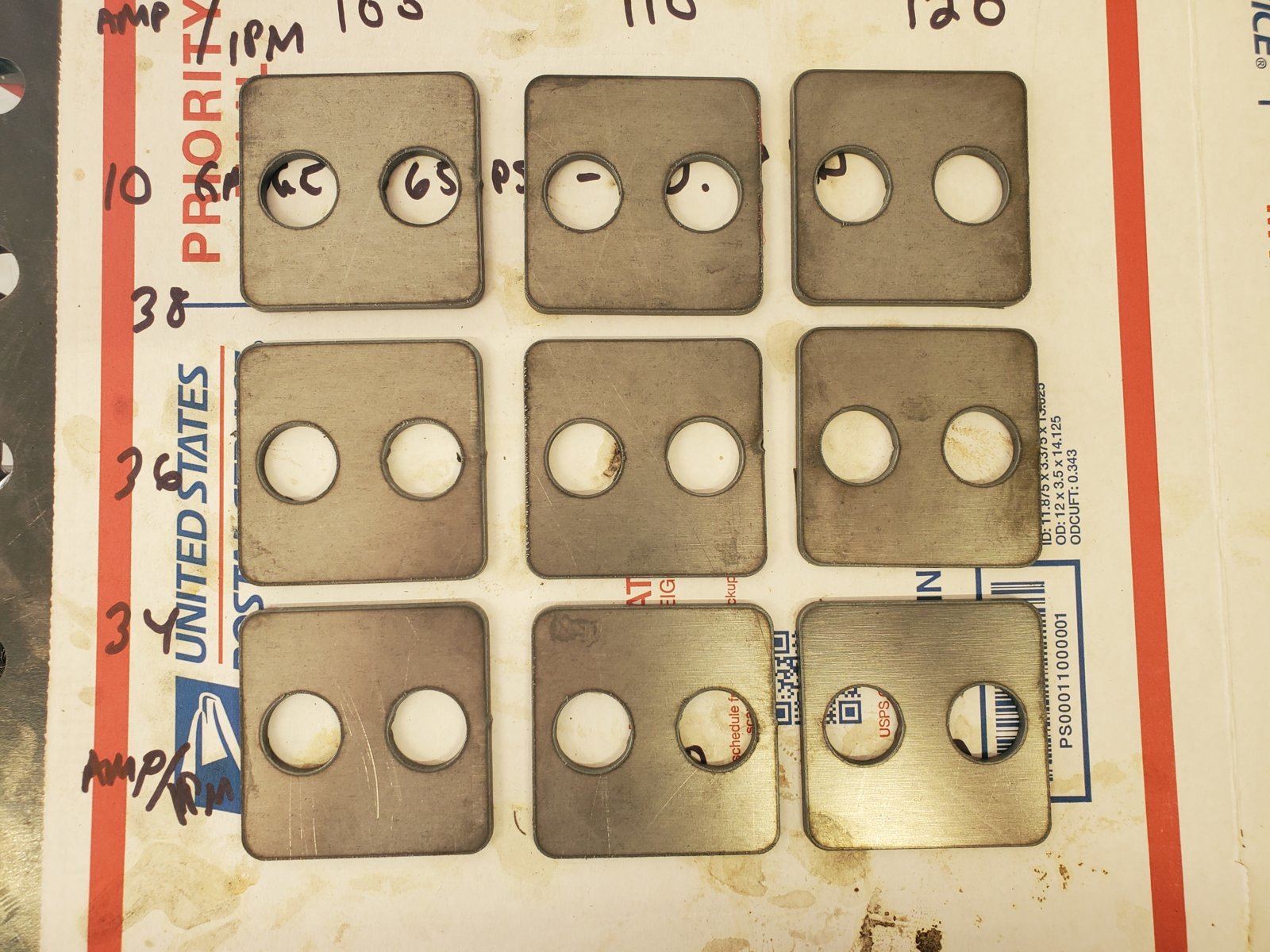

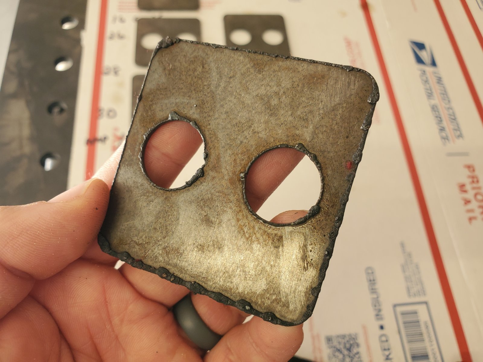

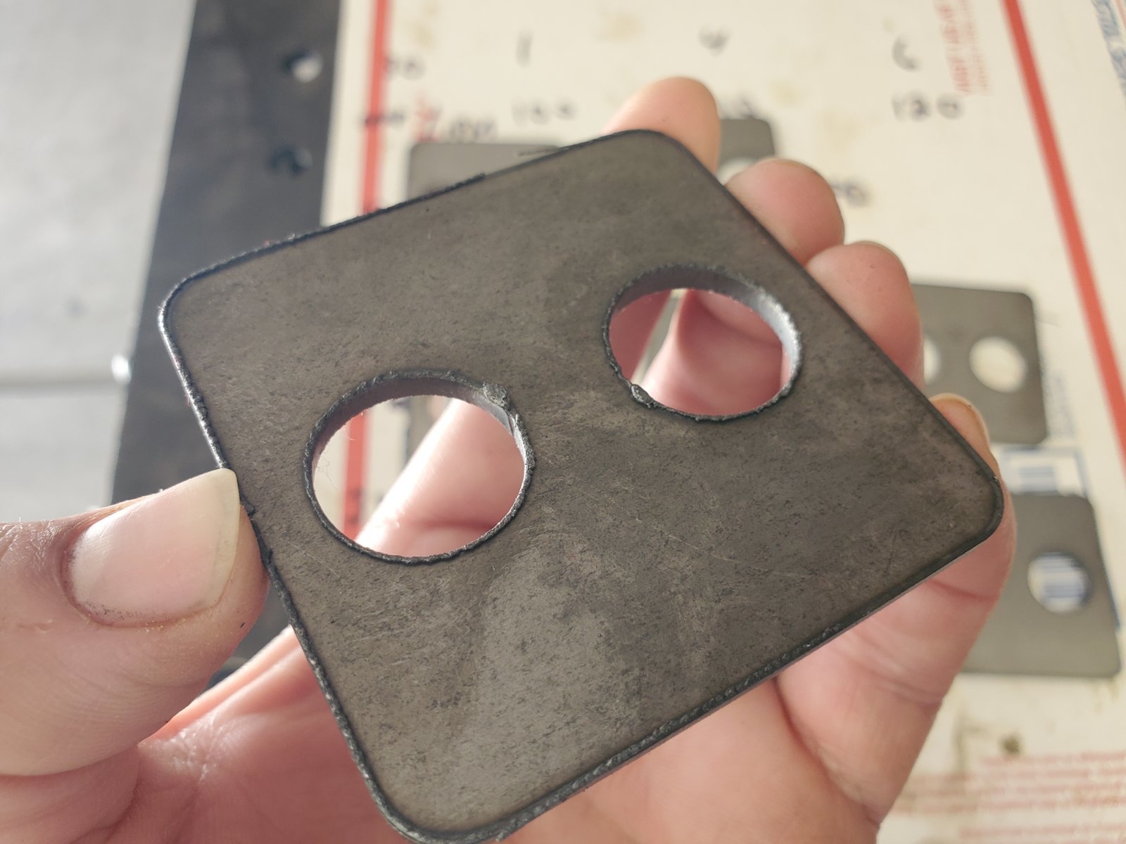

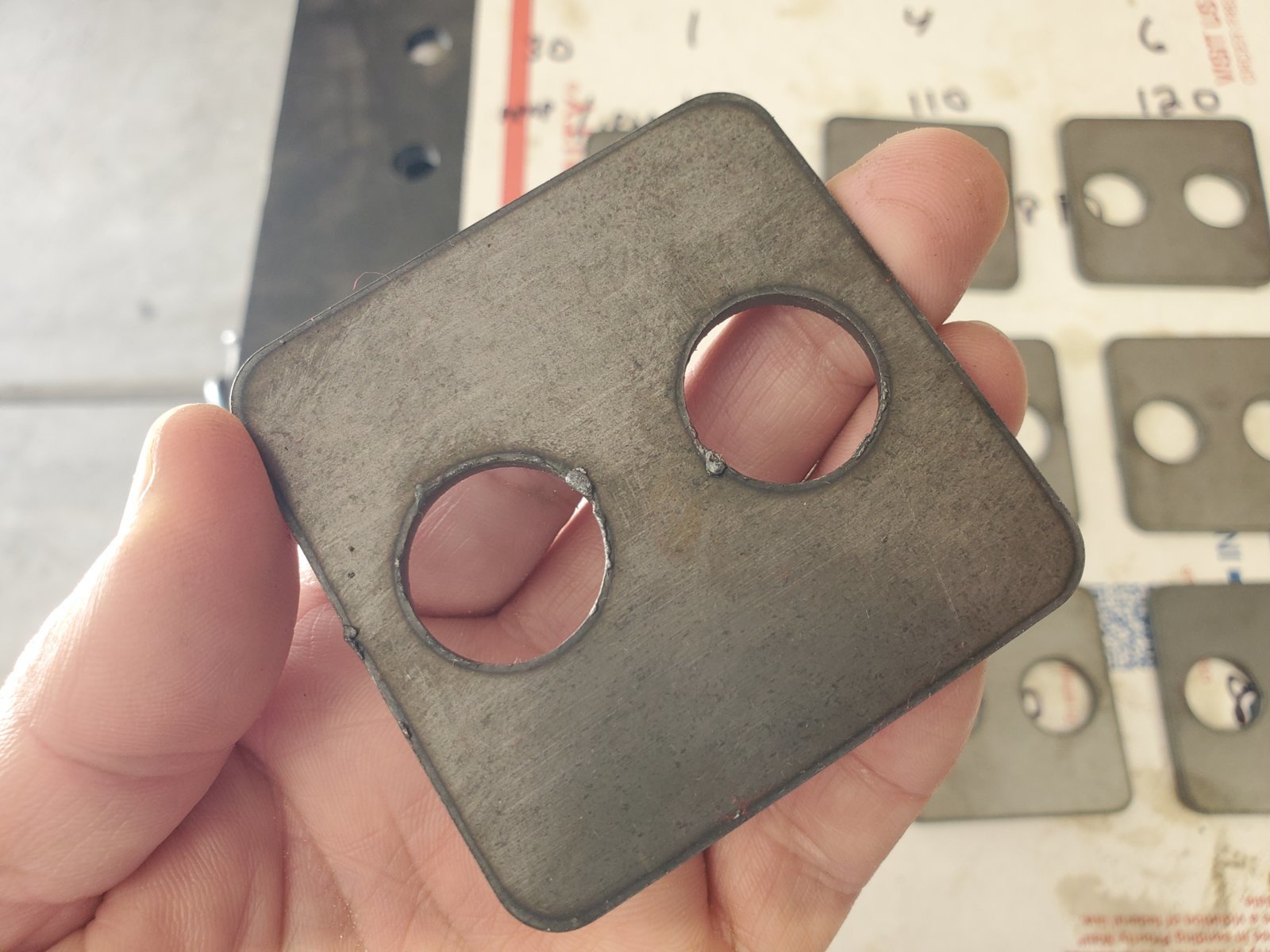

    Round 2 was rather interesting testing 10 gauge; I altered testing slightly to better align with what I was running
    Testing went from 34 amps to 38, and 60ipm to 80
    Seems running 34, 36, or 38 amp had little difference at a speed of 60ipm; the three had less dross compared to 70 or 80ipm
    The worst being run at 38 amps and 80ipm
    Sure the dross on the underside is minimal, but it's also one of two that experience dross on top
    Glad I'm running all these test pieces as I've needed to do it since I got my torch a month ago
    The other torch last year dialed in much faster
