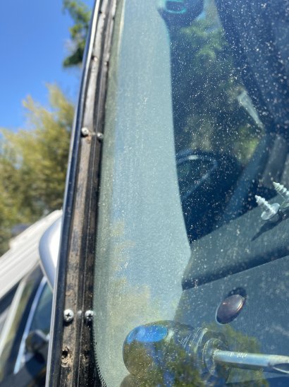

    A common problem I see with 100 series windshield installation is the rivets are replaced with screws. Then the screws rust and leave dimples. I will need to get my 100 windshield redone by someone who knows that they are doing. I had wind noise of the passenger side A pillar until installing a snorkel deflects wind away from the problem area. I can't complain about it now so I may wait until I pick up a crack from off-roading to get it done properly.

    That must be the trim strip he was talking about, 80s just leave the gasket molding bare, no rivets or screws anywhere.

    This windshield has been screwed. Screws need to be removed and the channel cleaned and any rust removed. I know of a place in Dallas that knows how to replace a 100 series. FJ Cruiser windshields have special needs as well.
