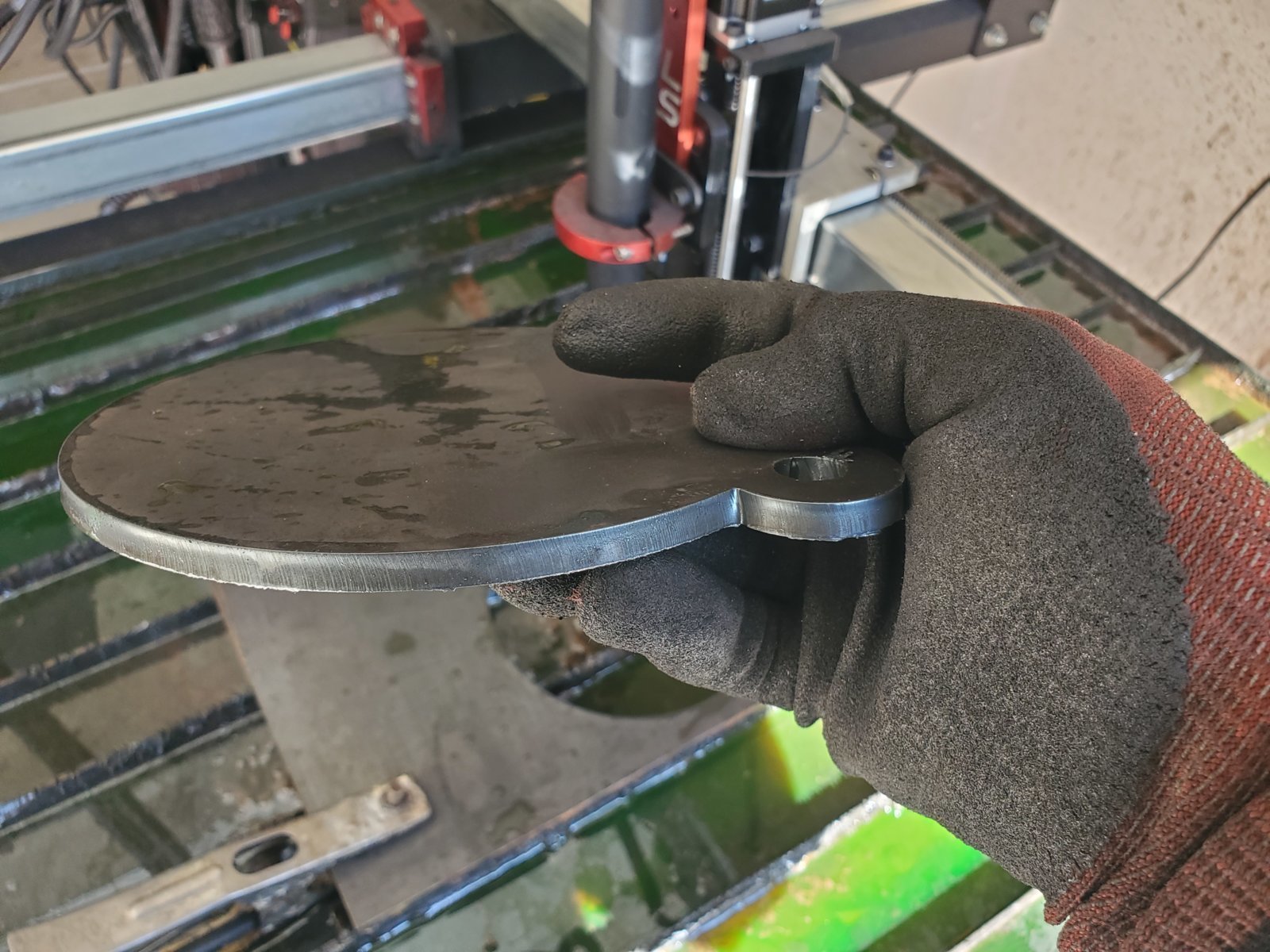

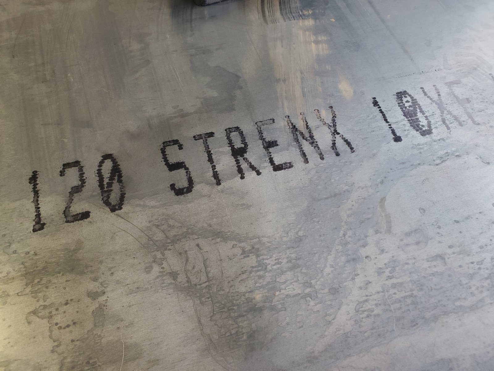

    Hoping this steel cuts the same being abrasion resistant
  14. Jan 2, 2024 at 8:59 AM
    Speedytech7
    Feb 20, 2014
    #123587
    58,327
    FCQM+VG Cheney, Washington
    It's less Tacoma and more mod
    abrasion resistant? like extra carbon?
  15. Jan 2, 2024 at 9:07 AM
    Kwikvette
    Feb 27, 2019
    #284735
    82,214
    Fresno County
    4 run, 2 don't
    Yes sir, it's something Strenx specifically sells

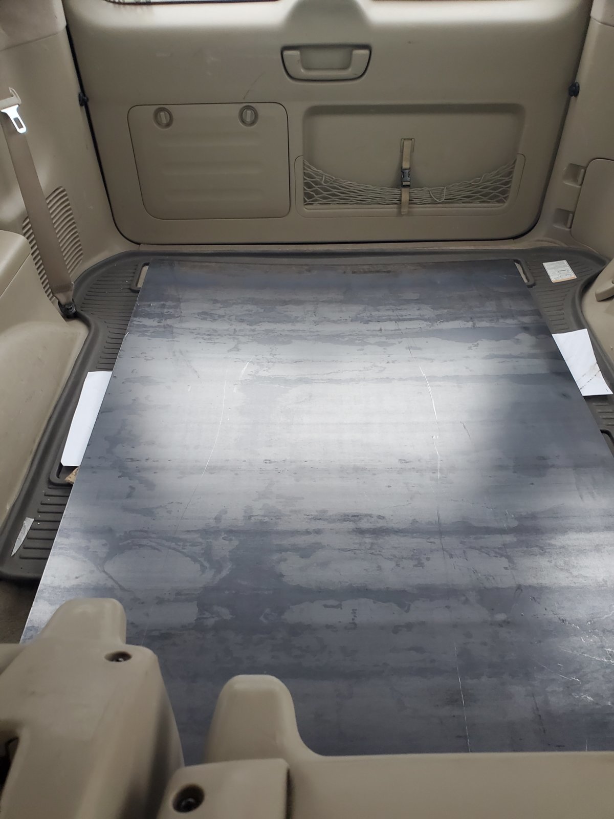

    Being a drop, it only cost me $40 for a 3' x 5' of 10 gauge and all I needed was 10" x 33" of it

    Never heard of it but usually high carbon blends aren't hard to cut at least

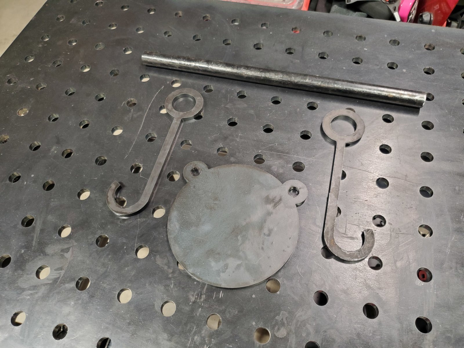

    10 gauge for me requires only 36 amps, 65psi, at 60ipm.
    That leaves me 24 amps left and a bigger tip if I needed to use it :D
    I use a 1.0mm tip rated for 45 amp, and keep my 1.1mm tips rated for 65 amps for thicker stuff like 1/4" and up

    As for the whole AR stuff, he said this customer specifically requested it as he never has it in stock himself
    So I bought it like regular scrap/drop
    Bullet proof dino? Maybe sell it to my LA customers :stirthepot:

    Well it isn't AR plate so you'll be fine, that shit actually sucks to cut

    You are not the first person I've heard say that; fortunately I don't cut targets
    Although I did cut a target for another member here out of regular 1/4" plate and advised him it would be ok for ball round like .40, 9mm, .45acp, or .22lr but not to use 5.56
