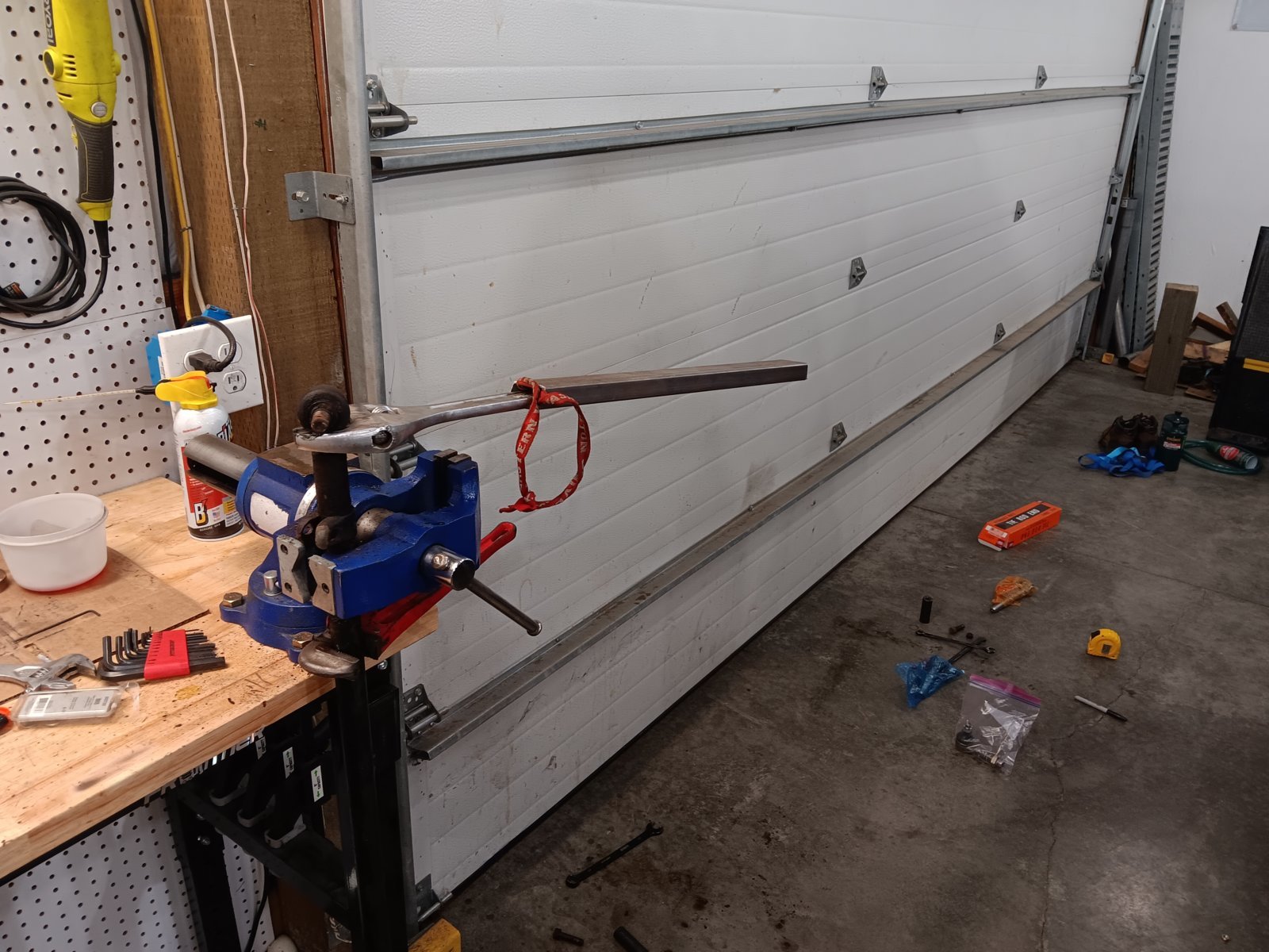

    These tie rods are killing me

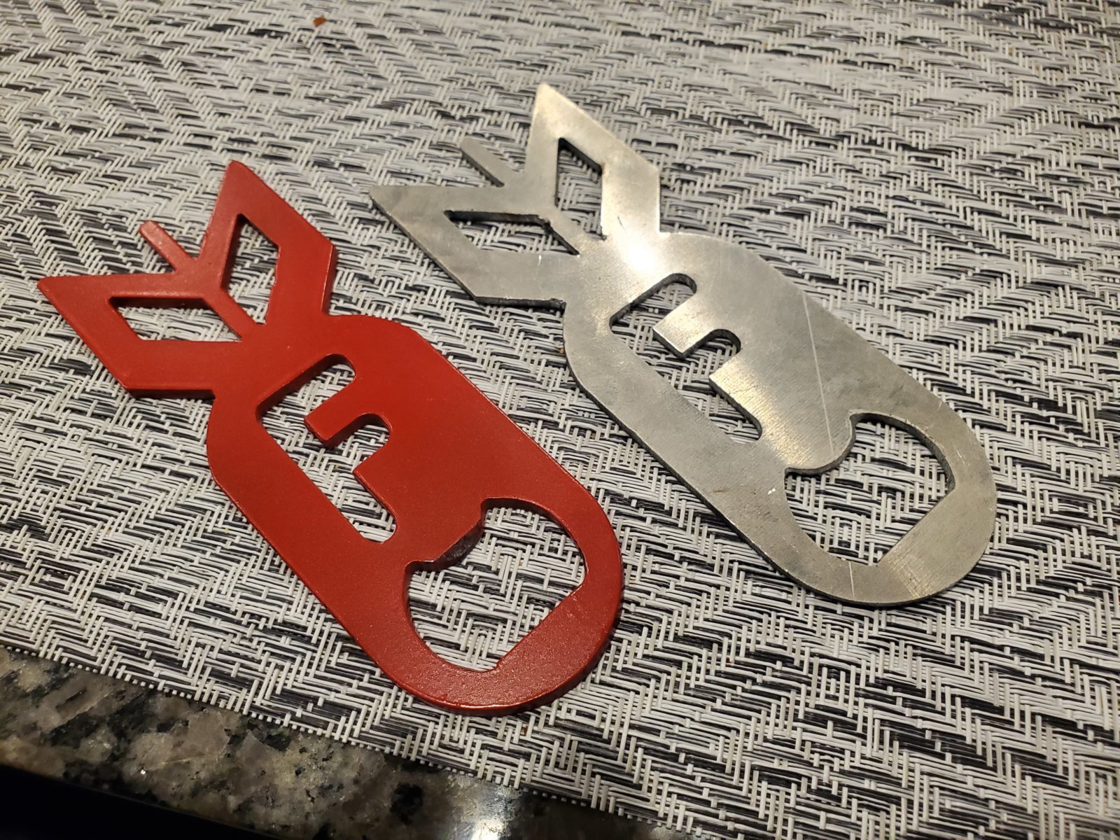

    I made 3? Before it started beveling and I kept changing my settings to try to reduce dross...

    What's your physical cut height?

    It's on thc, but setting height is .12 for the 1/8 ss, it probably goes a little higher than that tho.
    Usually I leave it at .08 for everything tho and let the do its thing

    THC works to maintain your programmed cut height; it does this by measuring voltage after the initial pierce, and adjusting Z axis as it runs through your cut to maintain that initially measured voltage
    That isn't your cut height though and just typing into your CAM program a cut height of say 0.08" does not mean your torch is physically at 0.08"
  18. Jan 5, 2024 at 8:21 PM
    Kwikvette
    Feb 27, 2019
    #284735
    82,588
    Fresno County
    4 run, 2 don't
    For instance, my one PTM-60 torch would require a programmed height of .055" in CAM in order to have a physical cut height of .06"
    Since I switched to my UPM-105 I have a programmed height of .045" in CAM in order to achieve .03" cut height from my shield
    Programmed isn't 1:1 with actual due to small variances from one setup to another which is why you have to pause during the middle of your cut, measure, adjust, and confirm

    Now this is stuff that I know and have not bothered to sort out settings wise, since specifically on mild the difference isn't incredible. Now on the stainless I am paying a lot more attention since the quality difference between small changes is remarkable. I started with just the hypertherm cut chart settings, upped pierce delay a little, .4->.6, also slowed the ipm down a little 110->95->75, but had not changed the pierce height or cut height.
