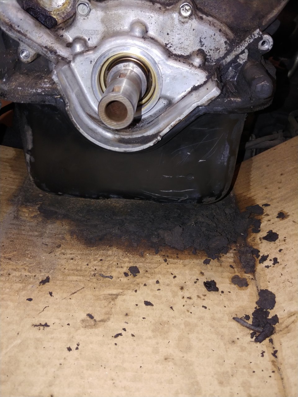

    Guess I'm making a seal driver out of some PVC, can't find one long enough to reach over the crank snout on the Z

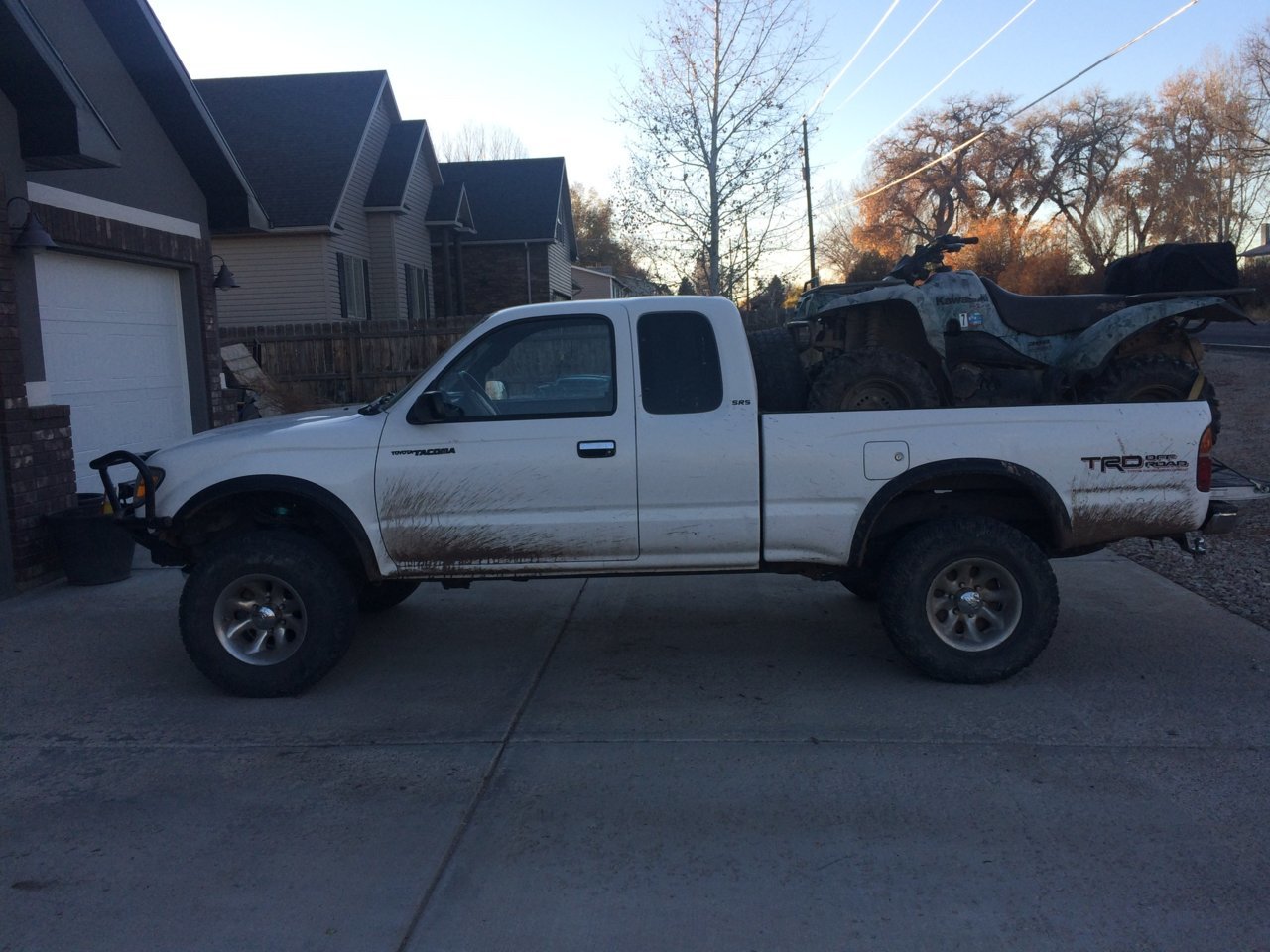

    What is squat

    That’s what I did with my rear main seal. I went to Home Depot and bought a 3” ABS Toilet Flange

    Pittsburgh, Pennsylvania
    Flux Capacitor
    Get on my level.
    Pretty sure I was riding the bumpstops for miles.

    I ditched my Dakars after only a couple months of having them on because the rear sagged on the bump stops with my tent and camping gear...even with an AAL put in both sides. I dunno exactly how much weight it was but I'm guessing around 700lbs. Anyhow I know that OME states that the standard duty Dakars aren't designed to hold any more weight than the OEM leafs were, which is why they make a medium and heavy duty option for later gens...1st gens just have the option of adding AALs
