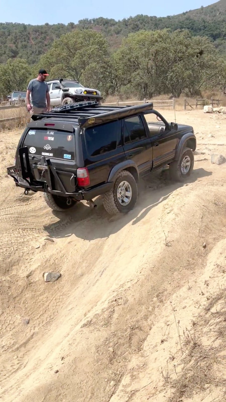

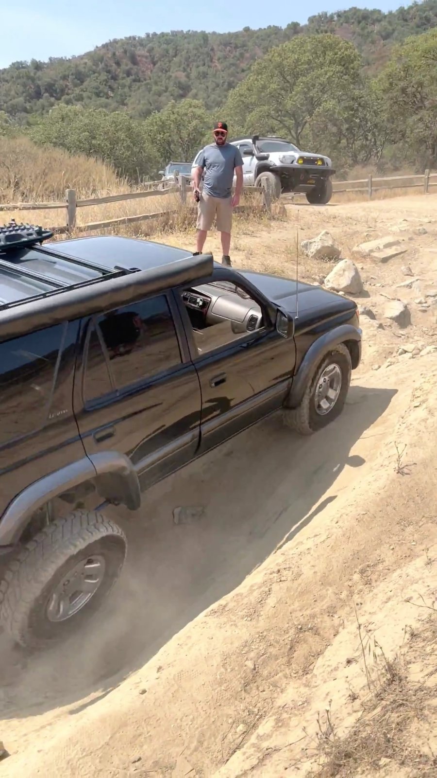

    4 run, 2 don't
    Crappy pics a buddy took but stuffing that front
    That front extending
    And yes, I had factory upper and lower control arms :burp:

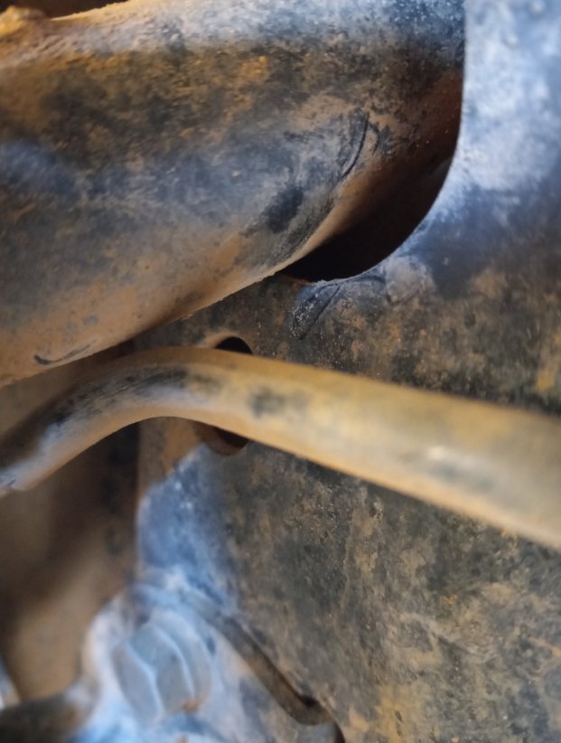

    I see lots of bitching about 100s limited downtravel being the LCA. It's the UCA pressing against the frame mount U that is higher on the rear that arrests down travel.
