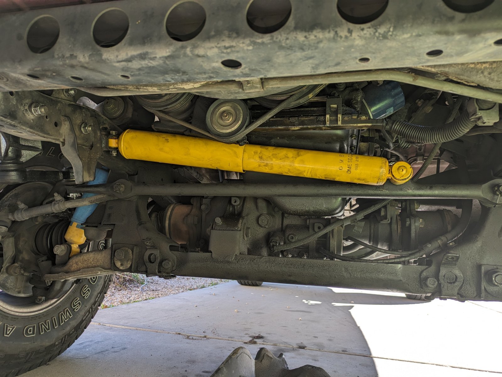

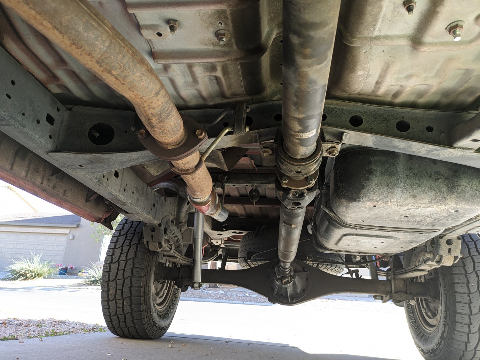

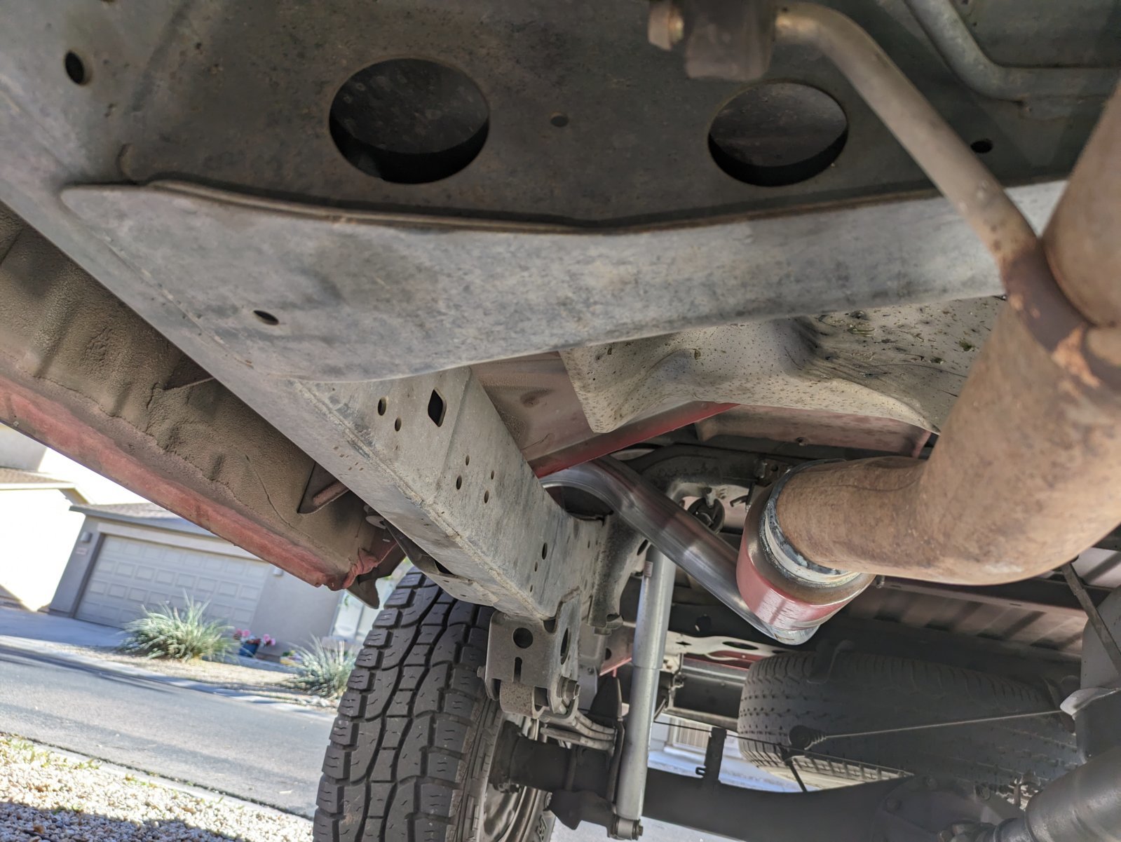

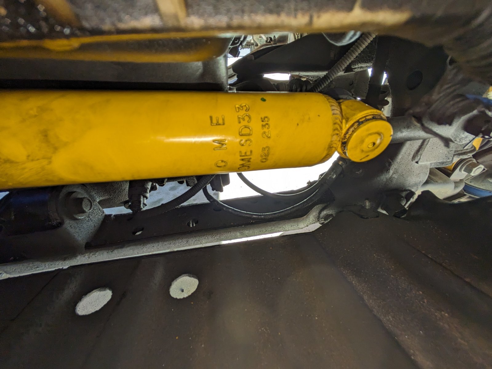

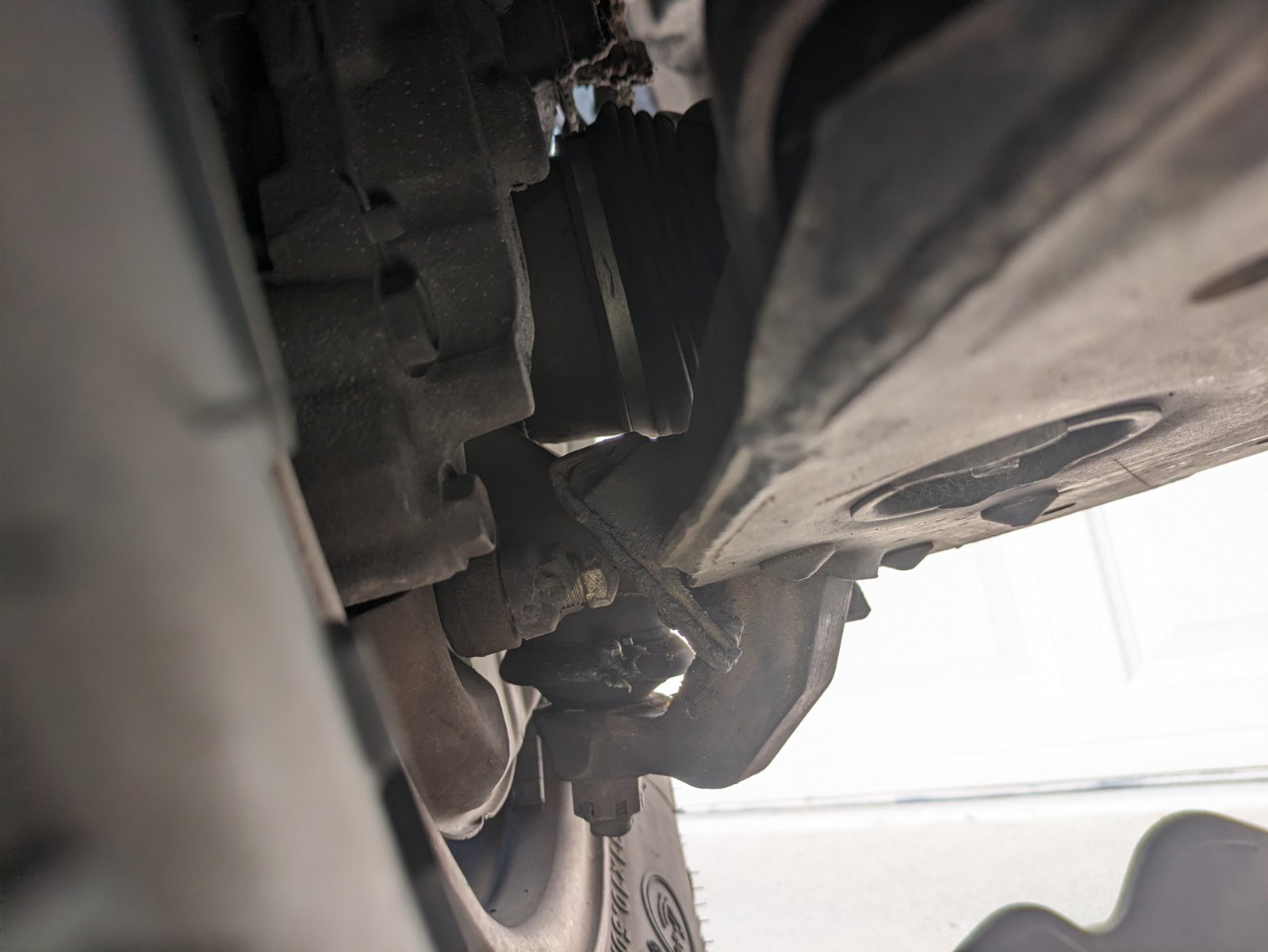

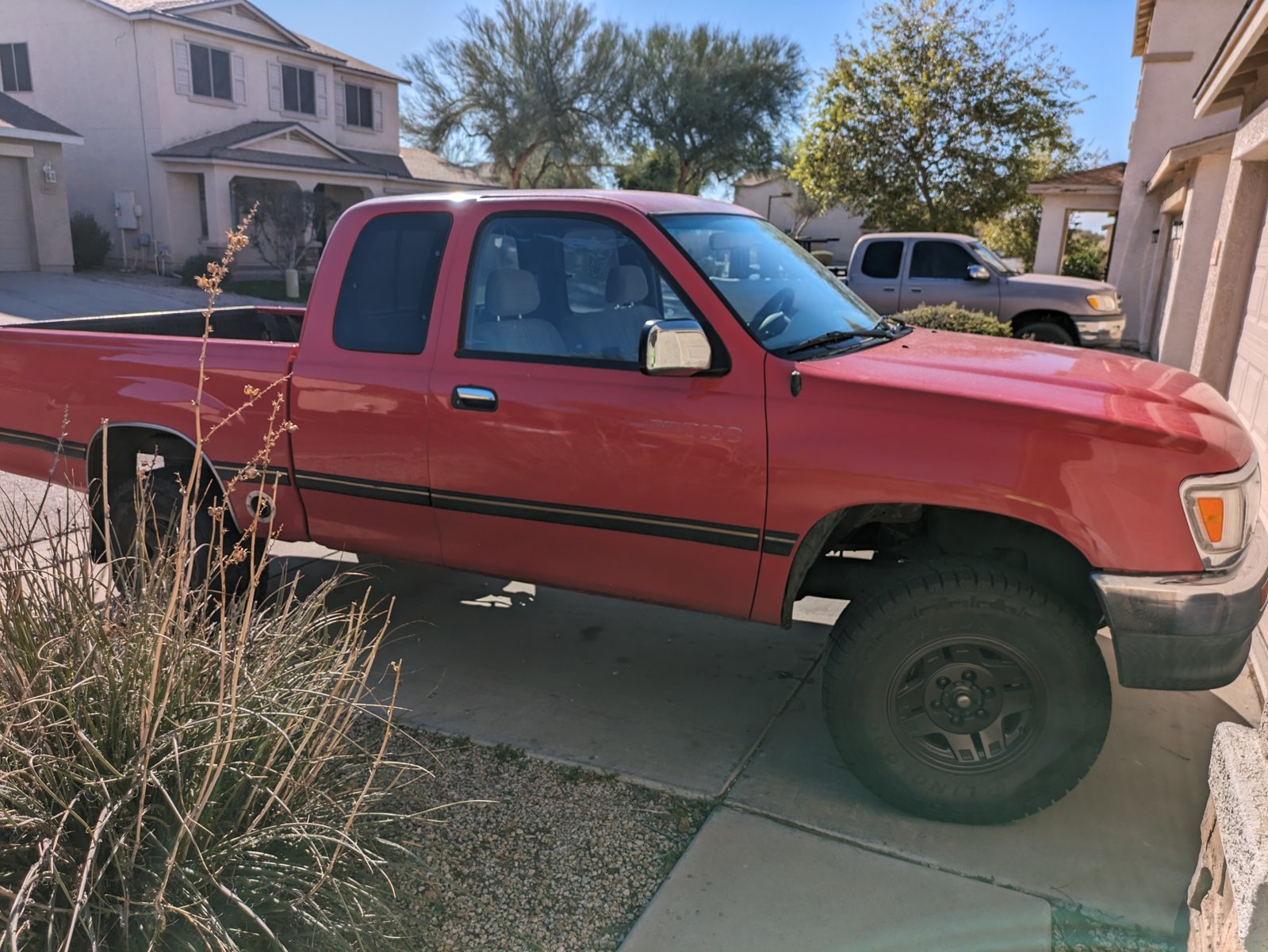

    Afternoon all, quick update and a question you guys should know the answer to.
    Ive done quite a bit to the truck since the last we spoke, even paid the debt of changing a starter on the 5vz.
    Here's some pics, but I'll grab better one's later once i take it out.
    Question is, the last i replaced on the truck is the steering damper, i believe the alignment is shit bc i can only turn the wheel 1.5 turns to the left now, vs 2 on the right. I noticed with the damper off i can turn till it also hits this bolt on the rear of the hub/brakes assembly. Does it just need an alignment?

  8. Feb 13, 2024 at 2:52 PM
    Speedytech7
    Feb 20, 2014
    #123587
    58,541
    FCQM+VG Cheney, Washington
    It's less Tacoma and more mod
    That bolt is the steering stop, is it possible you got delivered the wrong steering damper?

  9. Feb 13, 2024 at 2:53 PM
    Kwikvette
    Feb 27, 2019
    #284735
    82,827
    Fresno County
    4 run, 2 don't
    Good to see you back here and that you're walking again!
    Silly question but, do you have the right damper? Tie rod ends replaced? Wonder how far apart they were threaded out?

  10. Feb 13, 2024 at 2:53 PM
    Speedytech7
    Feb 20, 2014
    #123587
    58,541
    It looks too far extended in the center position, I bet it's for a pickup
  11. Feb 13, 2024 at 2:54 PM
    Kwikvette
    Feb 27, 2019
    #284735
    82,827
    Fresno County
    4 run, 2 don't
    Funny you thought the same thing; I went through my own rabbit hole of dampers and steering setups when I got bored one night and yeah his looks way off (extended)
  12. Feb 13, 2024 at 2:55 PM
    Kwikvette
    Feb 27, 2019
    #284735
    82,827
    Fresno County
    4 run, 2 don't
    Just like a shock, just because the bolt holes can match doesn't mean it's the right fit length wise
  13. Feb 13, 2024 at 2:59 PM
    Das it mang
    Das it mang Well-Known Member
    May 1, 2019
    #291938
    6,586
    Az
    1996 T100 SR5 MT
    Stock again- rip slug
    Thank you!! Appears to be stamped for the correct one, but definitely limiting my steering. The steering stop is only hit when removed. I did change the idler arm a month or so ago as well but this started after the damper
  14. Feb 13, 2024 at 2:59 PM
    Das it mang
    May 1, 2019
    #291938
    6,586
    Az
    1996 T100 SR5 MT
    Yeah and 4 runner , does it not share the same front end? Or t100 is extended
  15. Feb 13, 2024 at 3:01 PM
    Speedytech7
    Feb 20, 2014
    #123587
    58,541
    T100 frame is wider, this damper won't work since the mounts are farther apart

  17. Feb 13, 2024 at 3:03 PM
    Das it mang
    May 1, 2019
    #291938
    6,586
    Az
    1996 T100 SR5 MT
    Gah damn it, i thought i was slick with the upgraded ome one.
    I was reading a land cruiser one might work? Or just go with cheap shit
  18. Feb 13, 2024 at 3:04 PM
    Speedytech7
    Feb 20, 2014
    #123587
    58,541
    Looks like you need specs like this for a T100
