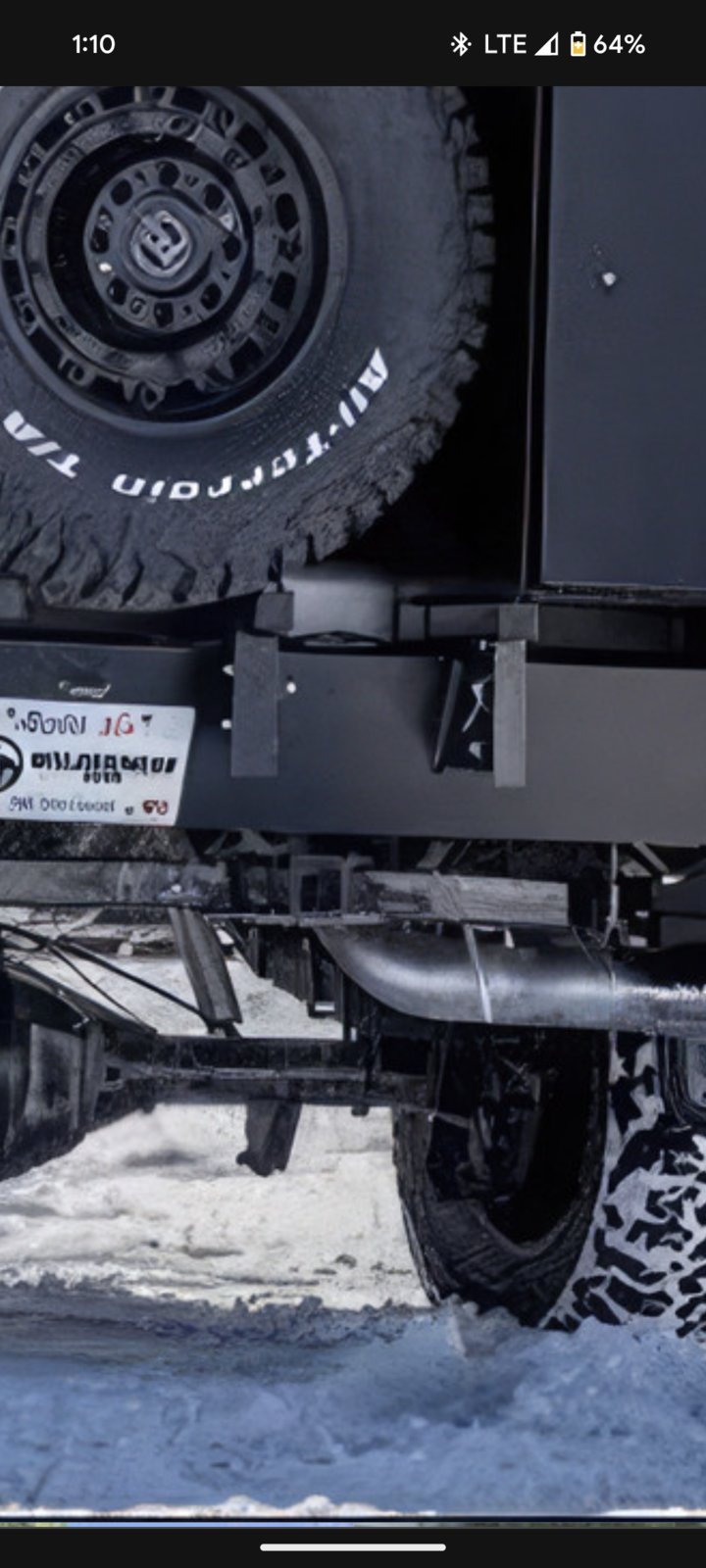

  4. Feb 20, 2024 at 12:13 PM
    m3bassman
    m3bassman Well-Known Member
    Jan 16, 2011
    #49376
    17,138
    Green truck
    Not a great picture but aluminess uses these latches, just slam it closed and it locks closed, small handle to release it. I'm a big fan of it, only issue is i due lube it with WD40 a couple times a year as it does gum up over time and can fail to completely latch without a hard slam.

  6. Feb 20, 2024 at 12:36 PM

  7. Feb 20, 2024 at 12:52 PM

  8. Feb 20, 2024 at 1:13 PM
    Bandido
    Bandido Engine...er
    Sep 4, 2017
    #229072
    2,249
    Alex
    Lexington, KY
    2003 Tacoma DC
    yeah double hinged will reduce sag, and moment deflection, TG weight I don't think is an important factor, only stiffness, Tire size restriction the aftermarket takes care of without changing the latch mechanism from my own quick browsing.
    I think a standard automotive striker/latch would be comparable quality to the jeep one, but notably not as well protected from the elements without additional effort, looks like this is what the Alumees latch is trying to do... and based on their design, moment deflection would impact the latch alignment more than if the latch were centered on the base tube.
  9. Feb 20, 2024 at 2:07 PM
    Speedytech7
    Feb 20, 2014
    #123587
    57,672
    FCQM+VG Cheney, Washington
    It's less Tacoma and more mod
    I have spares of the aluminess one, they're a common aftermarket striker and very thin/weak, I'll send em to you if you want em. I got them and immediately dropped my plans with them and at the time couldn't find a better striker latch. It's really no surprise they hang up and develop play, it's one of the only strikers on the market really so you can't blame Aluminess. I do think your point about stiffness is on point but you can't ignore weight with the Jeep argument because it's only stiff enough to support a rather light assembly, overlanding types put quite a bit of bullshit out on swingouts.
