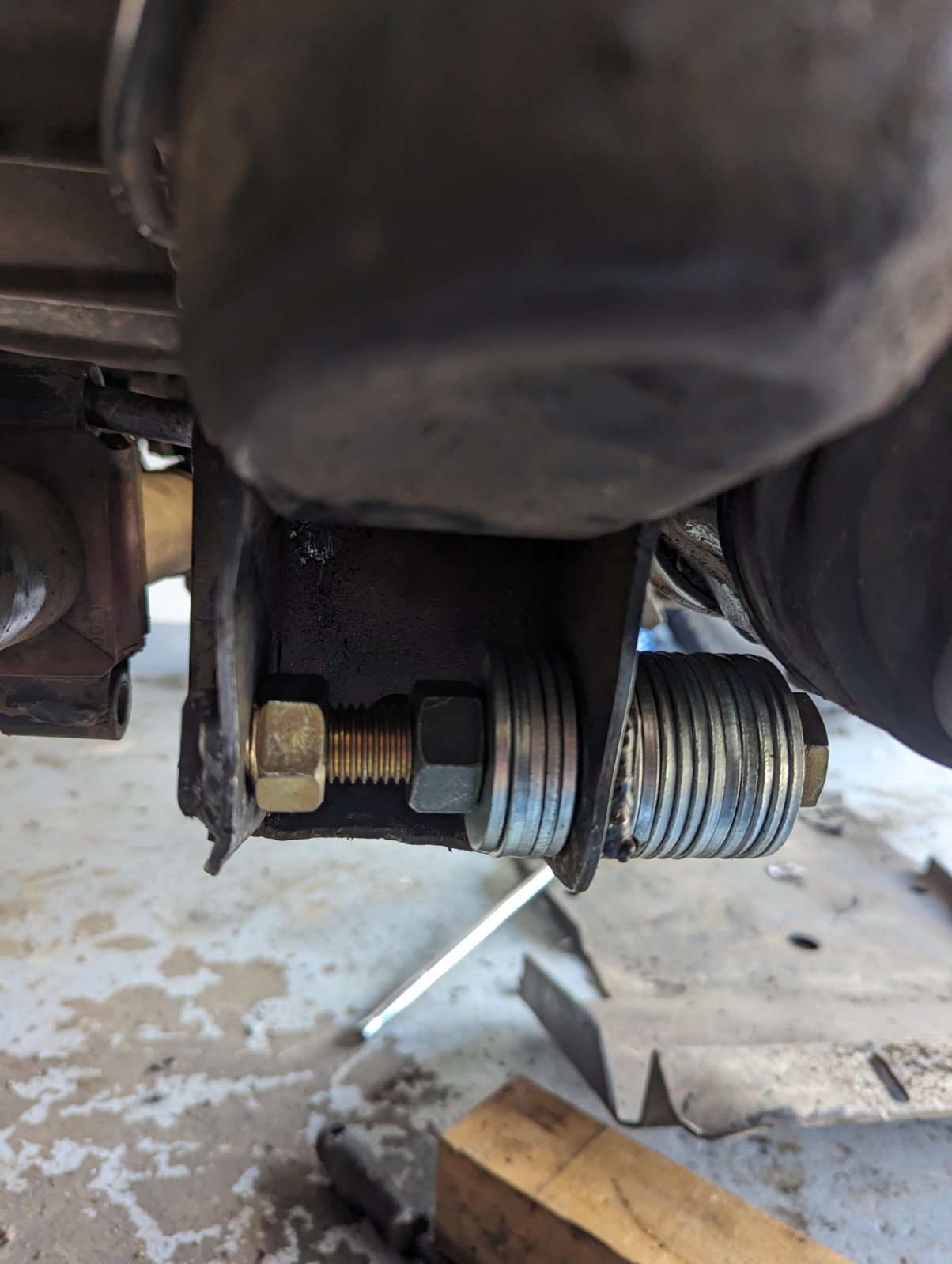

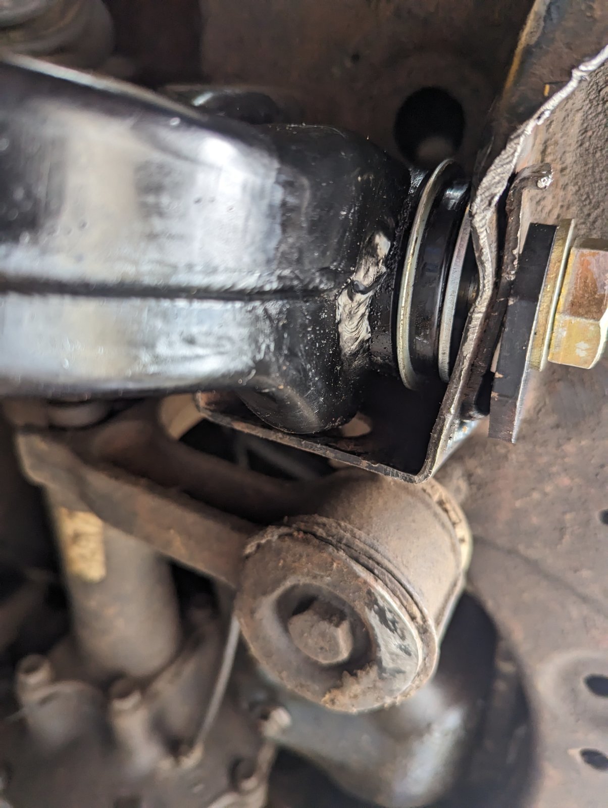

    after way too much sweat and way too many attempts I got the pass LCA back into the Tacoma. both LCA mounts are pretty trashed from the accident that happened before I bought the truck. knew it was off but didn't realize how bad lol

  9. Mar 23, 2024 at 12:52 PM

  10. Mar 23, 2024 at 12:52 PM
    Kwikvette
    Feb 27, 2019
    #284735
    82,918
    Fresno County
    4 run, 2 don't
    Ouch...was going to say mine easily went in but with an accident history, makes sense.
    How "bad" is it
  11. Mar 23, 2024 at 12:54 PM
    Wulf
    Jan 30, 2015
    #147523
    62,496
    rock raisin
    I stuck a 3/4 bolt and a bunch of washers in each and had to push both LCA mounts about 3/16"-3/8" wider to get the white lines in. even then I had to use a ratchet strap, pry bar, and BFH to get the last washer in lol

  12. Mar 23, 2024 at 12:55 PM
    Kwikvette
    Feb 27, 2019
    #284735
    82,918
    Fresno County
    4 run, 2 don't
    God damn
  13. Mar 23, 2024 at 12:56 PM
    Wulf
    Jan 30, 2015
    #147523
    62,496
    rock raisin
    they're pretty trashed and should be cut off and replaced but it'll do for another season :homer:
  14. Mar 23, 2024 at 12:58 PM
    Wulf
    Jan 30, 2015
    #147523
    62,496
    rock raisin
    "mild accident damage" - PO
  15. Mar 23, 2024 at 1:02 PM
    Wulf
    Jan 30, 2015
    #147523
    62,496
    rock raisin

  17. Mar 23, 2024 at 1:02 PM
    JKO1998
    JKO1998 Well-Known Member
    Jun 2, 2015
    #156578
    53,144
    Utah
    Cut off and sas*
  18. Mar 23, 2024 at 1:07 PM
    Wulf
    Jan 30, 2015
    #147523
    62,496
    rock raisin
    exactly
